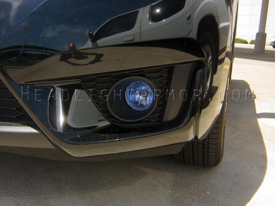

When we were taking measurements for the 2015 Fit the dealer demo out front had a cracked lens...
Comes in clear and some other flavors as well. HID Blue - Shines white for example:
More info and photos of other years in our vendor thread here
