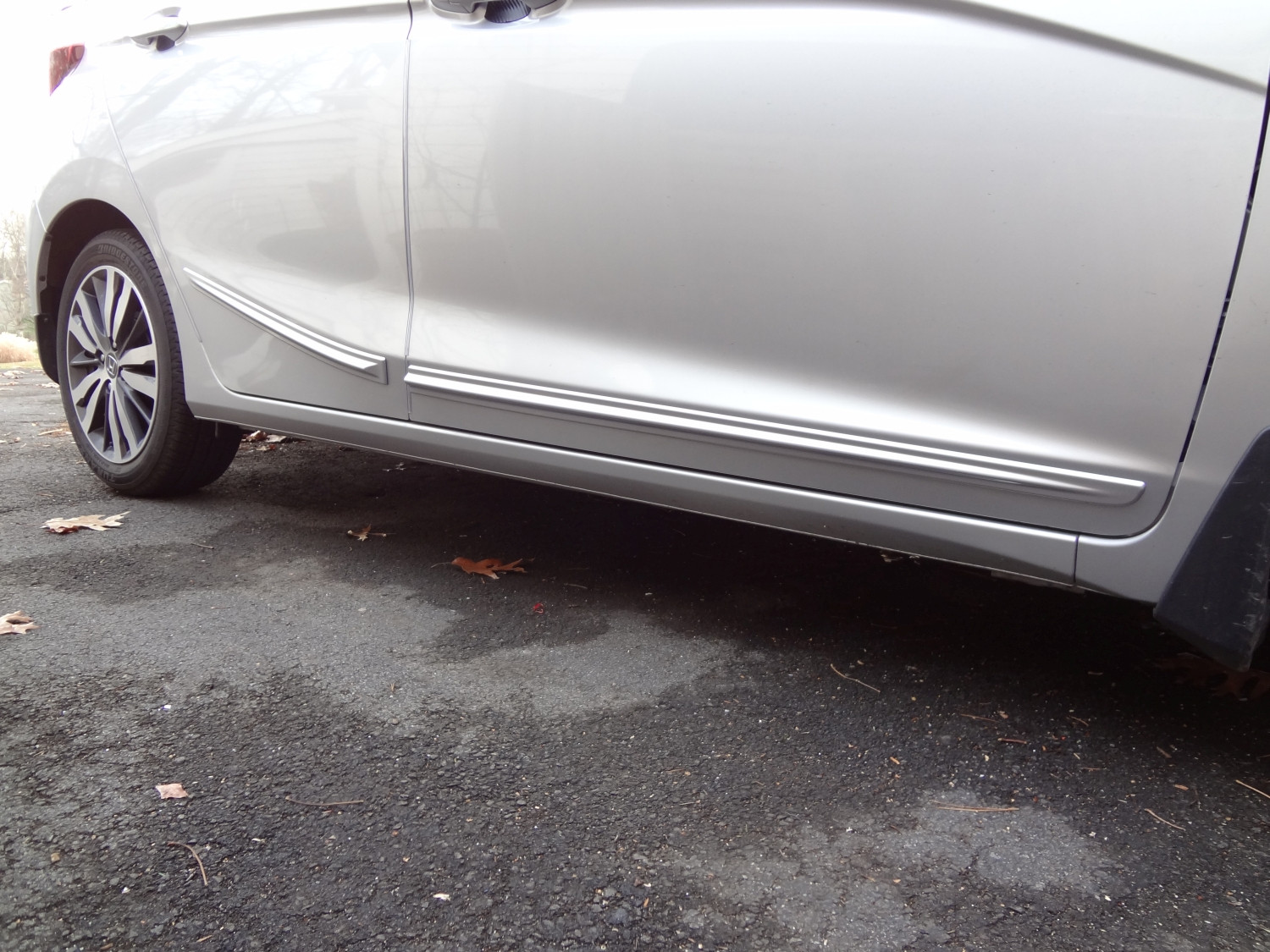

What a coincidence! I just came in from putting them on my car. The toughest part of the job was removing that red backing tape on the adhesive. I slit it with a blade, and it was much easier to start.
The temperature was in the 60's today, and probably tomorrow, too, but it will be raining. I'll put them on my son's car tomorrow. His car is in a parking lot all day.

Is that a door edge guard I see? (solid plastic or clear film version)? Did you use masking tape to tape the templates on? Did it stick ok? They look good.....I like them. exl500 told me once he thought they looked worse than the dings they were designed to prevent, would. I still laugh about that statement.

The door edge guards are the same type they have been selling for fifty years - plastic with an adhesive inside.
The templates line up with the bottom edge of the doors, and a little flap folds into the door joint. The top of the template is the bottom of the molding. Very easy. I put masking tape of over the rectangular holes and stuck the templates onto the doors. Easy!

I thought the edge guards looked like the plastic ones (color matched). I noticed now they also sell a clear thin piece that is installed much like paint protection is. It is also good to know the masking tape will hold in colder climates, at least long enough to get the guards installed. I assume you used rubbing alcohol to prep the surface. I think they included two alcohol wipes with my order, but I can't find them now. I guess I will use cotton balls instead. I think they look great! I can't wait to get ours installed. I need to get them on before my daughter parks next to the wrong person! In a college town, people are not very concerned with their parking abilities.

Good thing about opinions then... I suspect exl500 was referring to the fact that those moldings won't stop any door dings from any normal car striking the door of the Fit
Most cars, including other Fits… The door will strike well above what does moldings attach...stray shopping carts would strike above that zone too.
So, what exactly does the bodyside molding protect against? Inquiring minds want to know.

Well, I can only speak to our own cars. When we first received these, and were still within the return period, we taped them on the side's of our Fit with masking tape, then pulled both our Honda Odyssey and Mazda CX-5 up alongside. In each case, the moldings prevented the other cars doors from hitting the Fit anywhere but the moldings themselves.
So I guess we are back to your opinion on opinions. I do have doubts they would stop a shopping cart, but I will test that once we permanently install then this week, when my daughter returns from school (weather permitting).
And for exl500, I'm pretty sure he said that because he thinks they are ugly. Myself, I think they bring out the folds already in the Fit door, and I like them.

Yes, the door edge guards are clear, so they work with any color car. The cut easily and will outlast the car. I've been using them for years. I even put a strip on the bottom edge of the hatch. My only concern with that is having moisture accumulate there and causing rust. I don't think they will let water in, though. I'm keeping an eye on that area.

These are 2" wide strips, not body armor. They are at the widest point on the car doors, so it is most likely that another door will strike there. A Fit owner posted a picture of a ding in the molding, but not in the door. The molding worked.

Another thing people don't take into consideration, is just how thick these are. Not only are they on the outer most point on the side of the car, they extend that point considerably with their thickness.
