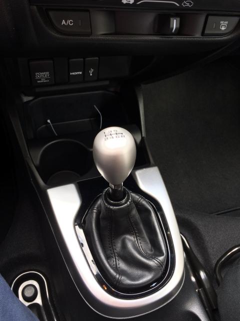

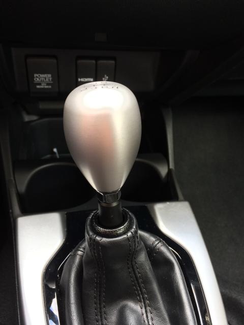

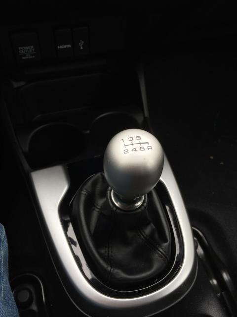

I bought that off ebay, here are the installed pics.

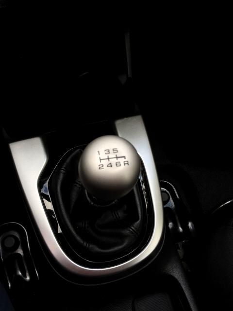

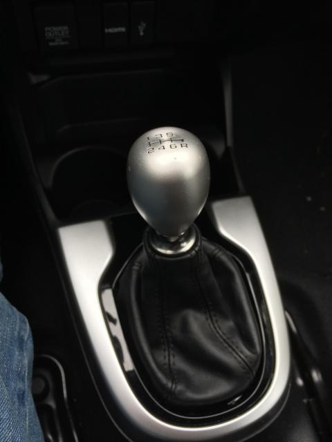

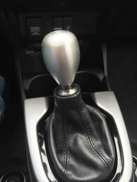

Now that was my first setup, the shift knob is a oem rsx type s. Well the knob was used because i wanted to make sure i liked it first. So when i bought a new one it came with a plastic boot ring, and plastic spacer for the shift lever. Here are the installed pics of that.

Which setup did you end up going with? Your first pictures with the boot being flush with the bottom of the knob look awesome. The second setup with the exposed shift shaft looks more like something I would see in an older Italian car (nothing wrong with that).
Just curious if there was anything wrong with the initial setup? If it's basically plug and play, I'm jumping on that bandwagon right away. I'm fine taking the console out and doing that type of work. With only 1000 miles on the ODO I'm trying to not cut or modify in ways I can't return to stock. I've been down that dirty road in the past and don't want to repeat for a few years.

The shaft isn’t exposed on the second setup, thats a plastic cover that slides over the shift lever and clips into the boot ring. I like the idea of the first setup but the color of the boot ring was too far off of the shift knob. Plus the second setup allows more room to grip the shift knob for me. I’m sure it will change many times over the life of the car.
