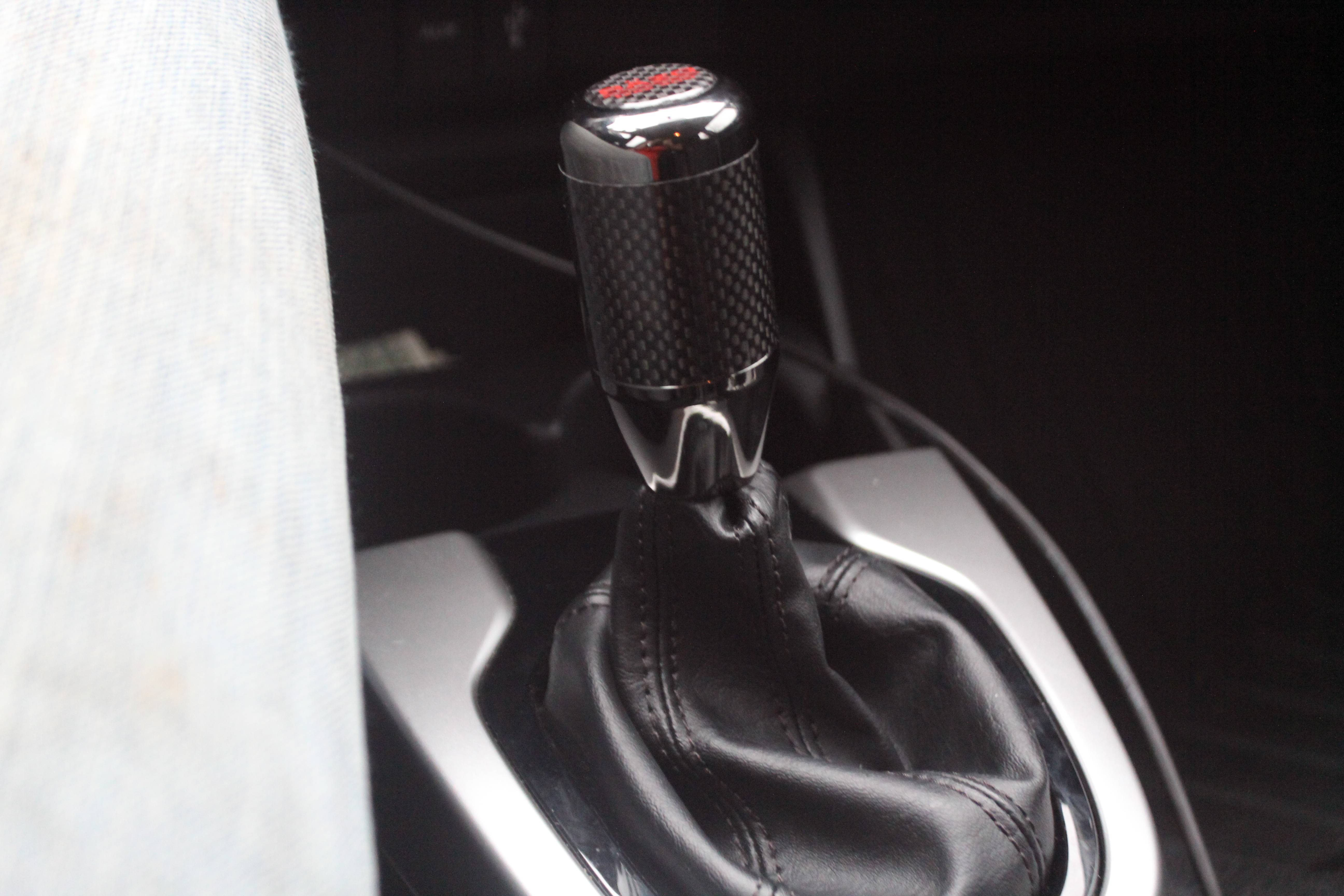

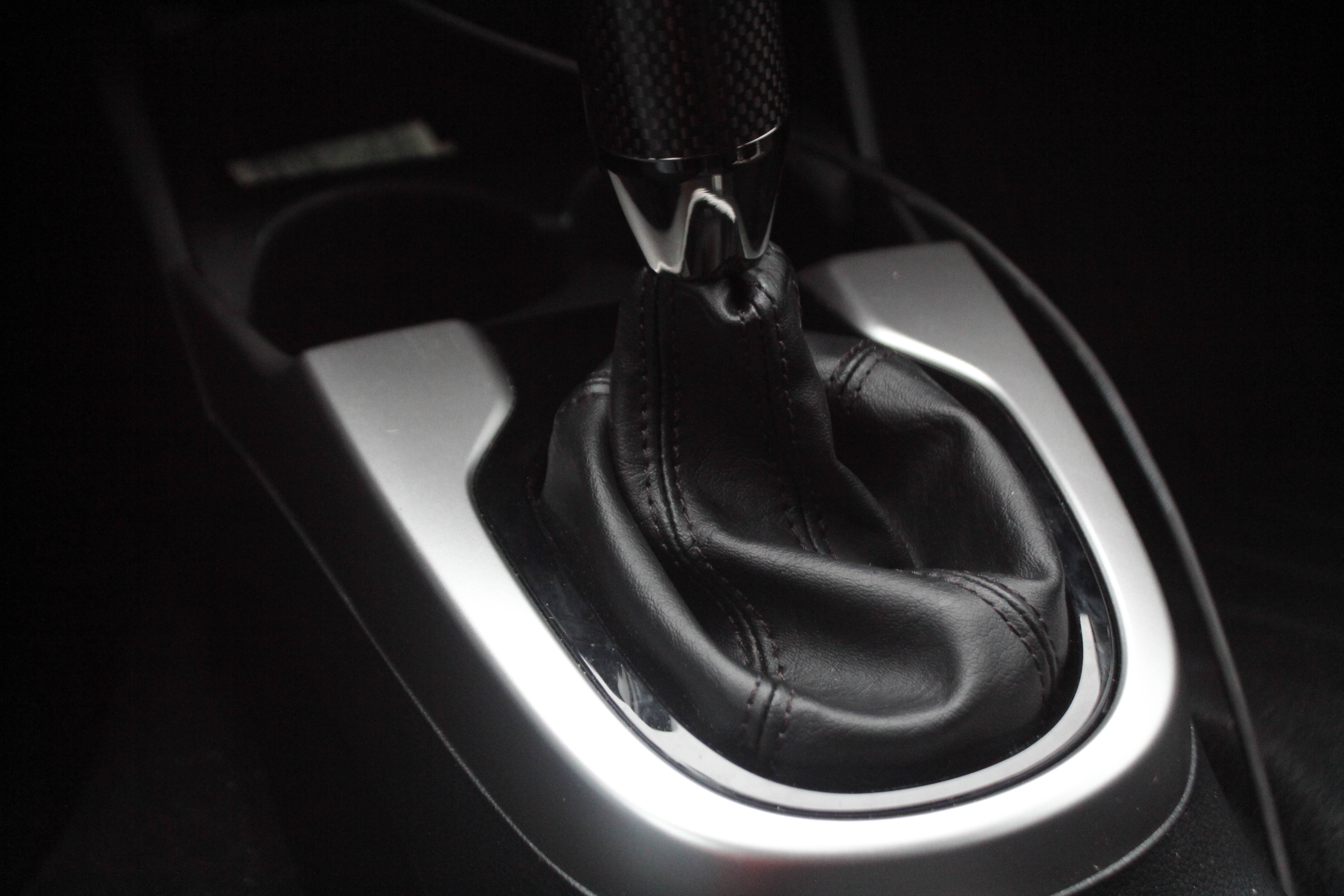

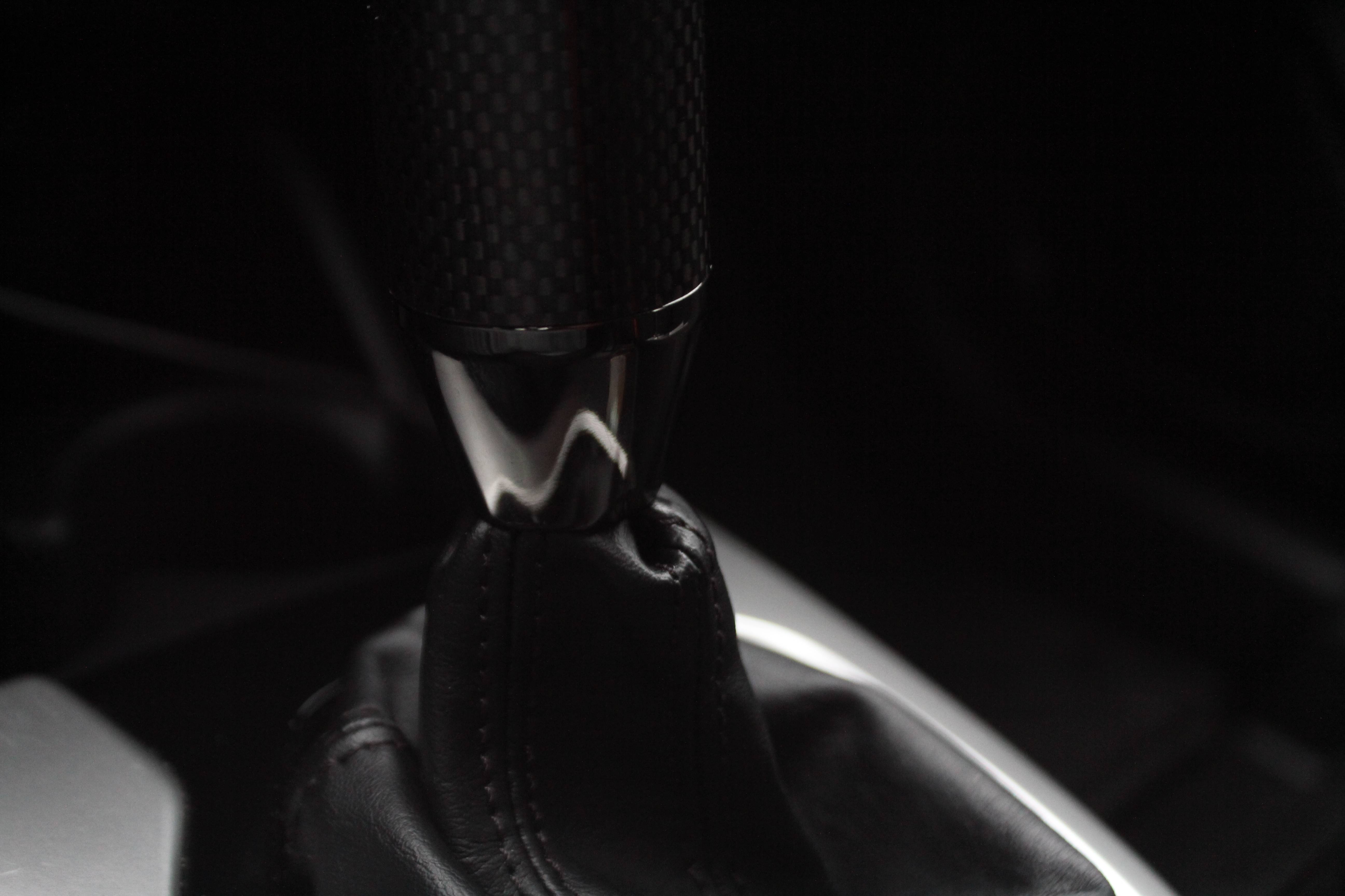

So here it is, the fruits of my labor:

The knob is a
Razo ra66 Razo ra66
With the longest spacer in the knob, the bottom of it sat conveniently directly above the two flats that come out of the sides of the shifter itself. I just zip-tied the boot to the area between the knob and the flats and it's really secure even without a trim ring, it's not going anywhere. I'm not nuts about the look of the leather bunched up at the bottom of the knob like that instead of a trim ring, but it works well enough, so I think I'm going to leave it alone.
As for the shifter, the difference is night and day. The old one made the car feel like you are driving a toy. This thing has real weight to it, and shifting feels effortless now. It feels like you just give it a slight nudge in the direction you want it to go and it just falls right into gear compared to the old one. I also feel way less vibration through the knob than with the stock one. For $50 bucks, I think this was a great upgrade.
