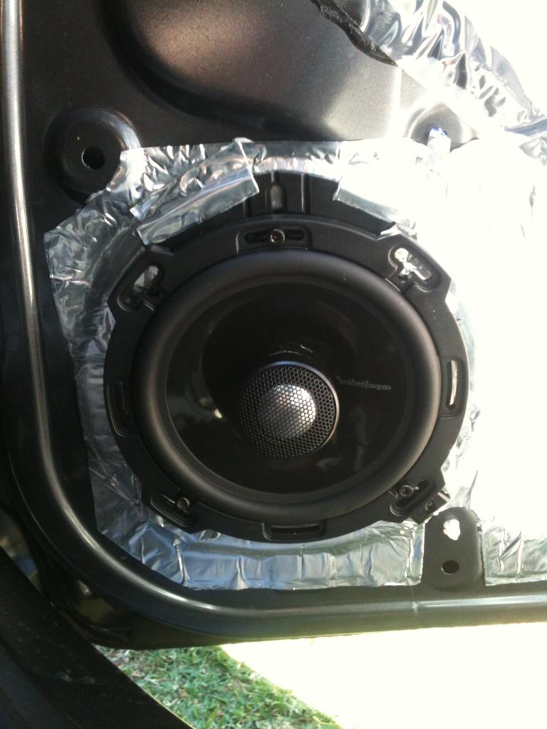

I didn't get any pic's of doing the back doors as was just focused on the task but took some pics of doing the front until I ran out of material. I will take more when I get more of it.

On the back doors, I was able to cover most of the inside of the skin. I have used it on the speaker mounts to both ensure a good seal and help to increase the height of the speakers even if it is only 1mm.
I have found that a few well placed bulldog clips will help hold the plastic sheet on the inside up and out of the way.
