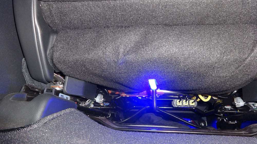

These interior footwell lights go on and off with the dome light and do not stay on after the dome light goes off so these are not considered 'ambient' lights that are on while driving.

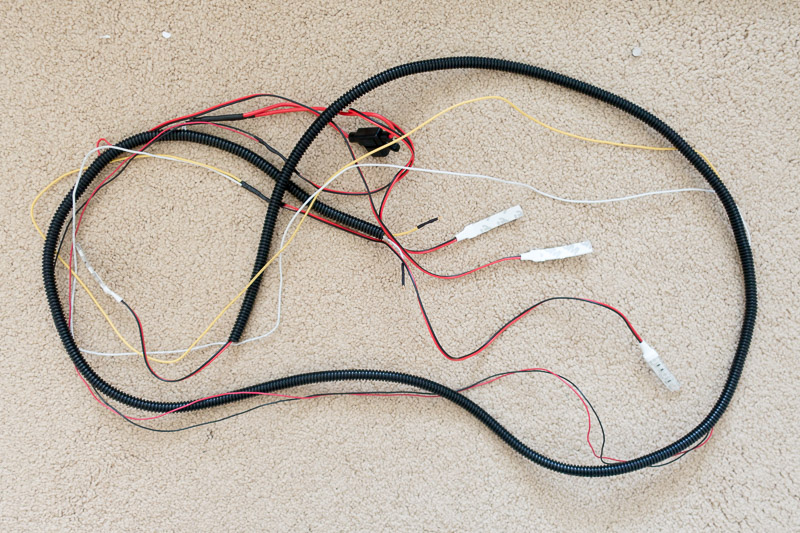

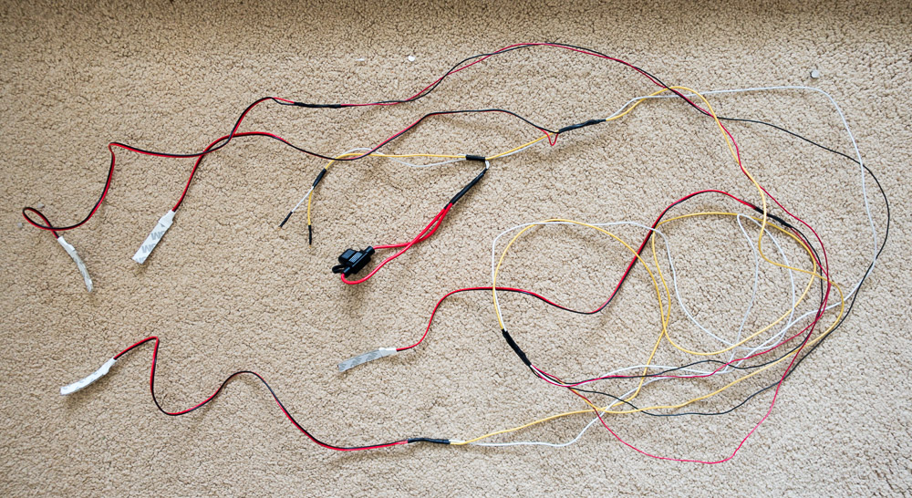

The camera really brings out the blue color, they are not actually quite that bright. Took several hours to make the harness using shrink wrap and several more to install and route along the central console.
I used more of the flex tubing under the front seats (not shown) during final installation.

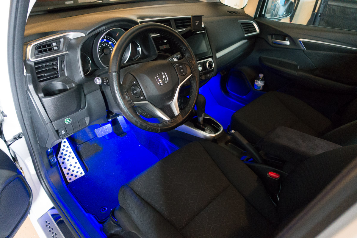

I'm very pleased with the final result and this should make it easier to locate items on the floor in the dark when getting in and out of the vehicle. And of course there is the 'cool' factor.

Great job! I like the idea of the lights only coming on with the dome light.

Any suggestions for how to mount the ones under the front seat, I felt around and it feels like a large cloth cover... Curious how yours are attached? Thanks!

Simple, Velcro. The under seat fabric material is the 'Vel', and I put the 'Cro' on the light assembly where the 3M sticky tape was.
I used zip ties to hold the LED wire up to the existing wires in the front of the seat to keep it steady when the seat moves back and forth. The wires are all inside 1/4" convoluted tubing so it looks or at least matches the OEM wiring harnesses.

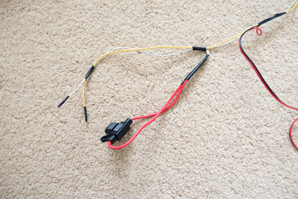

tbFit, very interested in doing this project but not very electrically savy. Did you splice all the LED leads together before the fuse and then the fuse to the box? Did you use a terminal fork for the connection to the box? Any help would be greatly appreciated!
Old Oct 6, 2015 | 04:31 PM
tbFit's Avatar
Joined: Dec 2014
Posts: 647
Yes, LED leads all spliced, soldered and shrink wrapped. Inline fuse between the lights and the fuse box.
I used 2 RS232 female serial cable crimp pins on the 2 leads and pushed them on to the terminals in the fuse box.
Couple more images of the harness I took back in February:

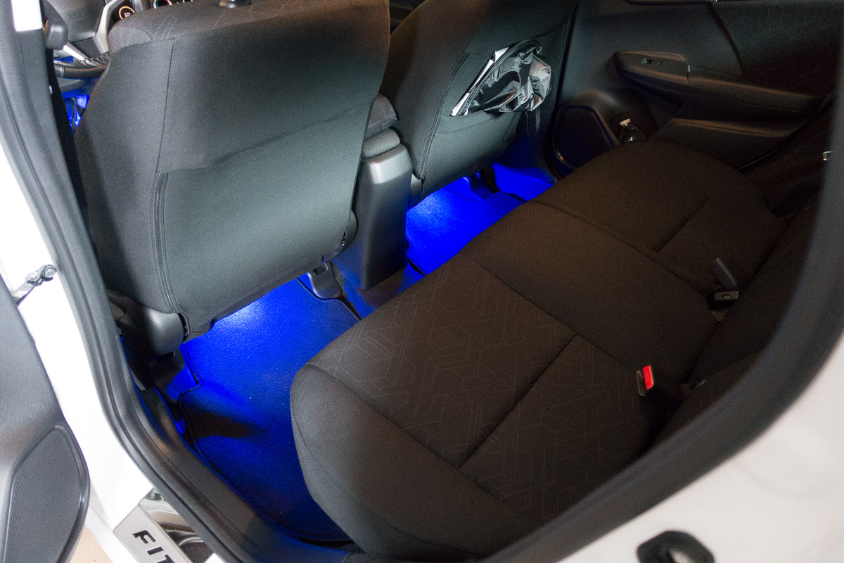

could you take a picture of the rear foot well? I'm curious to see how you mounted them. I wont be putting it in min as I got under seat subs going in. Yours look great btw! i also got the sills connected to the lights the same way!

Thanks... Older pic here:
They are velcro'd to the bottom of the seat as mentioned in an ealier post. The bottom of the seat is acting as one half the velcro, so it just sticks there. The cable leading to that is zip tied to the bottom of the front of the seat and enclosed in tubing.
Fresh pic here:
I love these lights as you can see pretty well even with the dome lights off at night.

Awesome! Thanks for the help! Looks like the fuse is only through the negative? Correct?
Old Oct 6, 2015 | 07:27 PM
tbFit's Avatar
Joined: Dec 2014
Posts: 647
Based on the photo posted earlier with the terminals designated positive and negative, I hooked the white wire to positive and that is wire I have the fuse on. Although I'm not sure it matters.
It does matter. Being a negative ground system its established practice to fuse the anode positive. If you only fused the negative, all that positive wire needs to do is touch the chassis to complete the circuit and potentially short out. Fusing the positive prevents murphys law and elimates any path back to the battery that could short to the frame.
Good point on that, thanks!
