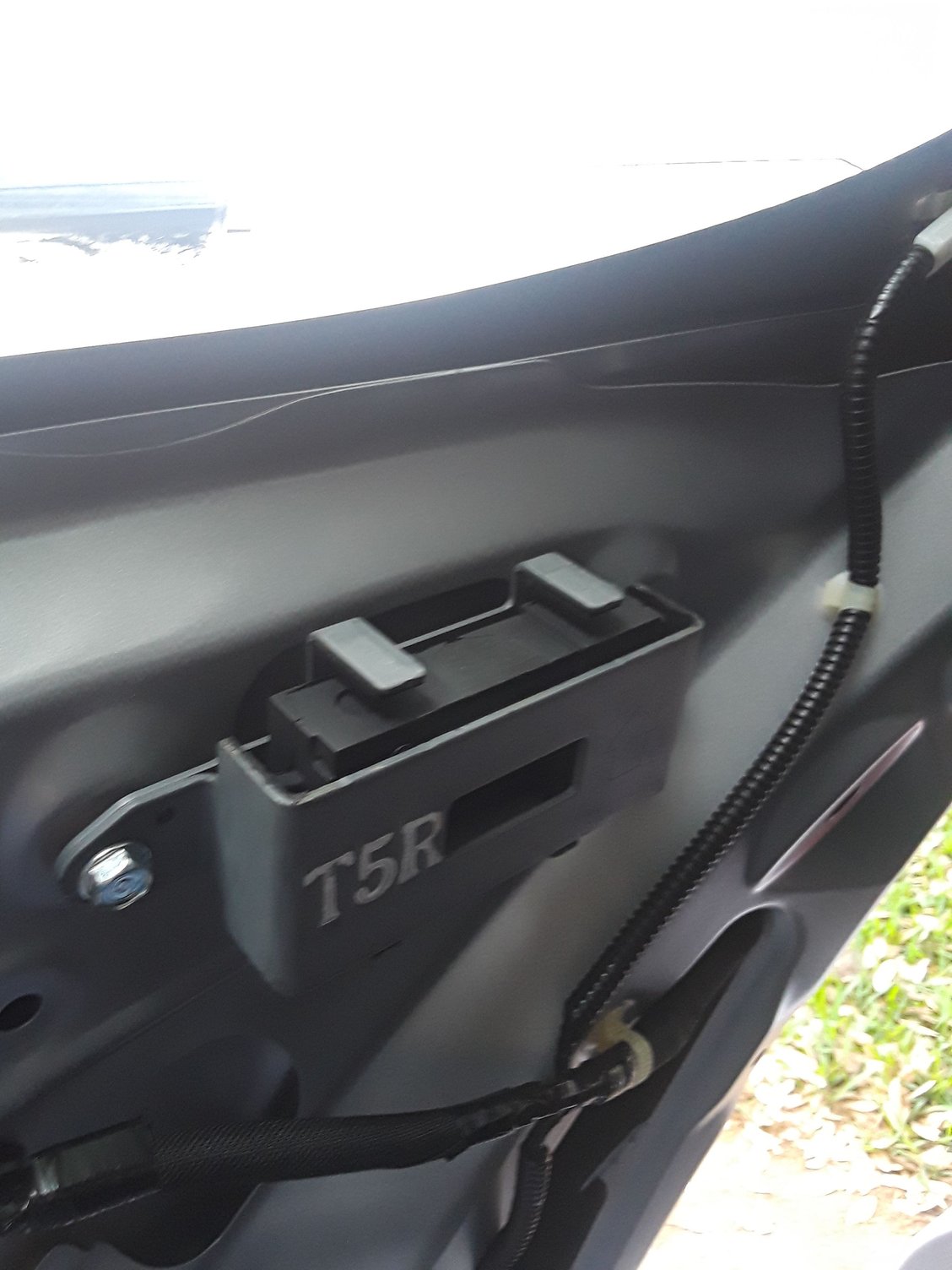

H
​​​​​took the panel off the hatch and I think this box is making the noise. Anyone know what it is? It's not connected to wires.

Ok, so thought it was the box under the paneling on the hatch door, but was able to replicate the sound by pressing on one of the plastic wire coverings under the paneling. I'm not sure how it makes the sound on it's own.

Good detective work, nicely done!
So the question remains, is the clicking mechanical or electrical in nature? Mechanical would be rubbing or friction of various components, whereas electrical would be a relay that doesn't shut off etc.
If your car is under warranty, I'd let Honda do the rest of the work. Let them know that you have a clicking sound that continues after the engine is shut off, and you've localized the sound to the location you describe. The sound file on your phone should be an added help as far as determining cause.

I think you've done the hard work of finding the area that's making the noise. I'd try to see if you could tape the section down or maybe put some insulation so it doesn't move around and see if that stops the noise.
