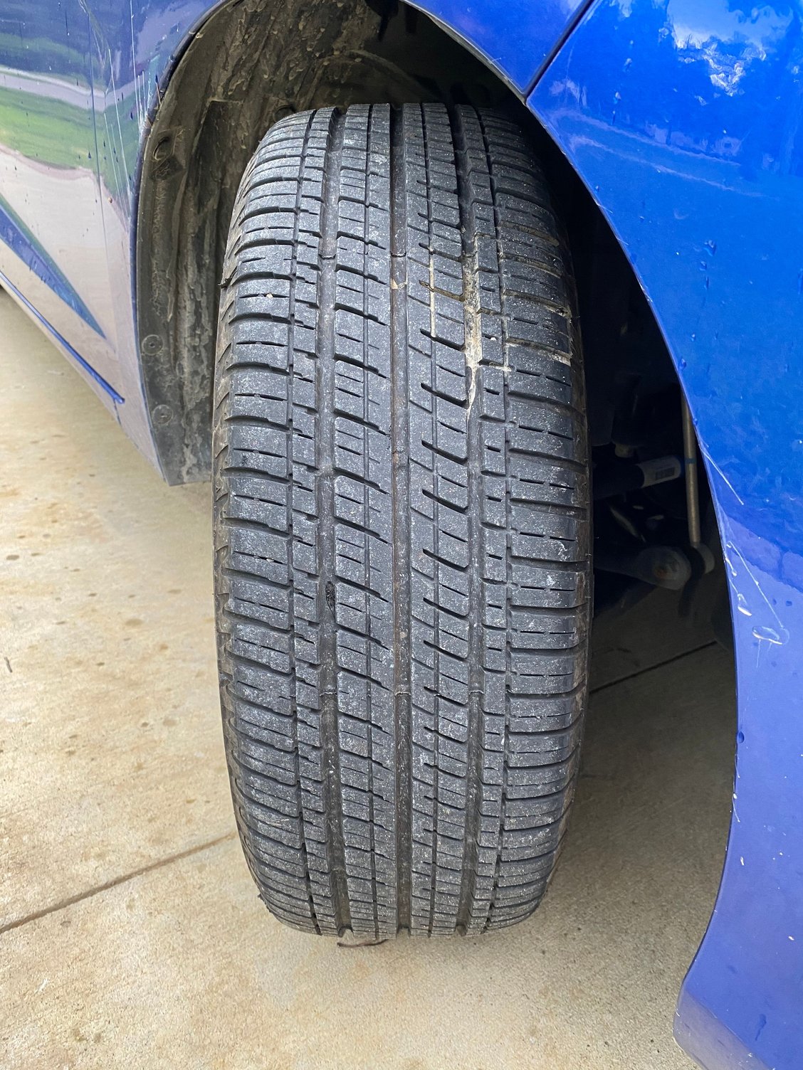

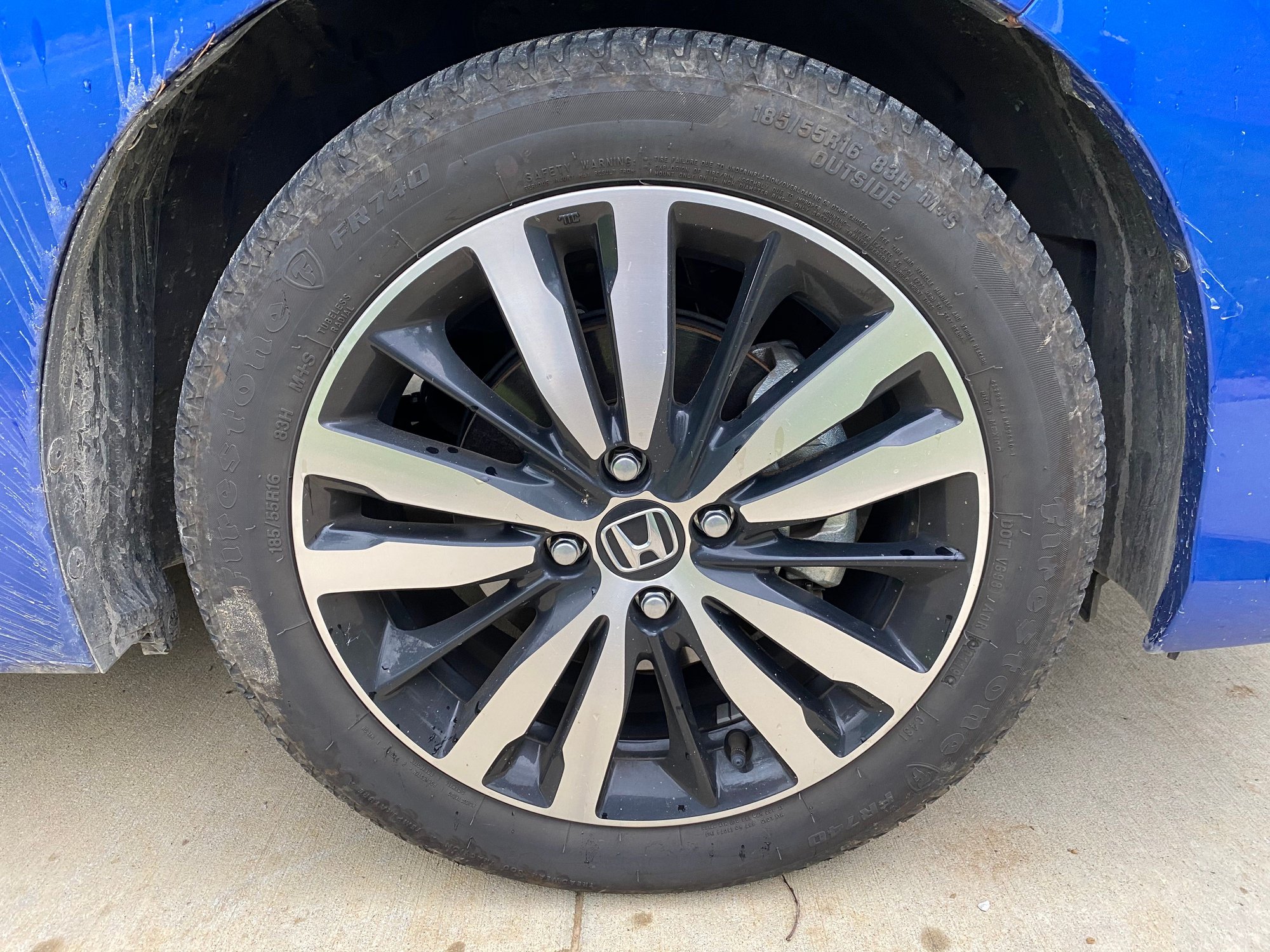

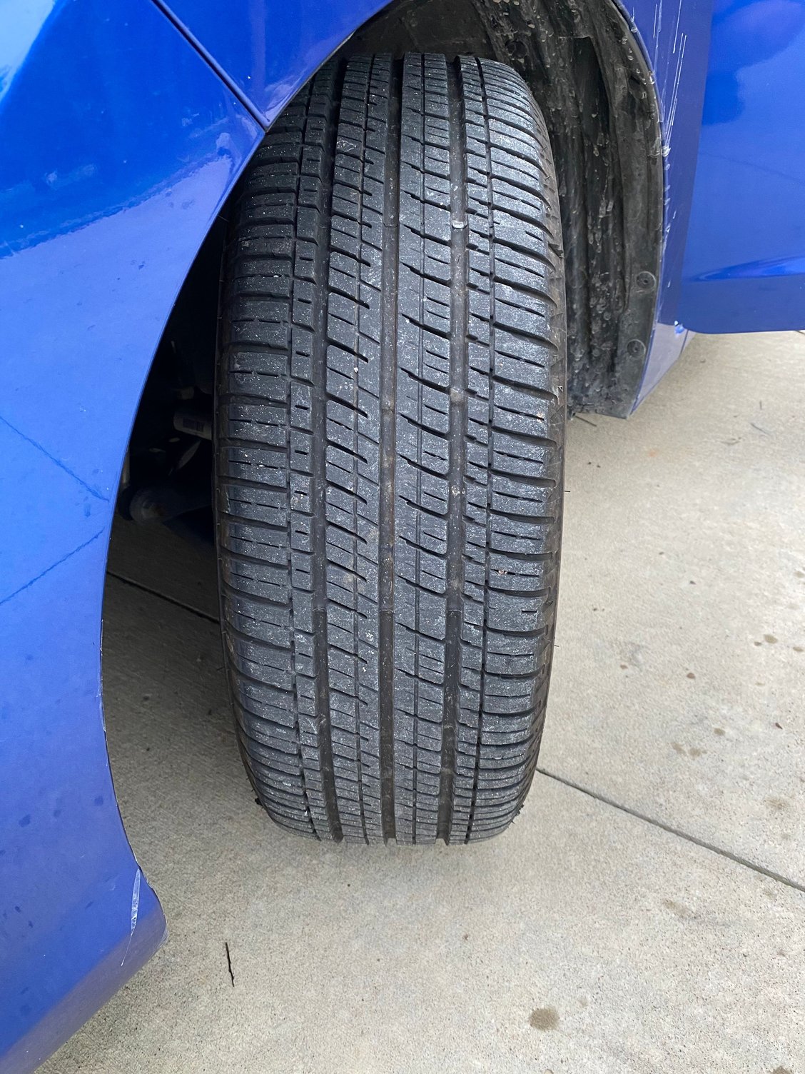

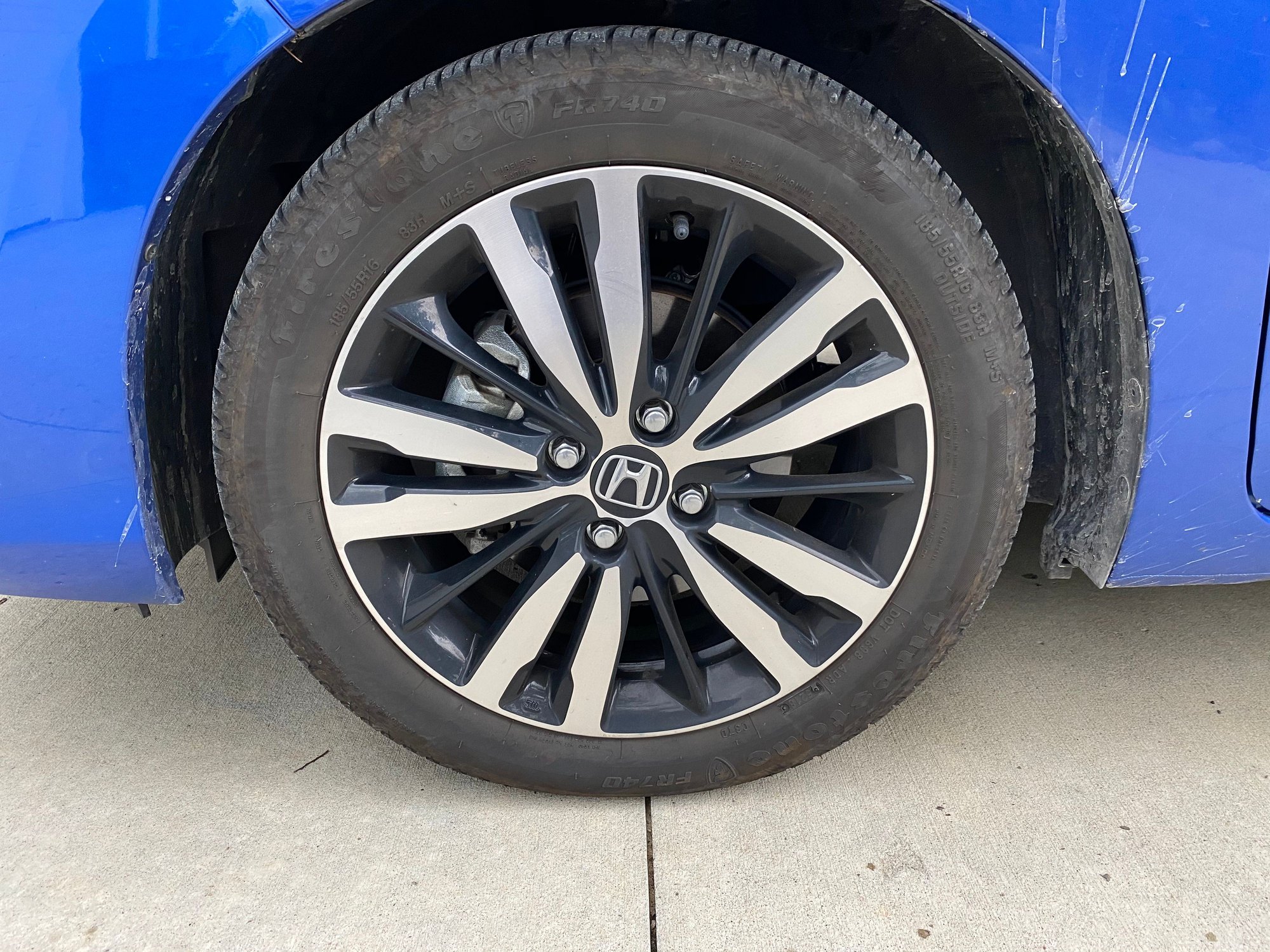

Front Tires
Just popped out and took a couple pics. They are stock tires. I don't think there's any unusual wear.. but I'm no expert. Honda said they looked good and they didn't rotate them.. Been making sure pressure is right.
Front Left
Front Left
Front Right
Front Right

These are the stock tires.. I don't think there's any unusual wear, but I'm no expert. Honda said they were in good shape, but I'm not sure how detailed they got. They didn't rotate them. I've been making sure pressure is good.
Front Left
Front Left
Front Right
Front Right
