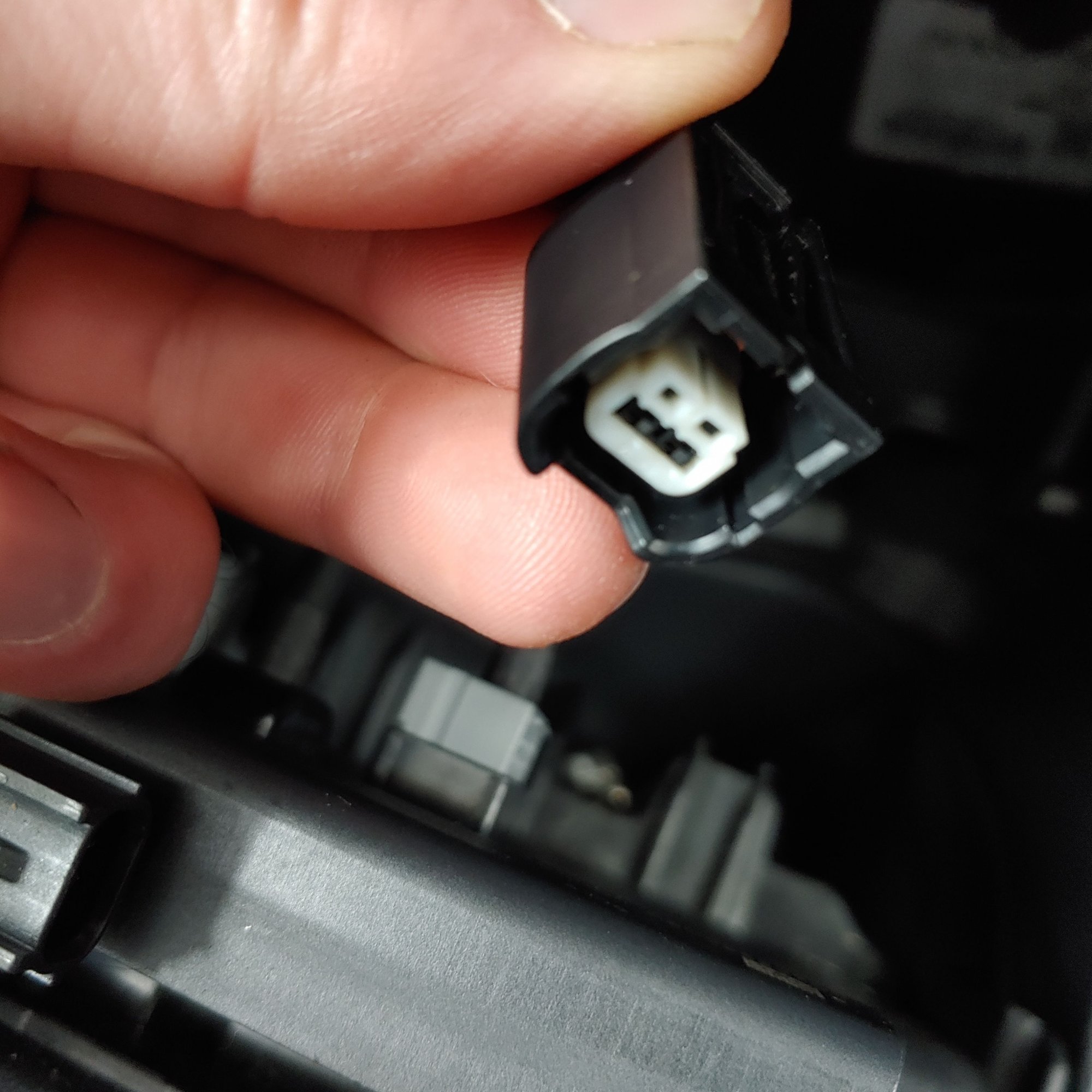

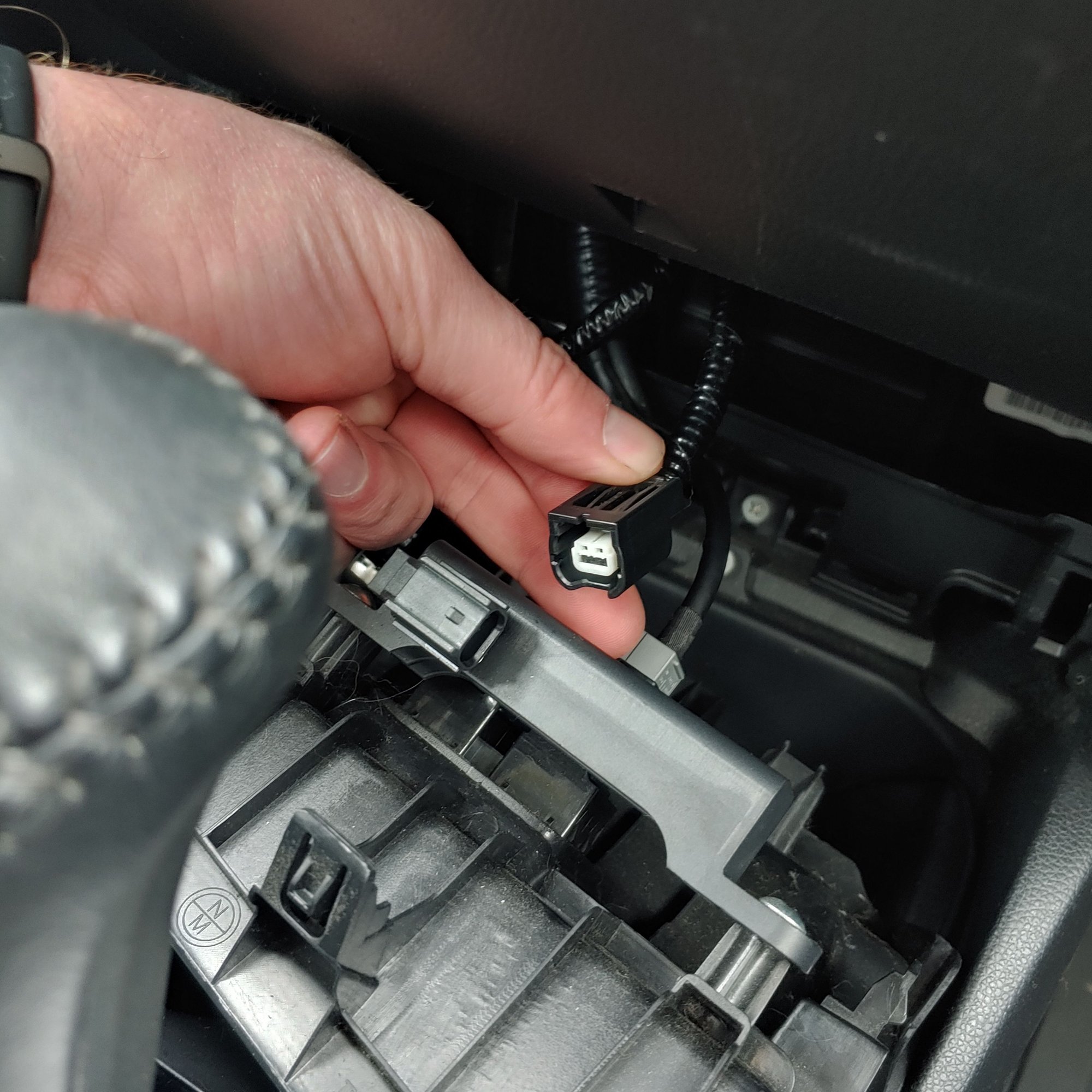

3. Lastly, wtf is this wire?? I never unhooked it, intentionally. Now I'm wondering if it came off accidentally and is the cause for my fob not communicating...or if it's there for some option my card doesn't have installed (like gps)?
Bigger picture of location
Close up of connector

Nevermind... I'm an idiot. You can even see *where* that wire connects to, in one of the pictures. It clips into the back of the panel that houses the USB/HDMI, near the top, parallel to the face. And whatever it was disconnected from was apparently what was causing the issue. That must be where the transmitter for the fob lives. When I opened the panel, and reconnected that wire, everything suddenly worked perfectly! AND the smart entry light no longer comes on. So, I guess taking the stop/start button out, cleaning the little contacts, and replacing.it worked. Although, it didn't really seem like the thing needed cleaning. So, I'm not 100% sure what the issue was. But my car works fine. 🤷‍♂️

I just wanted to thank you for this post! I installed a shift boot collar today and when I was done the keyless start wasn't working. I tried jumping the car, replacing the fob battery, and was about to go to the dealership but I figured I would take a night and dig through the forum. Luckily I found this post and it solved my issue so thank you!
