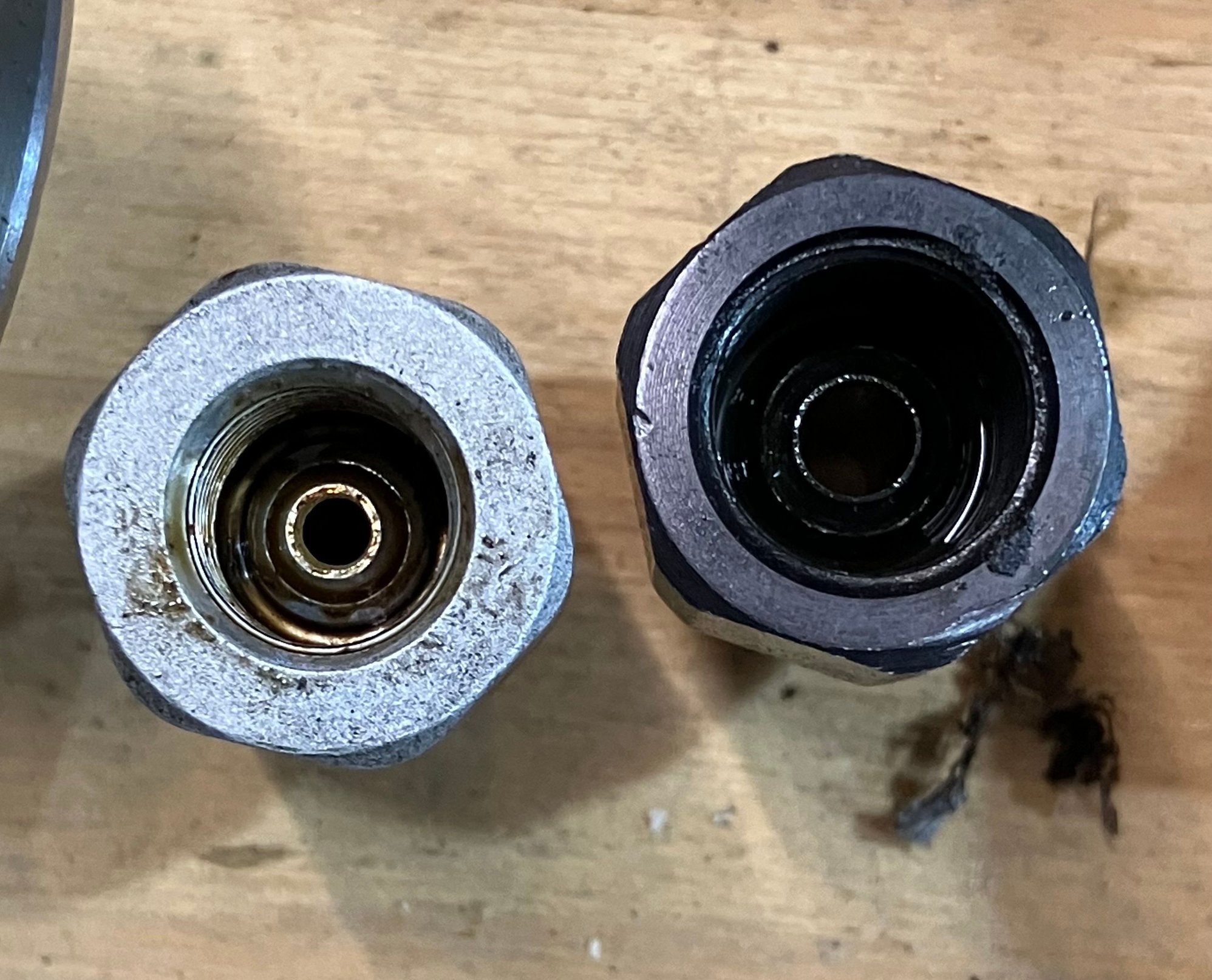

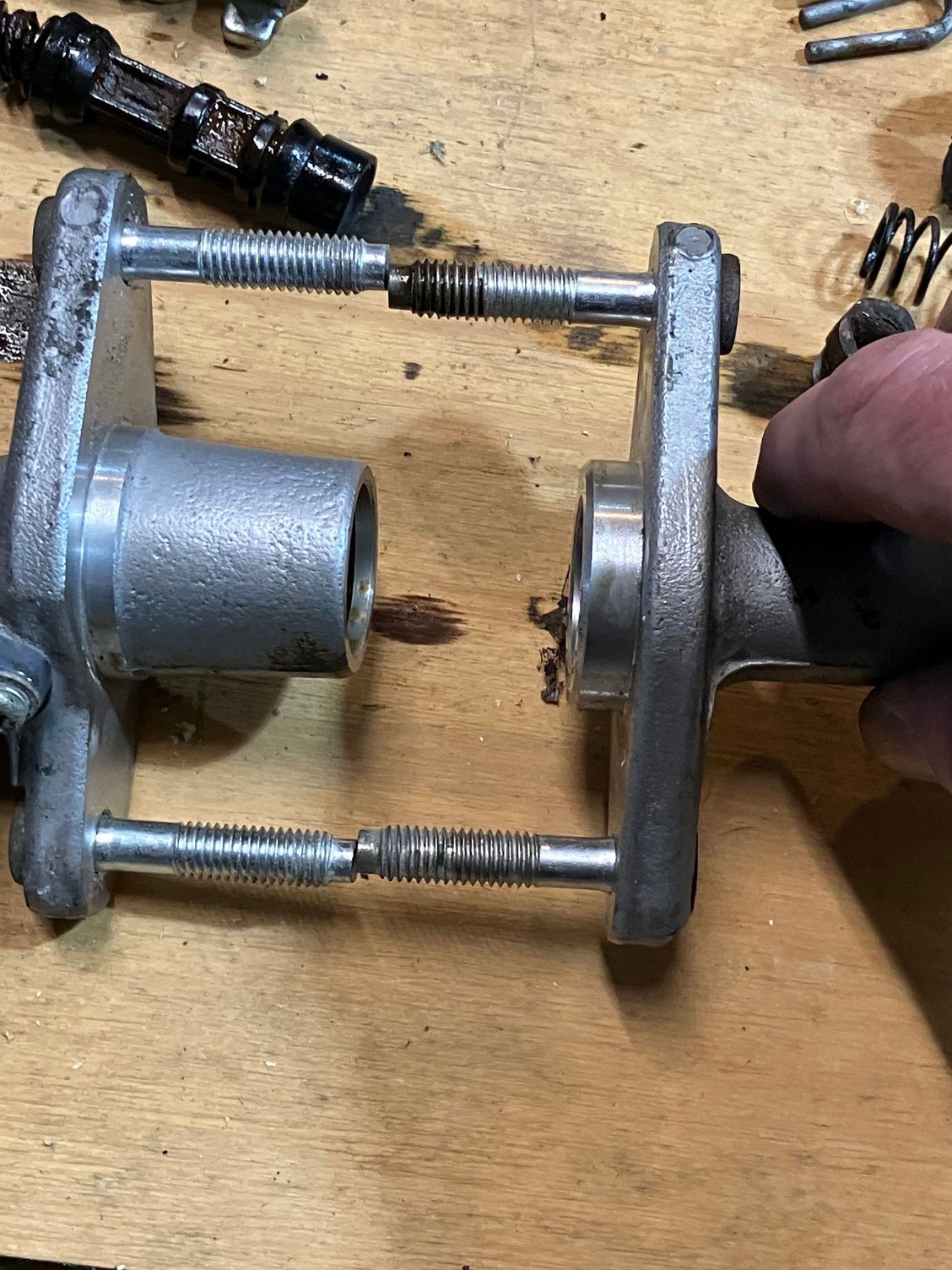

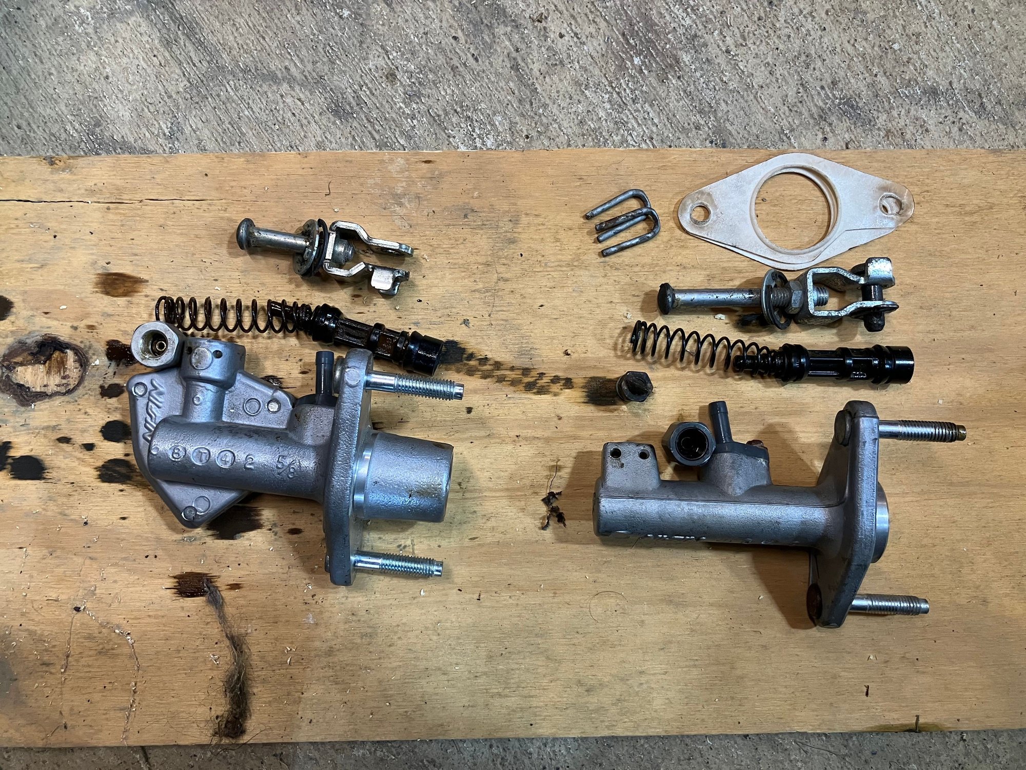

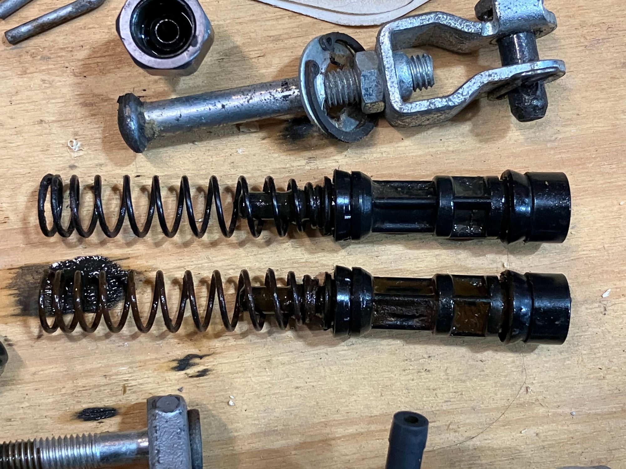

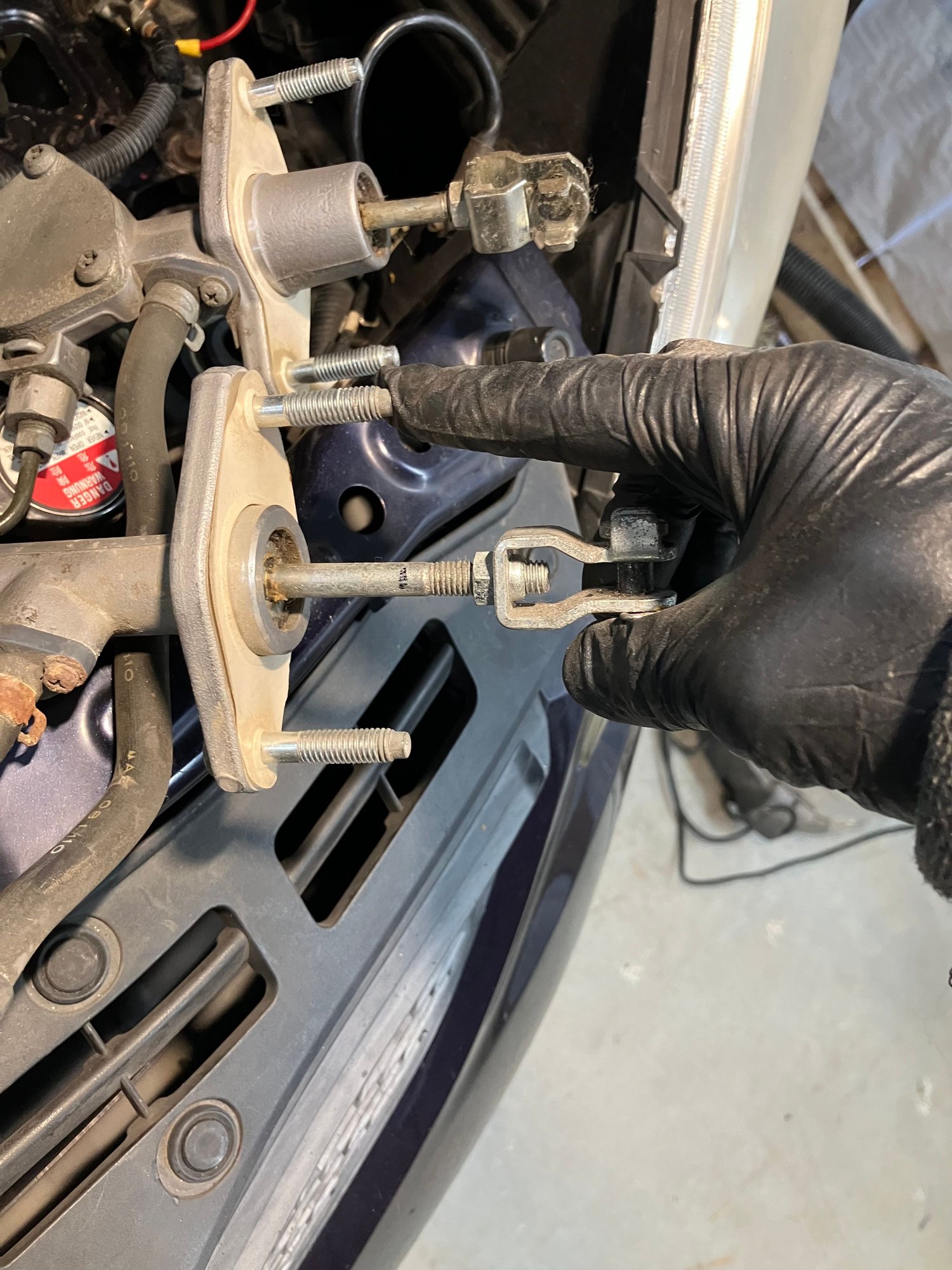

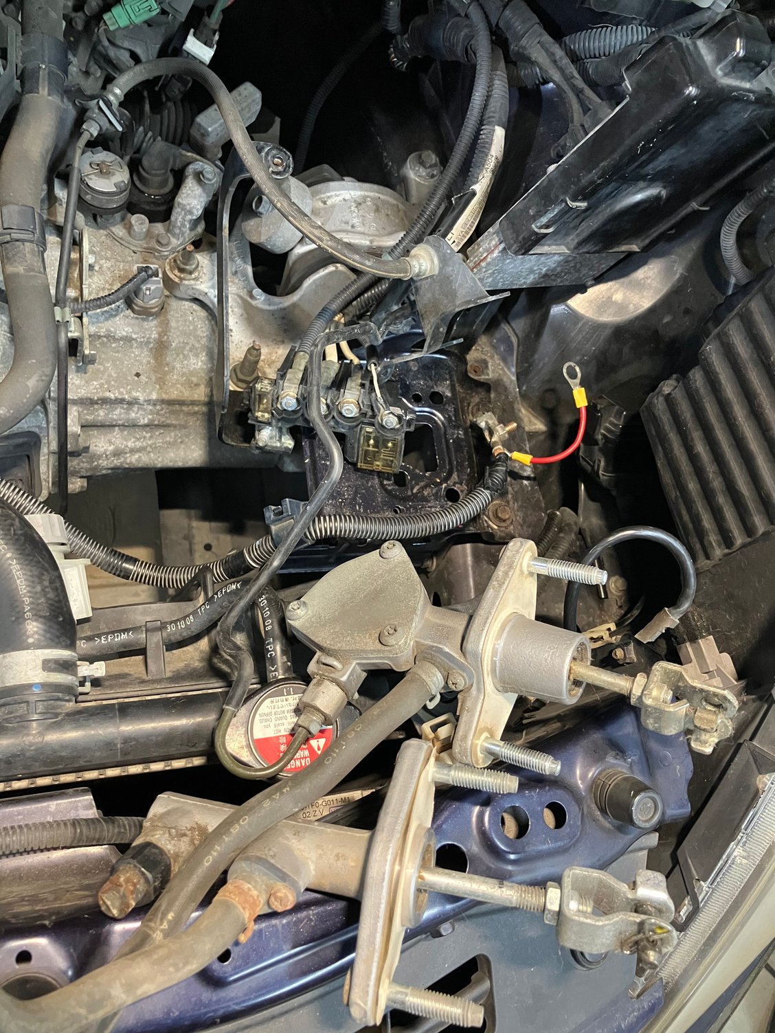

CDV delete
I’m in the process of removing the clutch delay valve from my 2009 Fit (GE8). On the 2009 the CDV is on the master cylinder. I bought a clutch master cylinder for the 2007 Fit (GD3) which does not have a CDV on the master cylinder. The master cylinders are similar enough that I only had to attach the reservoir and hose from the 2009 to the 2007. I also had to switch the hard fittings because the 2007 has a larger diameter. Please see attached pics.
Mounting bolts are 1/8” farther apart on the 2007 clutch MC.
I’ll adjust the 2007 clutch pedal attachment so that I won’t have to adjust anything with the new master cylinder.
Old Jan 27, 2023 | 06:28 PM
dave brown's Avatar
Posts: 124
From: Maryland
If you do a clutch MC switch, pull everything out at once to save yourself a mess. I unbolted the clutch MC, the reservoir and the hard mount for the MC hardline. The last thing I did was disconnect the MC from the hardline after making sure the reservoir was below hardline so no fluid spilled.
