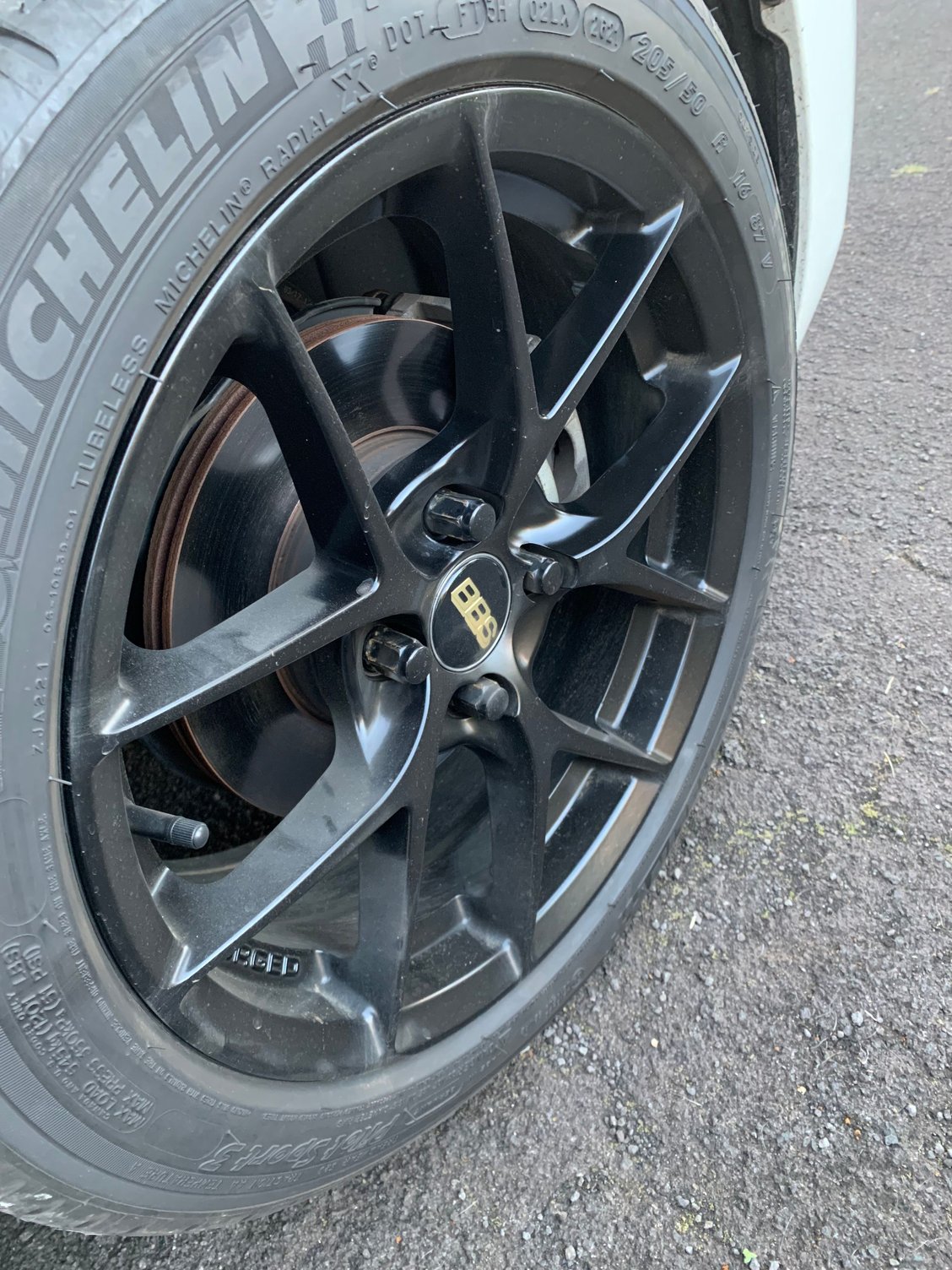

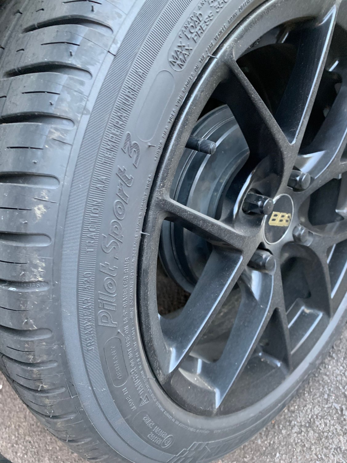

Change Done ;) Michelin Pilot Sport 3 205/50r16

Nice, I'm sure those will be great.
