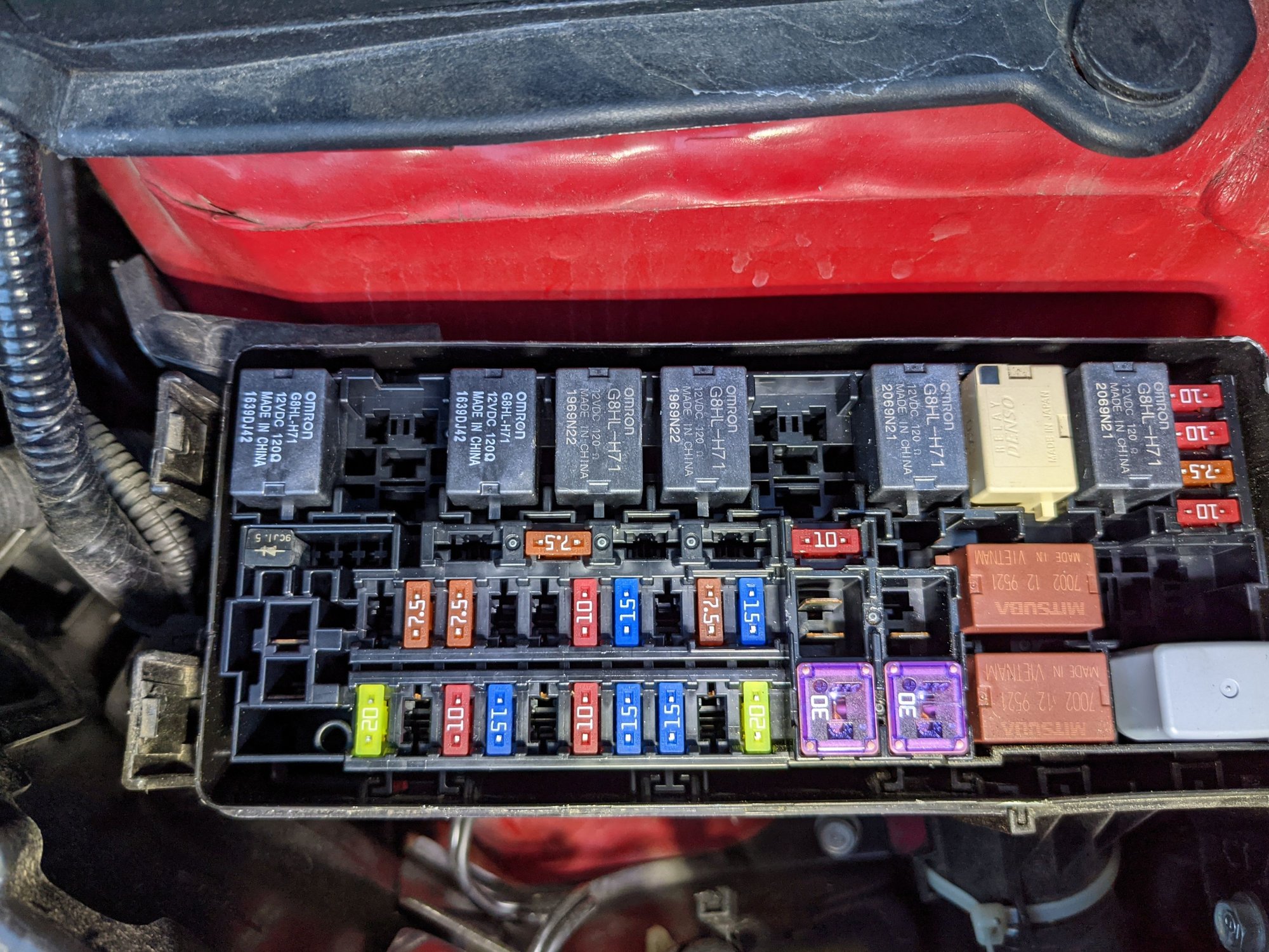

Throttle actuator codes
Try swapping relays around in the underhood fuse box G8HL-H71 relays, there are six of them that are identical, one of them is the ETCS control relay, two of them control fans, and one of them the third counting from the left will immediately kill a running engine and throw codes. I am unable to find a relay diagram and have found much out by trial and error while working on cooling issues that involve some of these relays.
All the black relays are interchangeable

I’ve always had a mouse problem with the fit, so I’d guess rodents too. Every winter and spring I trap at least 5-10 mice inside the car. None of my other cars have this problem. The thing is, I can’t find anywhere they’ve eaten wiring. A lot of the harness is visible with the air box, throttle body, and battery removed. I’ll check the relays, that’s one thing I haven’t yet looked at.
