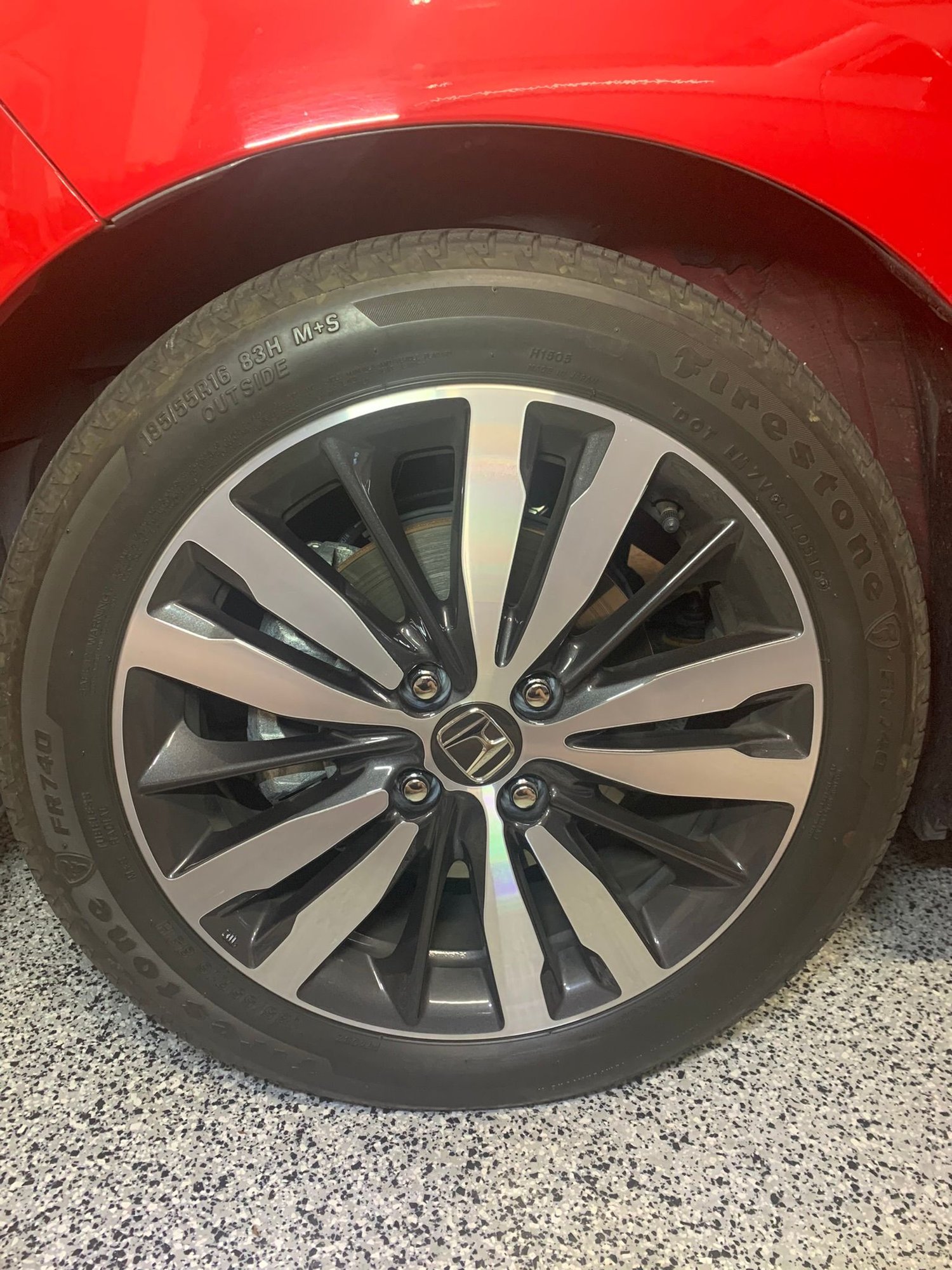

But, just to satisfy my curiosity, where is the “arrow sign” on the sidewall exactly? Below is a pic of my OEM Firestone. I don’t see the arrow. Without it, is it possible I have directional tires?

I think you're right and I'm wrong about the Firestones being directional. Couldn't see the arrow on my tires although the lighting in my garage is fairly poor. I did however see the directional symbol on my winter General Tires:
I must have gotten confused between the two sets of tires.

I've owned two Fits (2010 and 2016) and replaced the tires once on each (so I've had four different types of tires). None of them has been directional.
