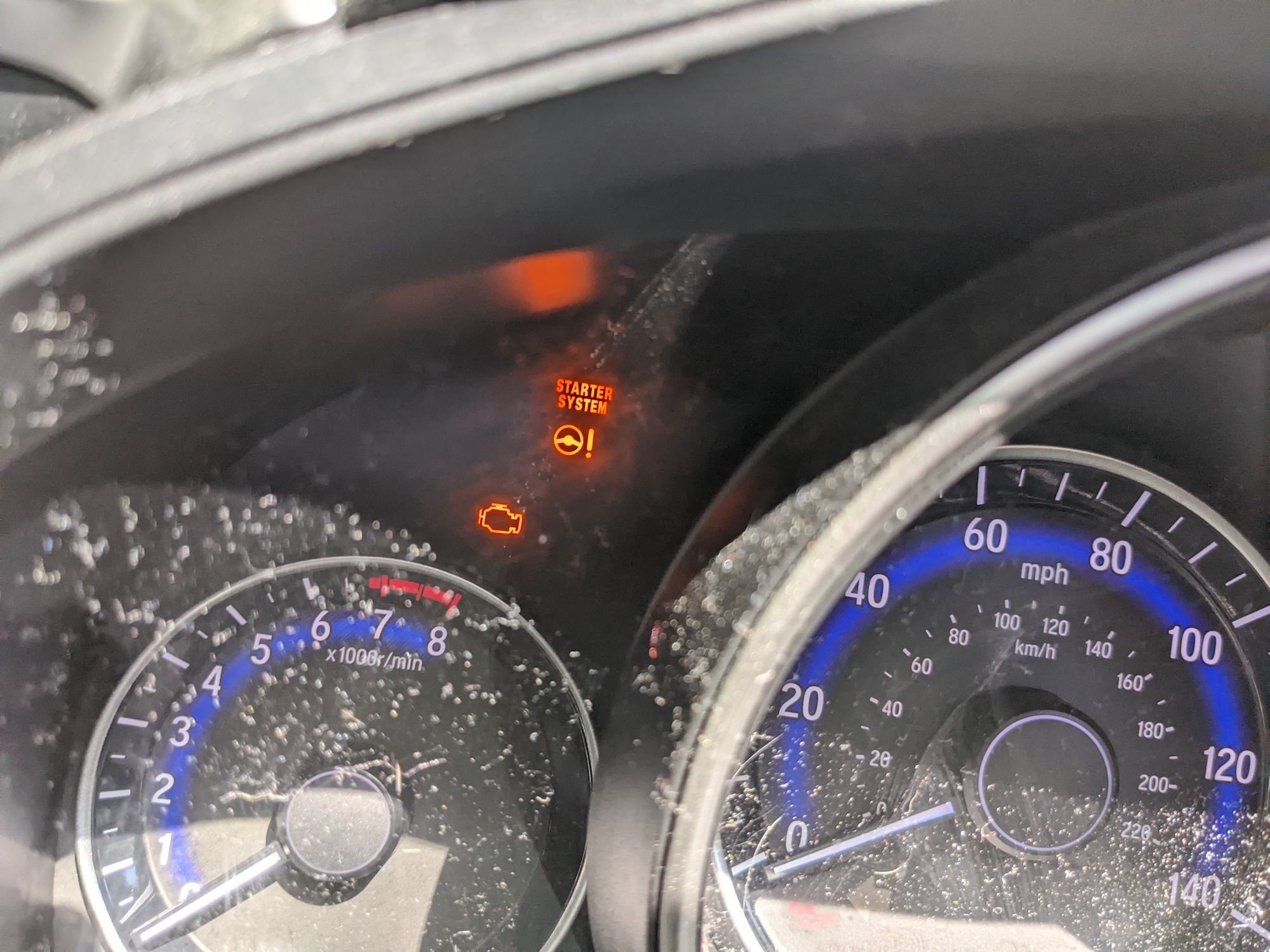

My 3rd Gen GK manual transmission suddenly wouldn’t start. I haven’t had any indication of a bad starter or battery before, so it was frustrating to be immediately immobilized. Turns out that the Starter System light AND the VSA (traction control) lights lit up because plastic pieces in the brake and clutch broke. The broken plastic confused the sensors attached to the clutch and brake and the vehicle simply refused to crank the engine.
Attached are images of the broken (disintegrated) piece and the newly installed plastic. Essentially, the plastic pieces acted as a contact patch for the sensors - since the plastic disintegrated, the sensor had nothing to measure against and the vehicle decided to prevent the engine ignition.

Starter System warning light and check engine light
Starter System warning light and VSA (traction control) light

There was nothing bad with the battery or the actual starter. The plastic looks like Delrin - it’s hard to tell.
