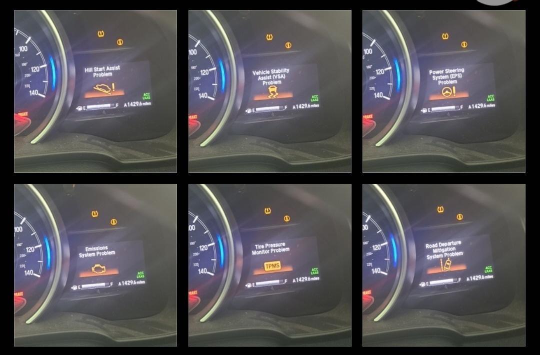

I ended up getting 6 check lights last week:
Idle was a little off before allllll these lights flipped on.

Heres a copy of the report.
