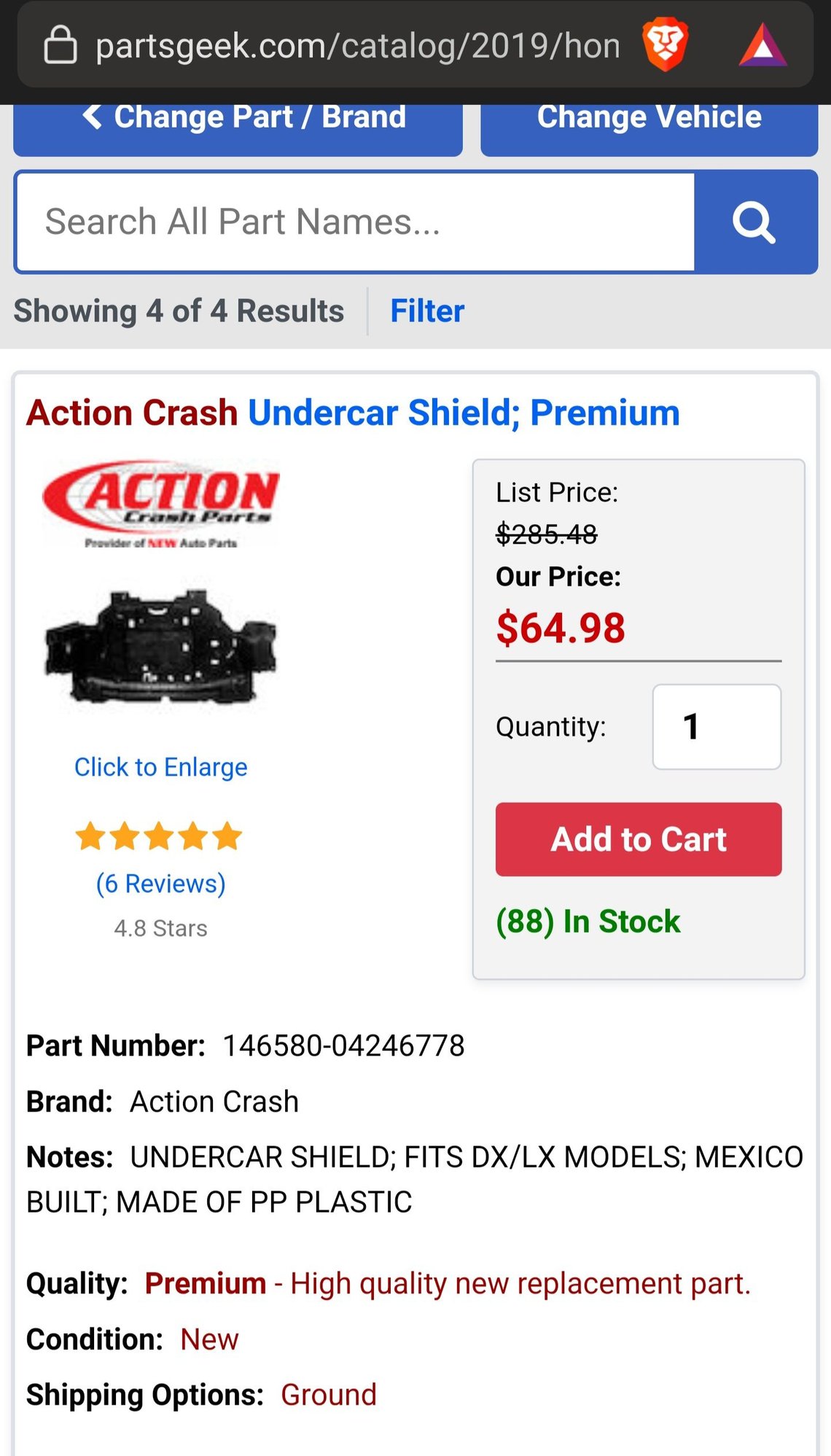

I've had mine refastened twice, once for $20.00, and another time for $30.00. both times by independent mechanics.
I had the bigger underbelly pan refastened once for $40.00. Honda wanted $720.00 to replace the pan!
All three times because of unavoidable deepish water. Several people here have removed the front pan entirely.
