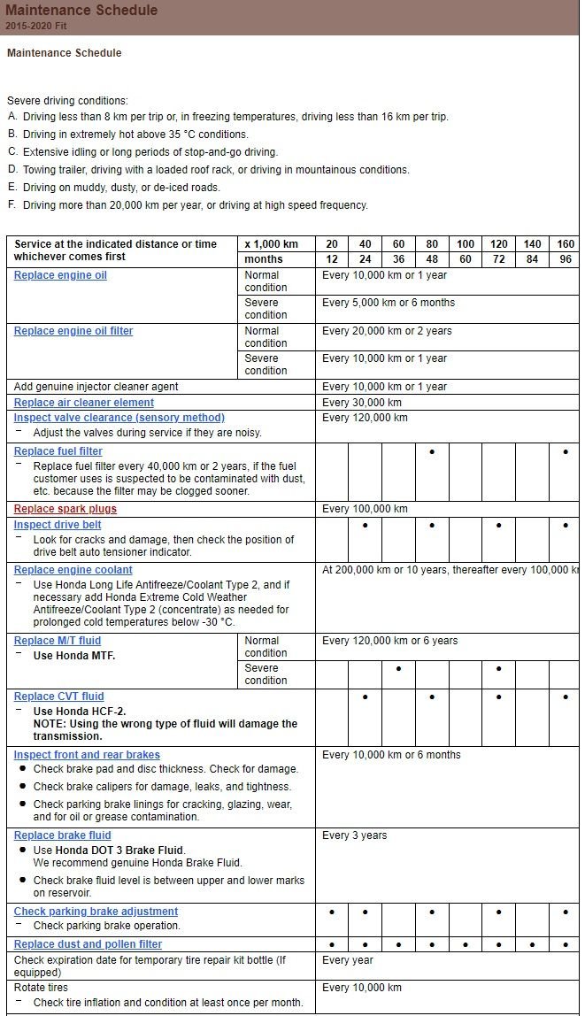

Originally Posted by howarejew
Thanx. Good and valid information !!
Old Feb 13, 2023 | 10:55 AM
SilverEX15's Avatar
Posts: 3,292
From: Shokan, NY
Thanks. I thought I remembered seeing that somewhere. I'm getting 40 - 50 MPG, so I can't complain. I have a set of plugs for both Fits, ready to go.
Related - I made up a toolbox just for the Fits. It has all the tools and things I'll need when working on one. I was looking forward to using it when I worked on my son's car yesterday. Naturally, I couldn't find it. : )
EDIT: I just noticed the last line about rotating tires. I saw the 10,000, and I assumed that was "miles." Converting to km, it's about 6,000 miles. I've been rotating mine every 5,000 miles. However, since all the mileage figures refer to km, I'm behind on the plug change. I'll wait till it gets warmer.
+1
much appreciated!
EDIT: I just noticed there's a "Severe Conditions" schedule for oil and filter. I'll admit that I fit into "A".
That's also the frequency I replace my oil and filter at (oil every 6 months and filter once per year).
Funny, the dash oil change indicator does not take into account any of the conditions mentioned above.
Just goes to show that it's not accurate to begin with.
