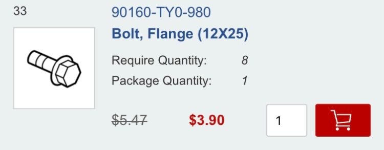

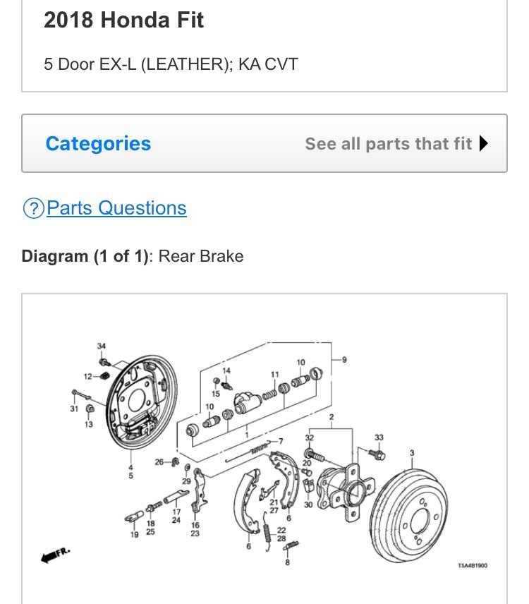

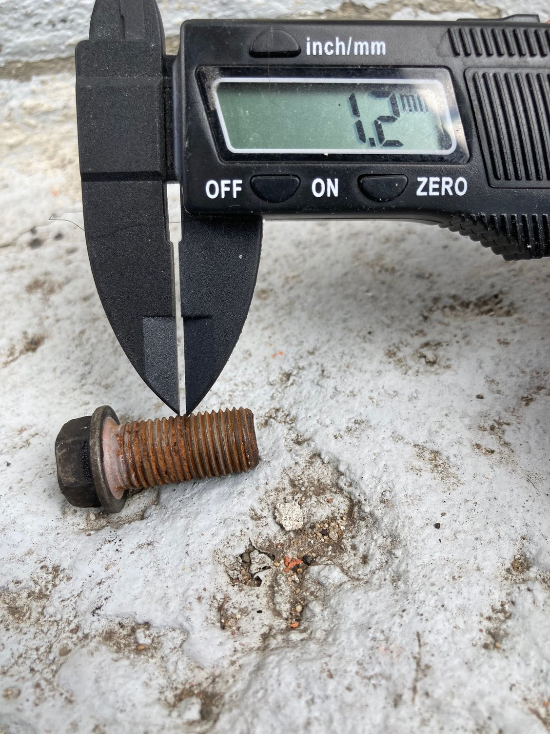

Can someone explain to me what bolts do I need to buy? This is the bolt part number 90160-TY0-980 but it’s like $4 per bolt and that’s ridiculous when I should be able to get it at Fastenal of even Lowes for less and not special order. It tells me it 12x25 flange bolt and apparently that’s M12 - 1.25 x25. Anyone have experience or know what I can get that’s not an arm and leg for bolts?

what does a wheel bearing bolt have to do with the caliper? I’m asking about a bolt that I can get with the strength rating at like 10.9 locally. There’s literally a picture of the wheel bearing.

Paying $50 with taxes and shipping for the set of bolts is ridiculous when the wheel studs are only $1-2 per stud. Thanks for the comment of disgust though.
