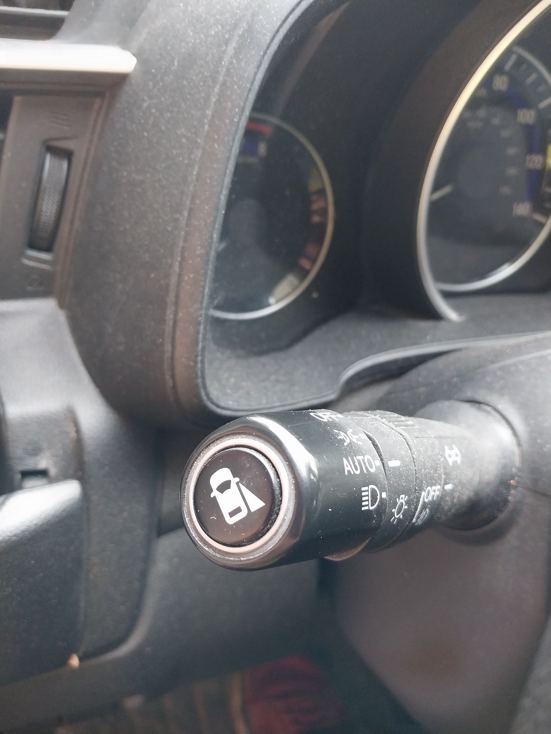

Right turn camera always on
My right turn camera is always on even when turn signal is not activated

Right Camera Switch.
Press this button. Your right side camera will turn off. You can turn on and off your camera when you change lanes to the right when your car is moving.
