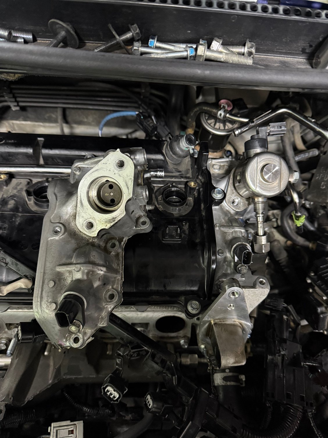

i actually came across this thread right after doing a swap in a Honda fit and coming across the same issue, at 4k it will go into limp mode and on start up it would be giving me the code p0088 and then when driving and into limp mode it would give the code p0087 low pressure in the rail also would have a ticking noise at idle from the high pressure fuel pump. thankfully after I did the swap I held onto the old motor
2015 Honda fit
newer motor 2020 motor
what had to be changed to fix this issue was
2015 cams and 2015 fuel pressure housing assembly after this the noise subsided and everything functioned how it is supposed to, sofar have test driven without issue and on full throttle I don’t have any issues or codes.
my suggestion for you guys is to change back to the cams that match the high pressure fuel pump and also the housing needs to be the correct style. The casting look almost identical between the 2 versions but they are infact different I will attach some photos to assist with this.

so I did the swap last week and really only had time to work on it during the weekends to I did the cams and assembly today and after I heard the noise go away I was pretty sure there wasn’t going to be that issue anymore. After going for a 5 minute test drive trying to push it to see if the issue would happen again it did not. Around 10 miles of testing with no issues. I don’t believe it will come back.
I believe the cam shafts did play a role in it aswell as the cover/ hpfp assembly as I did notice there is a difference between the two I had as the bolt holes are positioned slightly at a different angle I’m not sure how much it effects it as I measured both and they seem about the same dimension wise.
