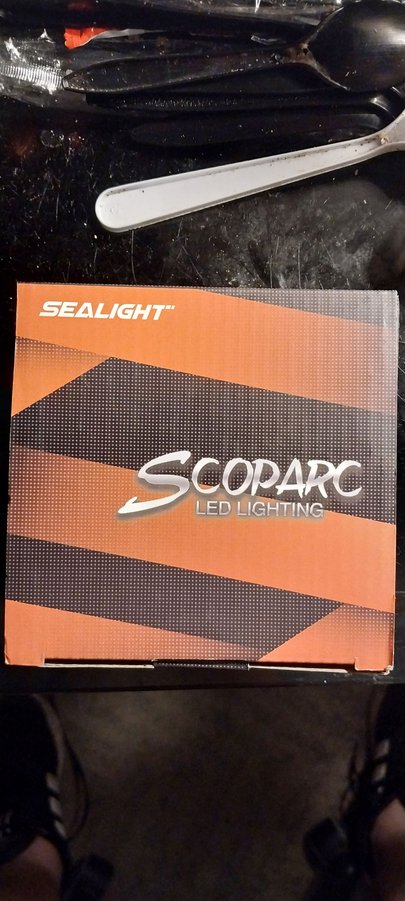

H4 LED Non Adjustable Lights.
There are LED lights that are a direct fit like your current garden variety big box Halogen light bulbs like these lights.
Simply plug and go. No adjustment needed. No worries about installing sideways or upside down like the adjustable LED lights.
Beam pattern is the same as your current Halogen light bulbs only alot brighter. I even upgraded my driving lights to LED Lights.
The brightness is awesome. You can see alot further down the road. Especially in dark unlit roads.
I'm hoping longevity will be the same as Halogen lights. I've had my LEDs for about 4 months. So far so bright.
Will I ever go back to Halogen Sylvania Silver Star lights? Heck NO!!!!!!
