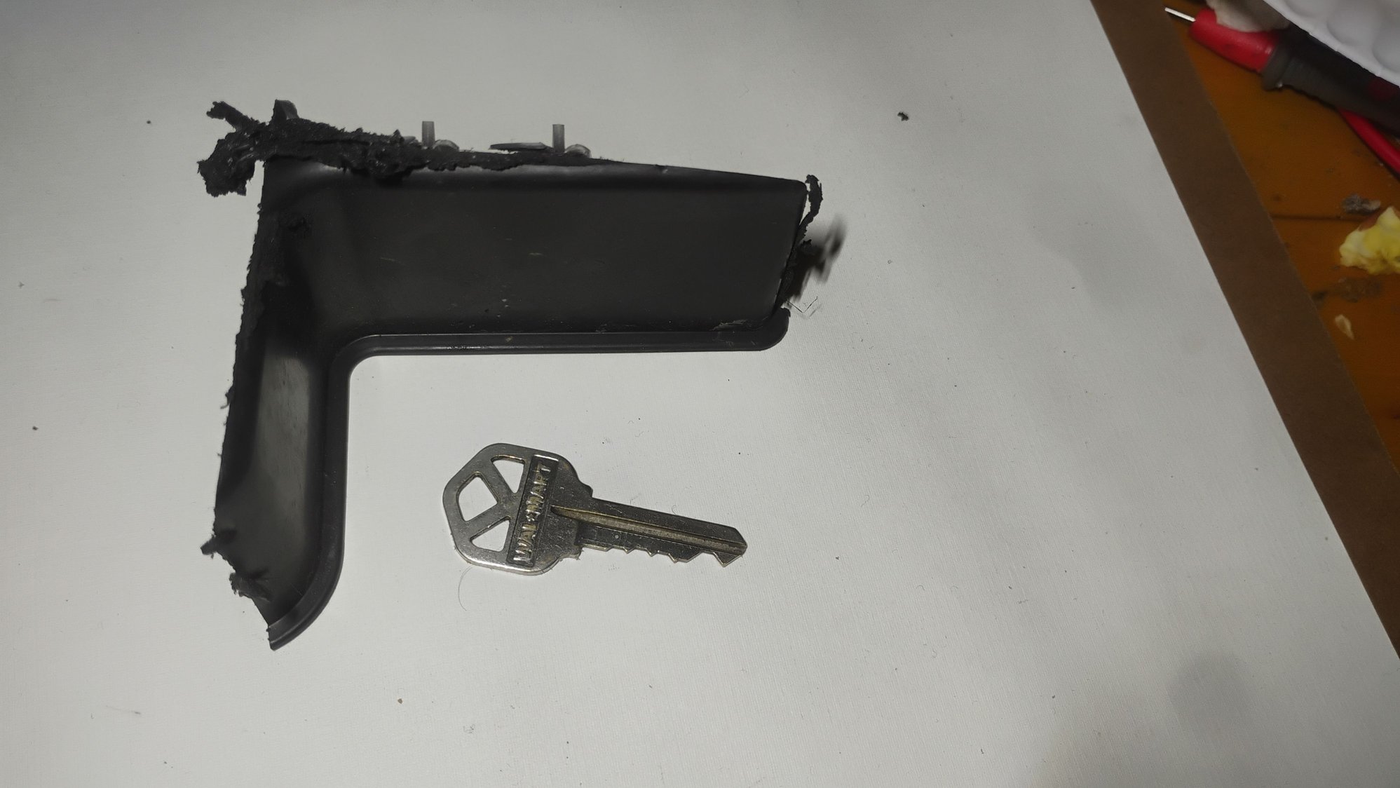

Old Jan 18, 2025 | 04:46 AM
nayov's Avatar
Joined: Sep 2022
Posts: 148
From: ME
Yeah I don't see acid spillage to be a problem. Back in the day with screw caps and regular water filling, maybe but not with today's so-called maintenance batteries.
Anyway, here's a pic of what has to be hacked off (key for size reference):
