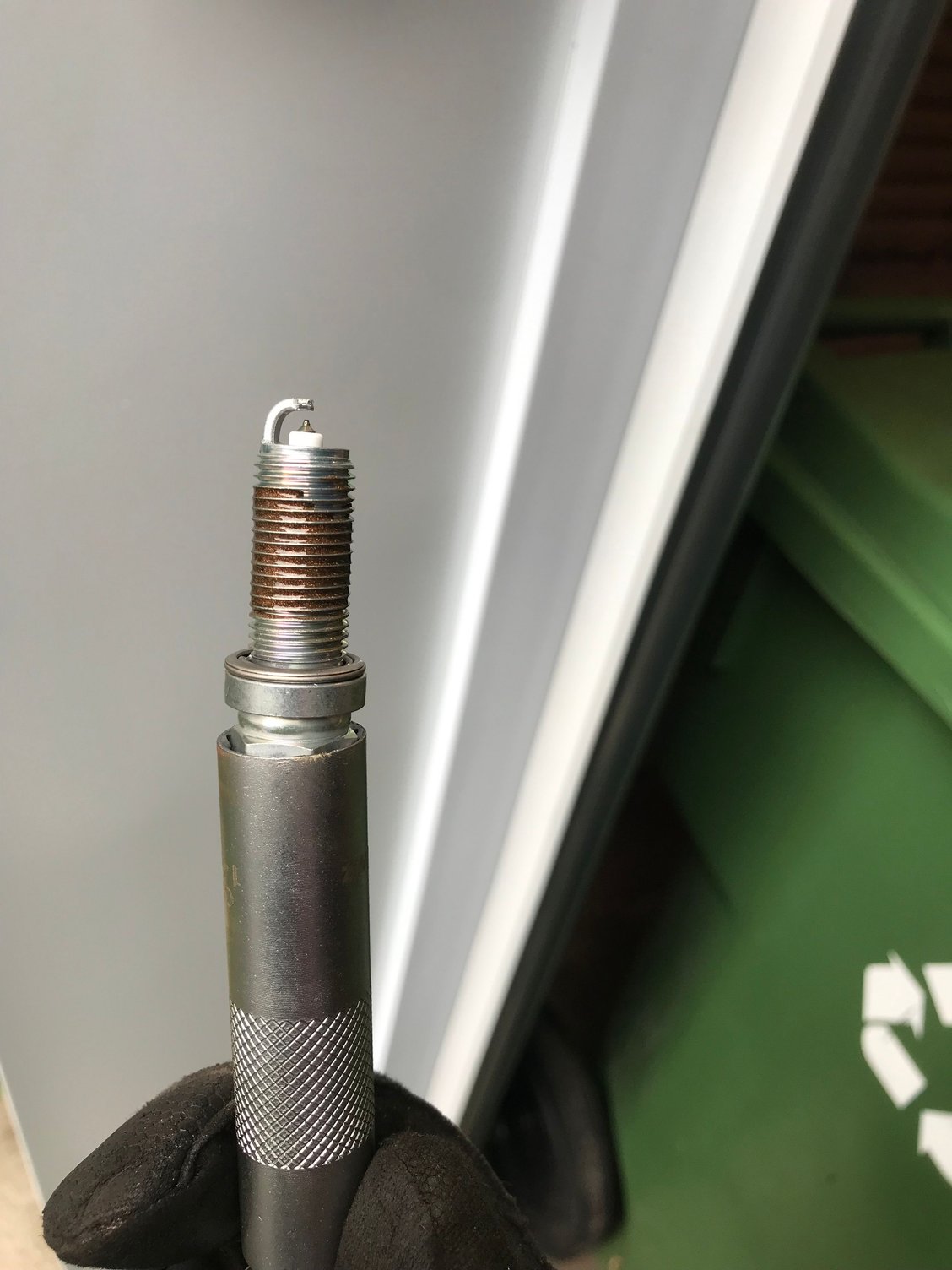

I changed my plugs which I’m pretty sure were original after 100k miles. There do seem to be some deposits which would indicate some less than ideal valve sealing. Still, doesn’t look terrible for 100k miles. My car was tending to hesitate in first gear and seemed to get bogged down occasionally after fully releasing the clutch, even with what I consider an appropriate amount of accelerator pedal input.
car seems to cold idle a bit better and it’s still very early but I think the occasional sluggishness in first gear is improved.

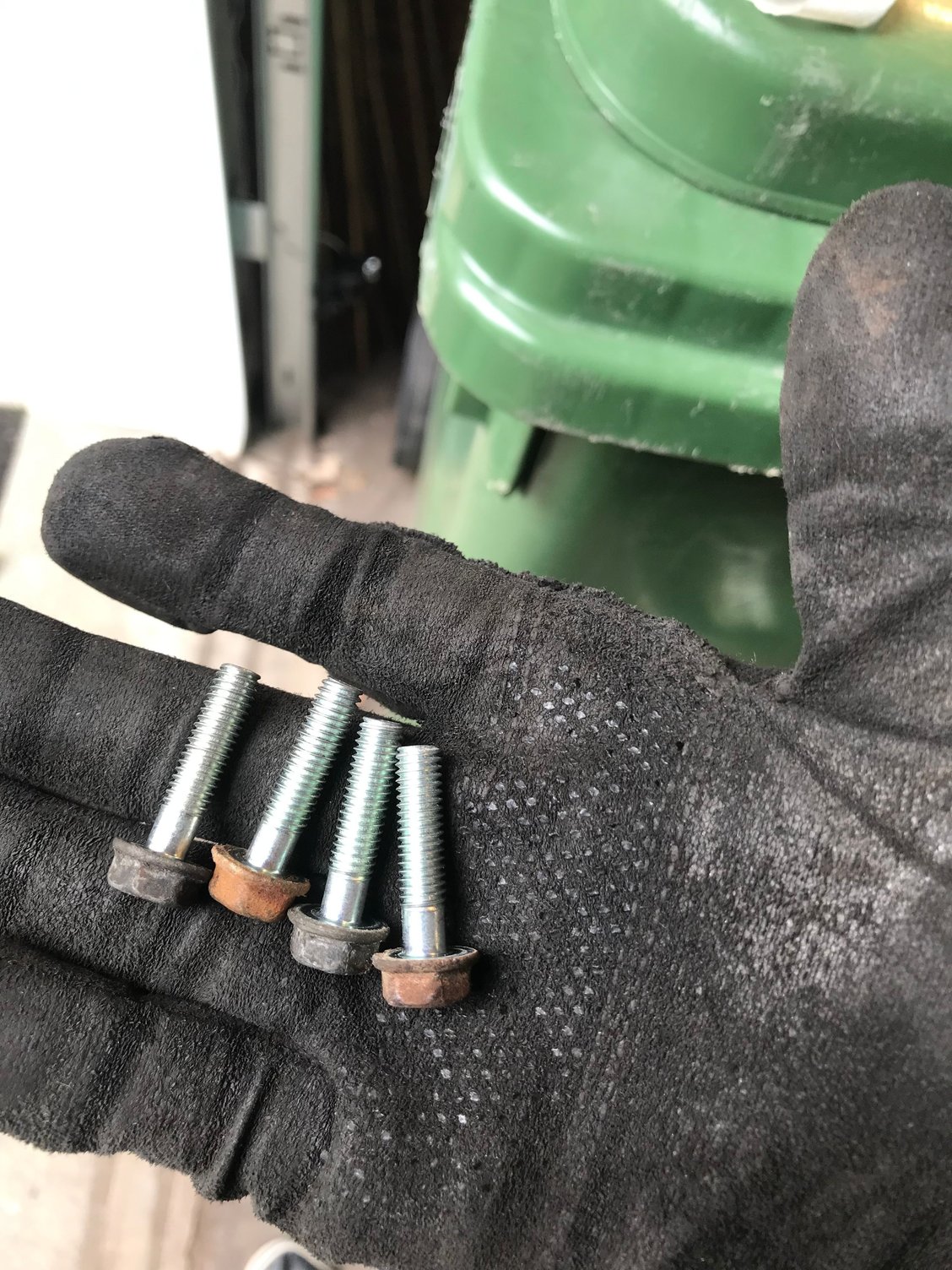

Looks like the coil pack bolts have never been removed. The two rusted heads were for cylinders two and three, probably because the py didn’t get the rust preventative oil bath from the previous owner that added oil like it was a champagne shower.
Looks like the coil pack bolts have never been removed. The two rusted heads were for cylinders three & four, probably because they didn’t get the rust preventative oil bath from the previous owner that added oil like it was a champagne shower.

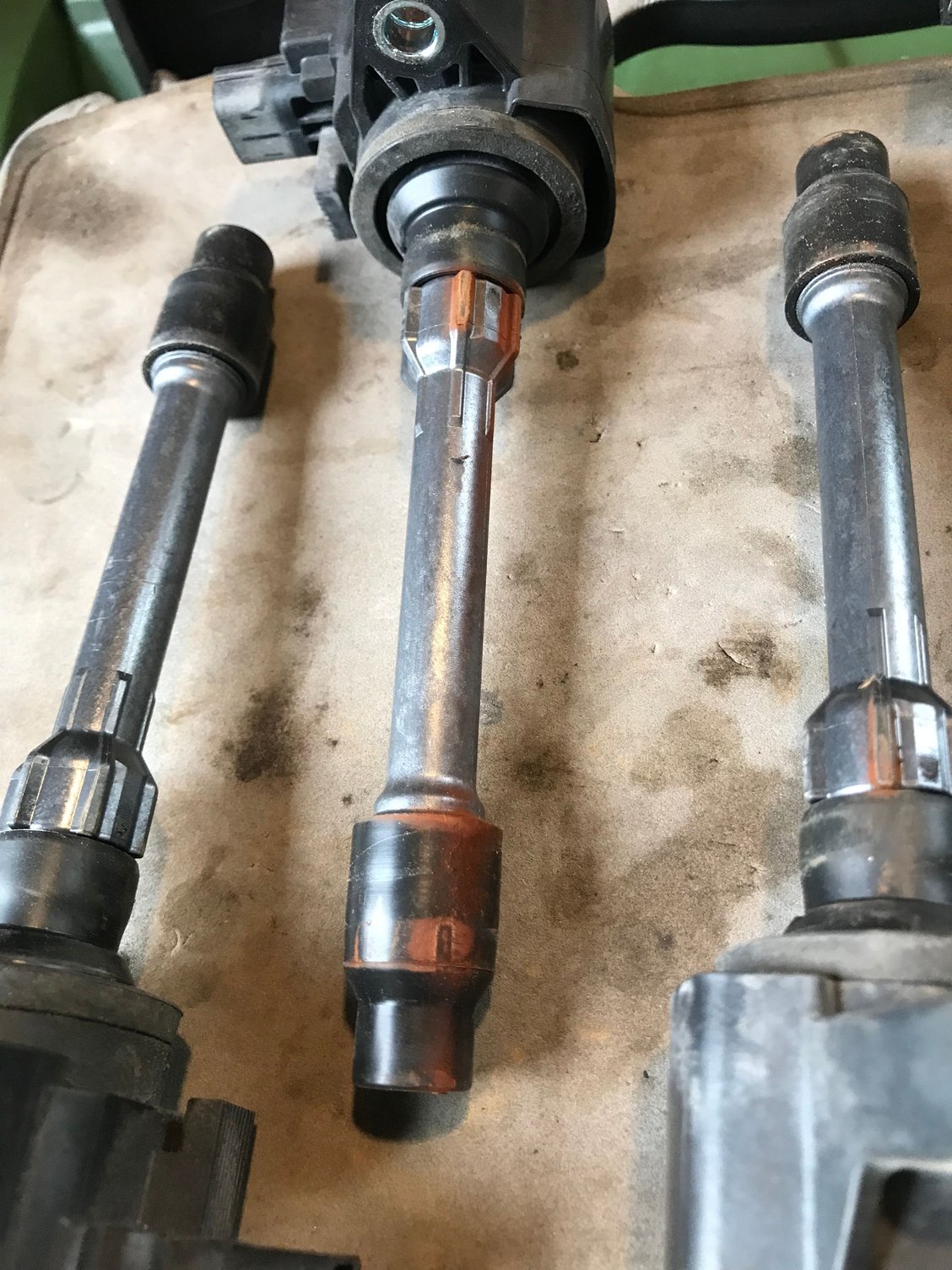

Cylinder 2 coil pack had some noticeable red/terra Cotta looking marks. I wonder what this could be.
Cylinder 2 coil pack had some noticeable red/terra Cotta looking marks. I wonder what this could be. The coils look very clean, I’m doubting these are the original ones from the factory. I like the design with a rubber gasket that fits over the plug hole tube, creating a nice seal against moisture or crud getting inside.

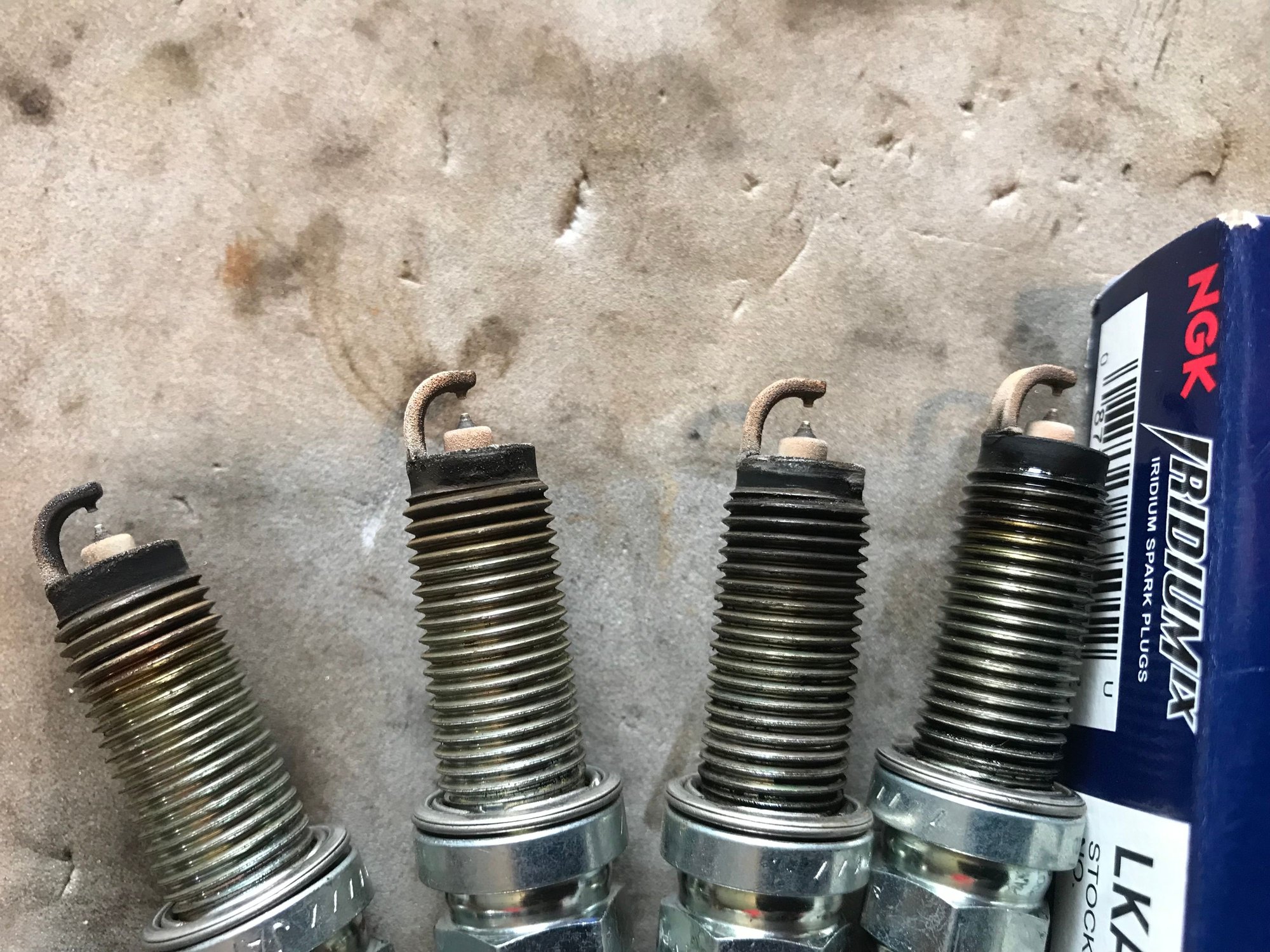

Old plugs, cylinder 1 through 4, from left to right. Electrode gap still looks ok but there are some whiteish deposits on the insulator and the ground electrode, probably from leaky valve seals.
