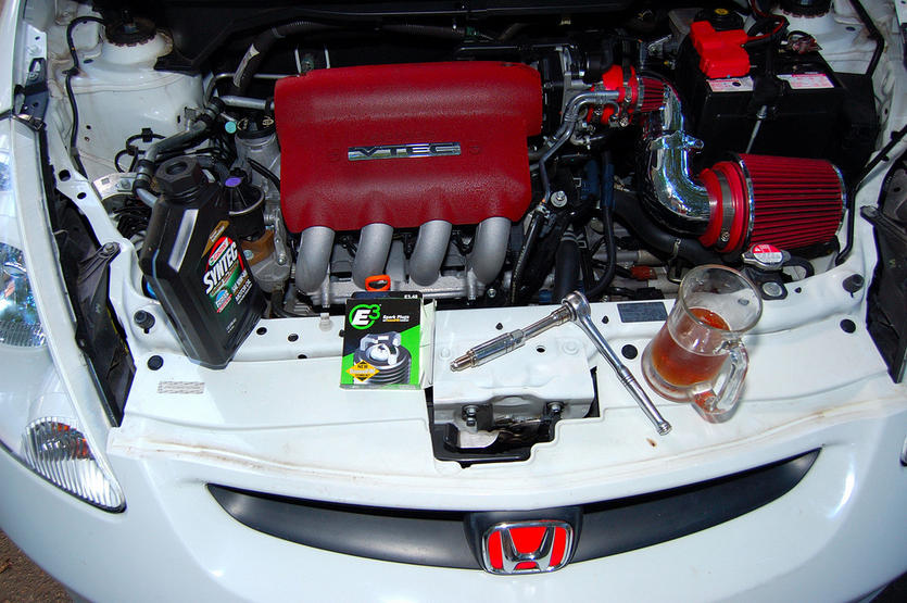

So first off, here are the tools you will need:
  • 10mm socket

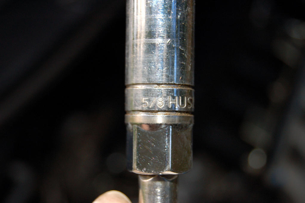

  • 5/8" Spark Plug Socket
  • Regular Ratchet and a Torque Wrench
  • Dielectric Grease
  • Anti-Seize or other lubrication
  • Ice cold beverage of your choice

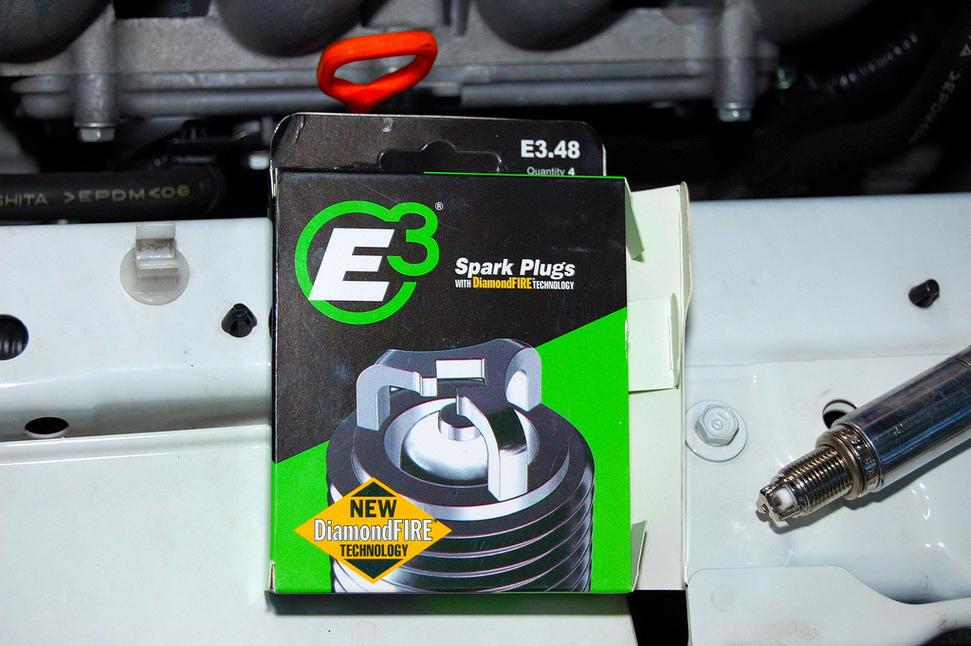

Here we have tools and parts needed. I forgot to get some anti-seize for the plugs, so I used some Castrol synthetic oil I had in the garage.
I went with some E3 DiamondFire plugs. I have heard so many good things about these new plugs. Every test I have seen, they make real power on both an engine and chasis dyno. sometimes as much as 12-14hp! They are also able to be used in forced induction and nitrous applications, which of course you can't do with platinum plugs. I got mine from Summit Racing High Performance Car and Truck Parts l 800-230-3030 for less than $5 each.

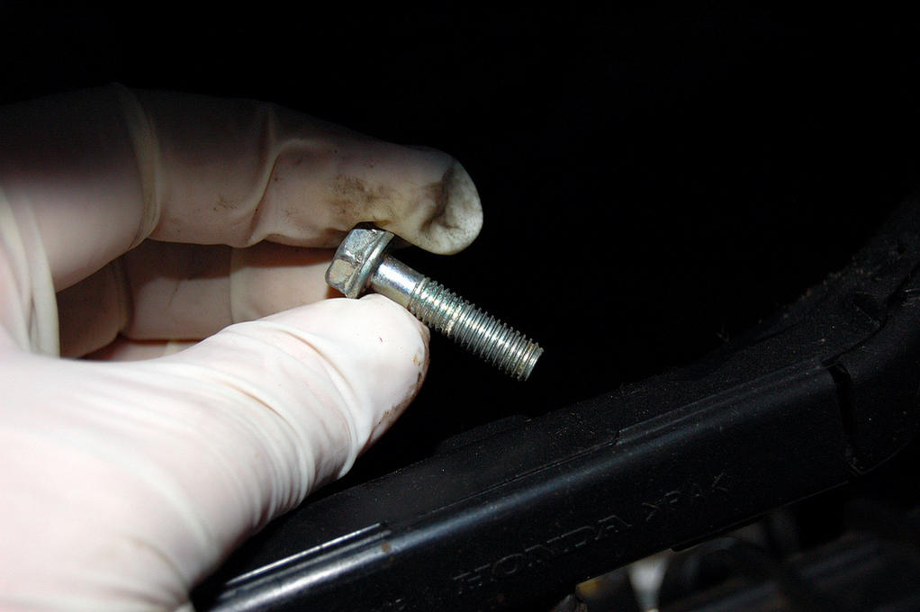

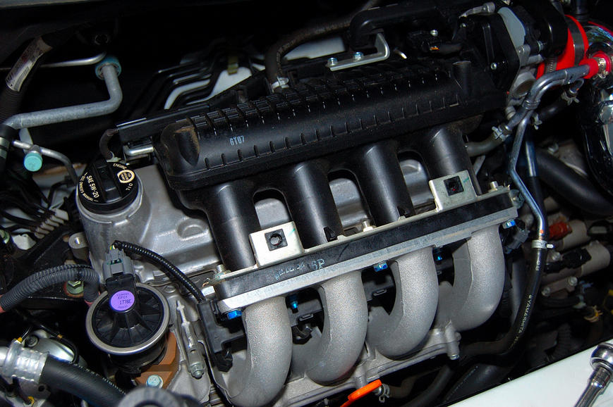

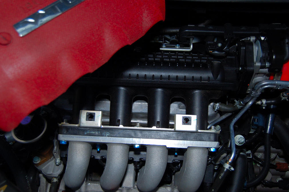

I figured out afterward, that I didn't really need to remove the cam cover, but I had already done it. You can skip that step since it would appear that it really doesn't get in the way much.

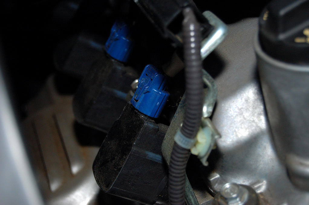

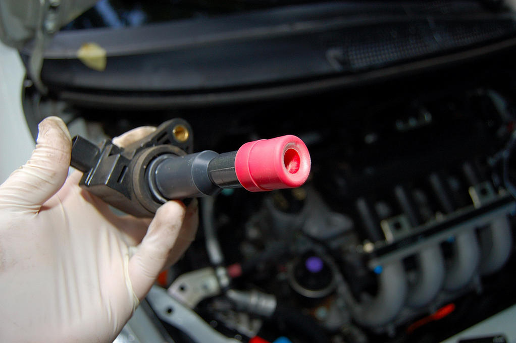

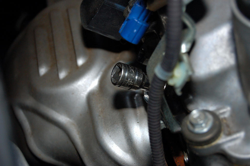

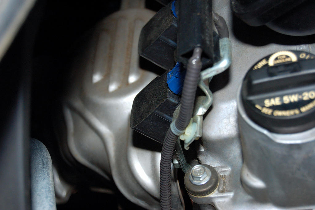

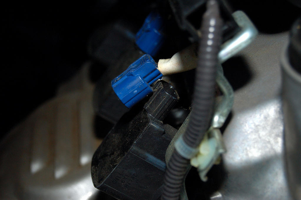

Looking on the rear of the engine above the exhaust manifold heat shield, you will see the 4 coil packs with blue wiring harness clips attached.

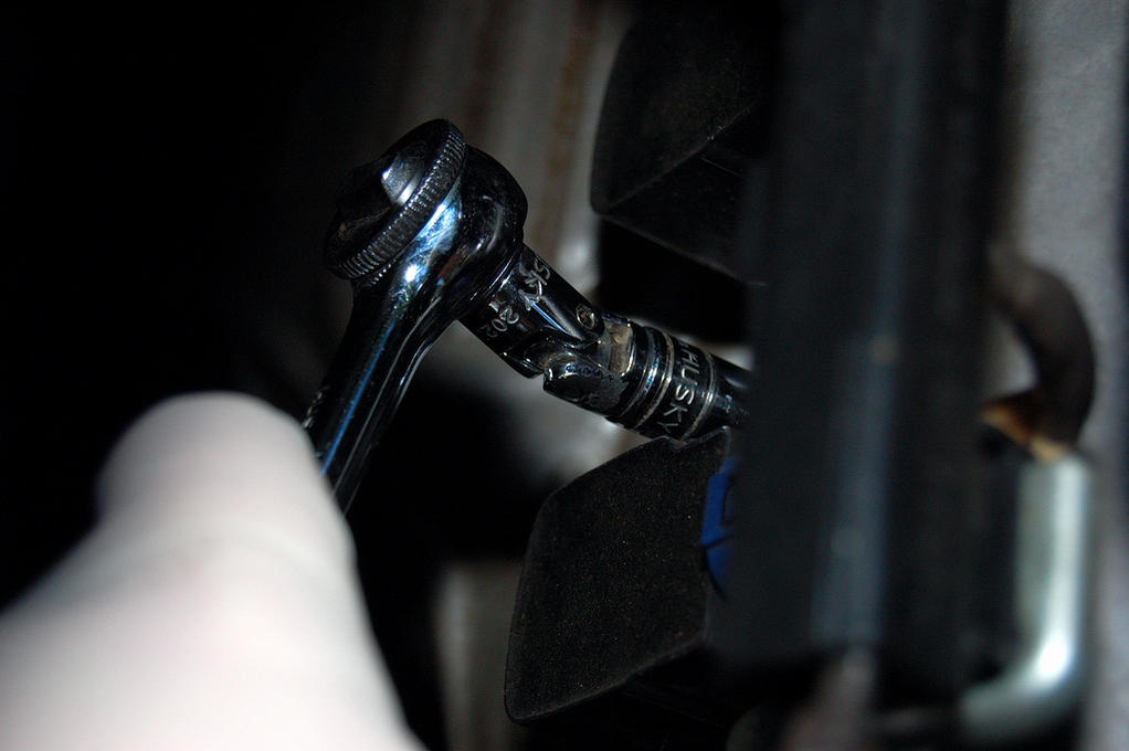

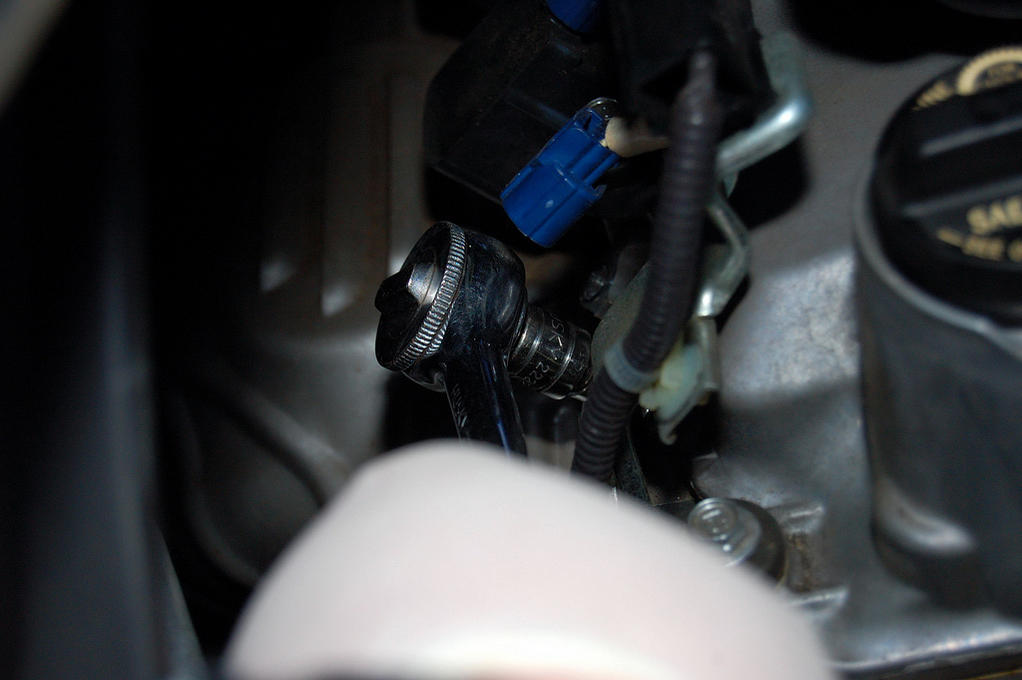

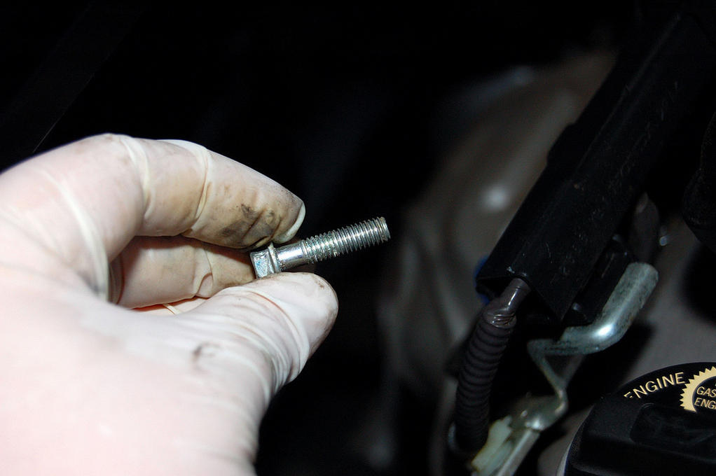

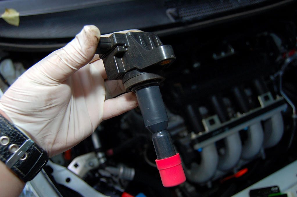

You will now use the 10mm socket and ratchet to remove the 10mm bolt holding the coil pack onto the head.

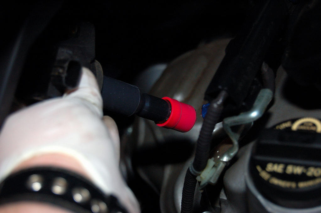

And now you want to unplug the blue wire harness from the coil pack. You can then pull the entire coil pack out of the spark plug well.

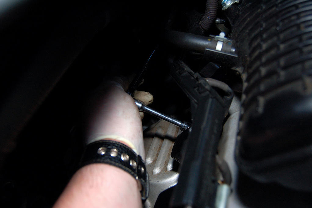

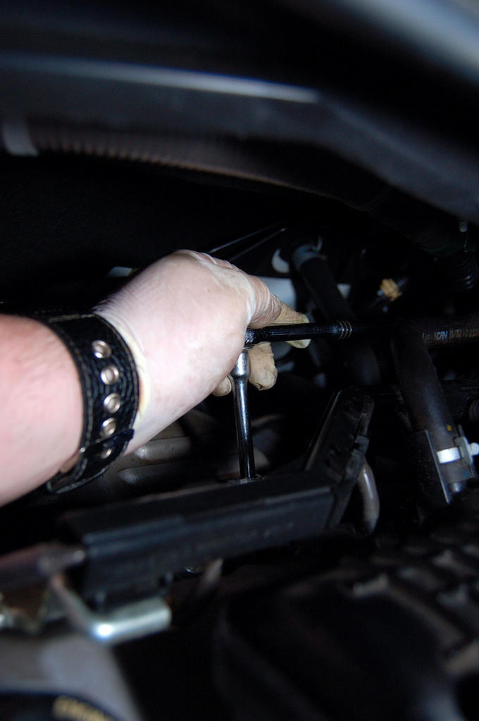

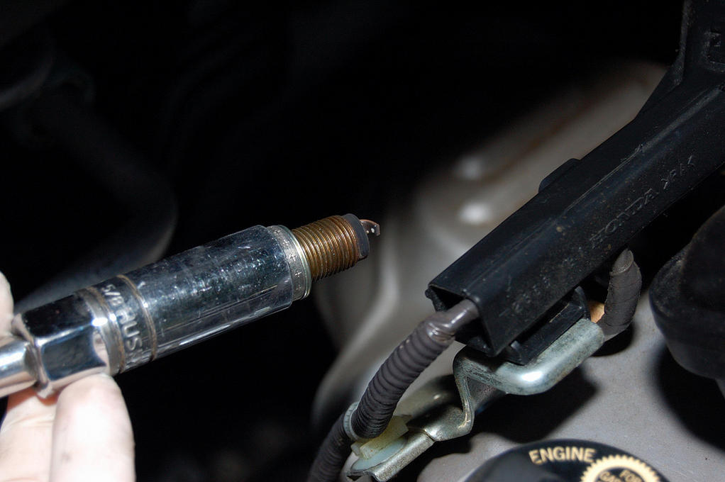

Now you will use the 5/8" spark plug socket with a medium extension in order to reach all the way down into the spark plug well to the spark plug. By using an actual spark plug socket instead of a regular socket, the rubber o-ring inside will grip the plug and allow you to pull it out of the head after loosening.

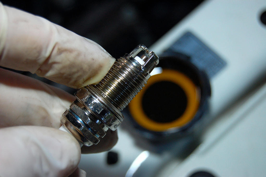

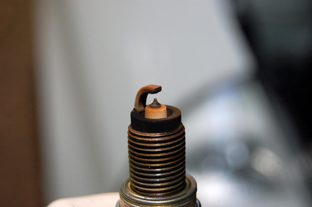

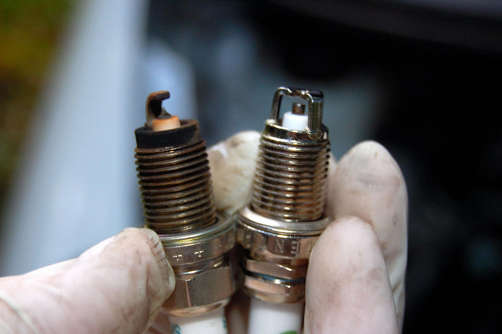

There are many references you can check in order to properly read a plug and it's performance. This plug is functioning great. And the engine is neither running too lean, nor too rich. The light tan coating around this plug, with no oily residue means this engine is running very good. Considering I only have 19,000 miles, and I run Royal Purple Race Oil, and other than my SSR Intake and muffler delete, I have no other performance mods, this is too be expected.

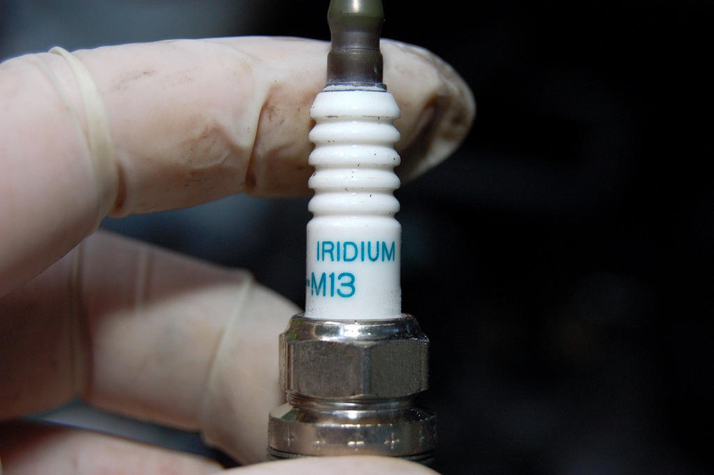

I was a bit surprised to see that the OEM Honda plugs were Denso Iridium. Nice, expensive, high quality plug! No wonder they last 100,000 miles before replacing.

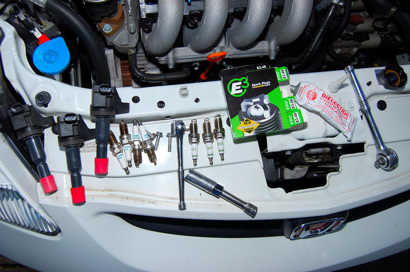

And here we compare the Iridium plug with the E3 DiamondFire plug.
The E3 plugs come pre-gapped. If you have to gap your plugs, then .044" is the recommended gap size. It is at this point you will want to coat the threads with either anti-seize or a quality oil to ensure that you get proper torque when installing the plugs. Also make triple sure the washer is on the plug. Iron heads have a tapered seat plug, and aluminum heads use a washer type plug.
When installing the new plugs, you want to start with just the extension without the ratchet. You will want to be careful to not cross-thread the plug into the head. Remember this Honda head is aluminum and you can very easily tear up the threads of this rather soft metal. So be careful and take your time. Tighten the plug down finger tight. You will want to then finish it up with a torque wrench to around 13ft/lbs. I have tried to locate an exact spec, but I have not been able to yet. I do know that most Honda aluminum heads require a spark plug torque of between 13-18ft/lbs. Be careful to not strip out the threads by putting the nut-buster super-grip tightening wrench of death to it.

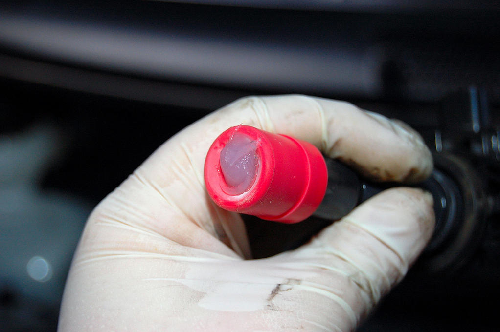

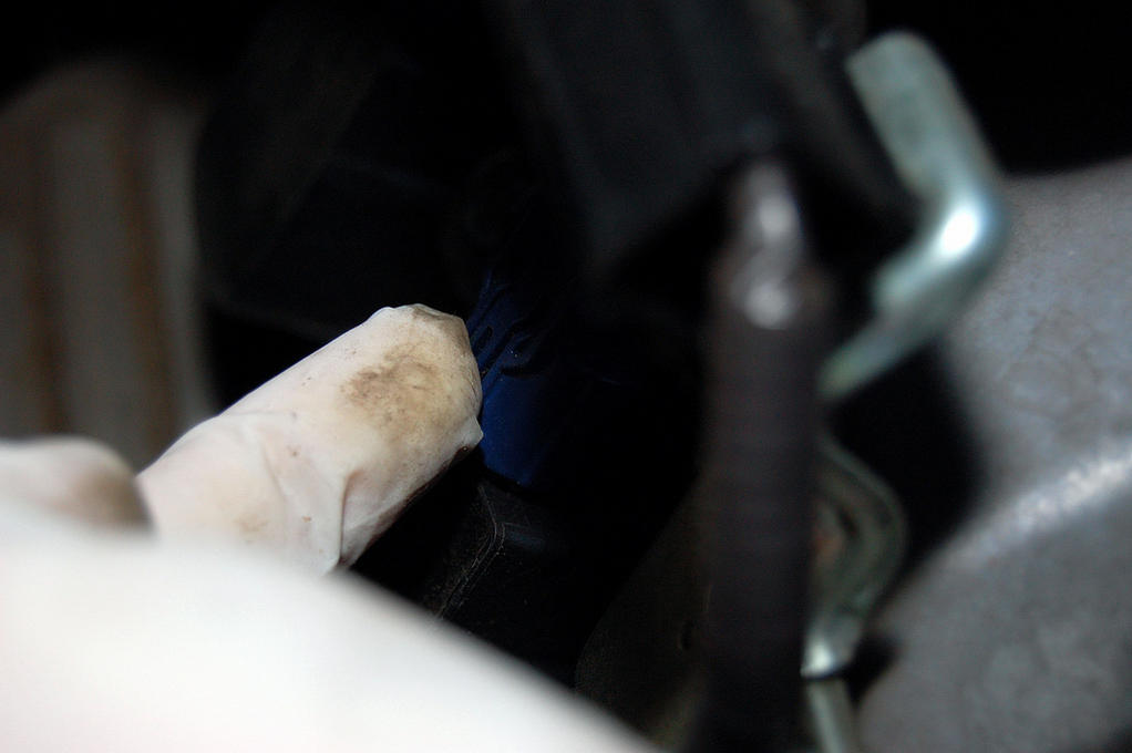

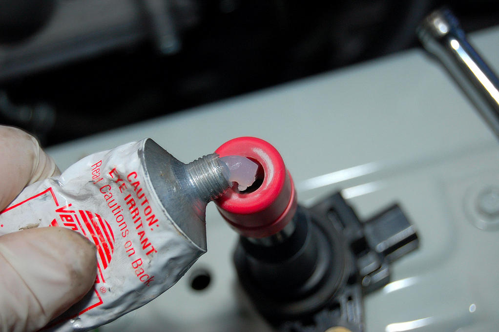

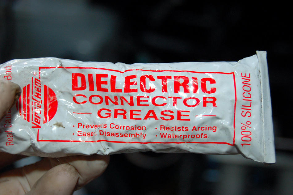

Now you could use dielectric grease to coat the interior of the coil pack. This will ensure good conductivity between the coil and the plug. It will also keep moisture out. Use a small amount on the ceramic portion of the plug.
Now re-install the coil pack onto the spark plug.

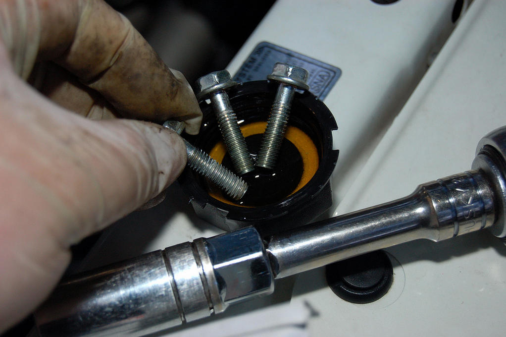

You want to be sure and also either use anti-seize on the coil pack retaining bolts or a quality oil, as I did in my situation.
You will need to again be careful to not cross-thread the bolts into the aluminum head. Again torque them down to around 7ft/lbs.

You mentioned dielectric grease - where do you get it?

You should be able to get it at most any auto-parts retailer, such as AutoZone, PepBoys, O-Reily's, Advance Auto Parts.... and such.
You might even find it at an electronics repair parts store where they sell things like resistors and capacitors. Like at Radio Shack.
