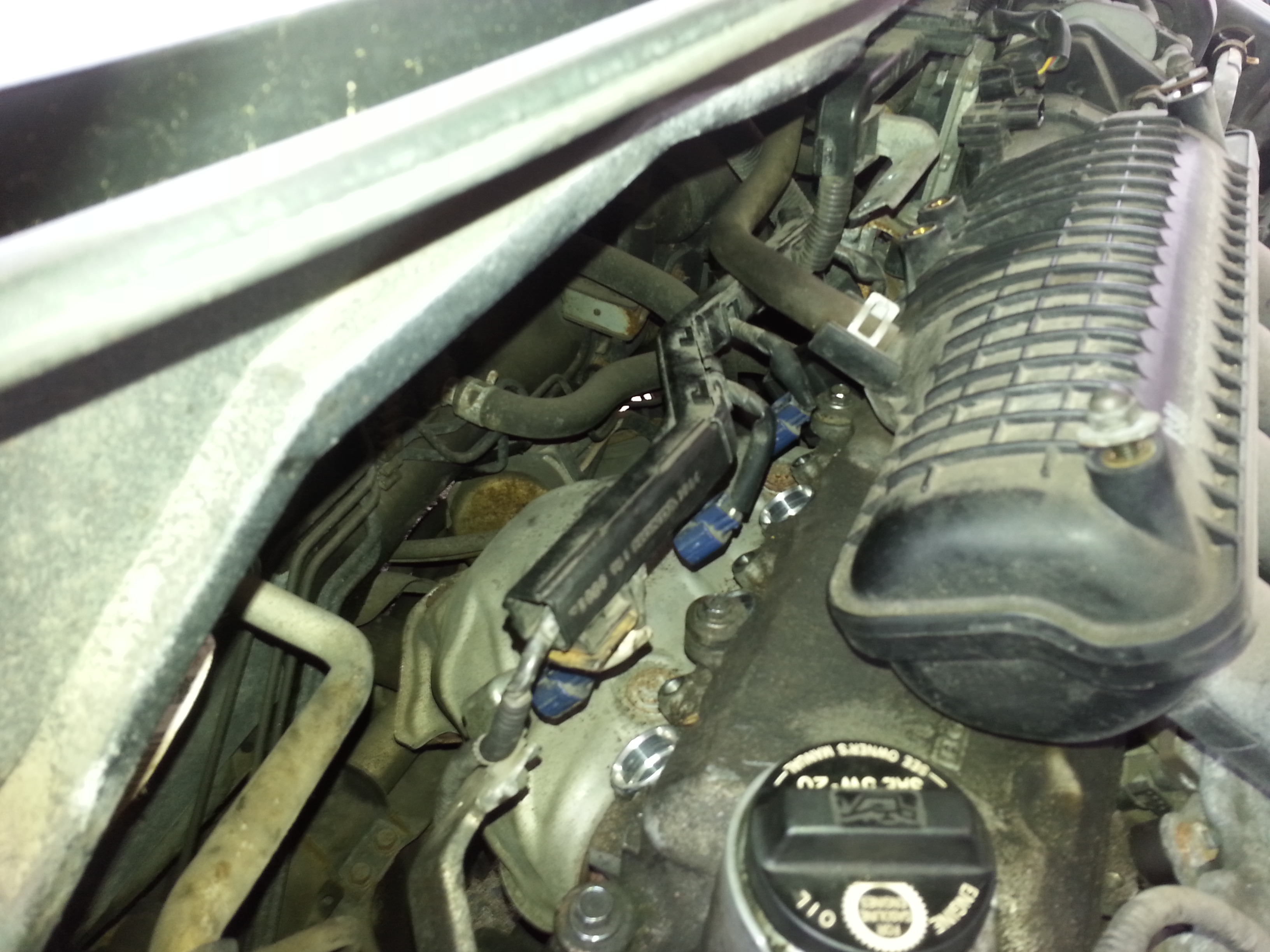

I just did mine, it was easy as pie. The best thing to do is to unscrew the support for the ignition wires, the left side screw, and the 2 top one under the engine cover. That way you can push/pull the wire support out of the way. The no 3 and 4 cylinder are harder to do, but if you take your time and do it careful, it's not that hard. There's a lot of room behind the engine for your hands.
I did not take step by step Pic. ( those ons on this thread are good) But here some pic anyway.

You see those screw missing on top? that's the ignition support screws I talked about.

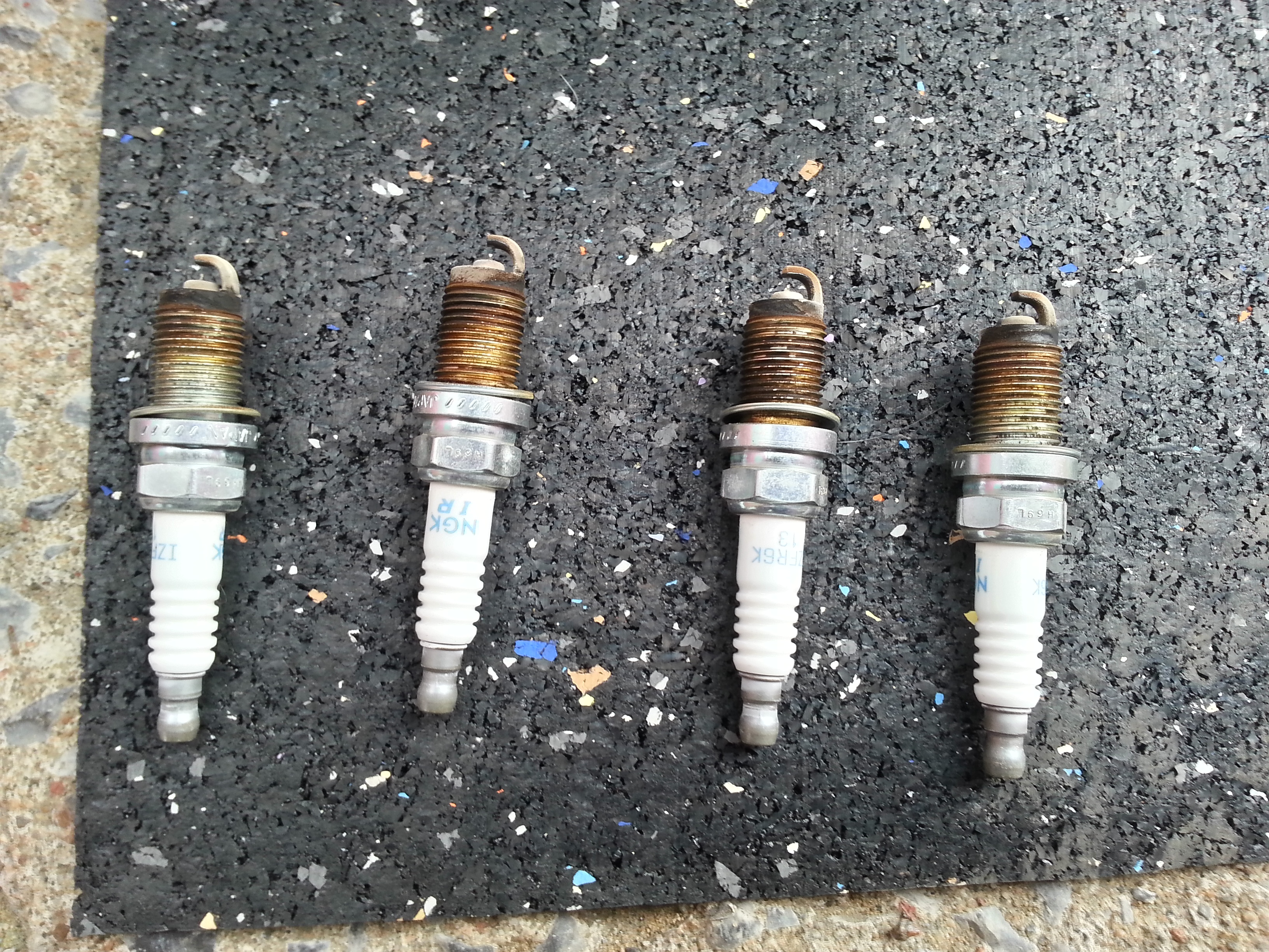

My Spark plug were not Denso, but NGK, I know they use both, probably depend on suppliers. They are IR ( laser iridium long life I thing) I don't know how long they last, but giving the Denso 120K miles lifespan, I guess it's the same for them. So mines have a little over 50% into their technical lifespan. but they did not look too bad.
I replace them with denso Iridium power IK20L. I bought those because I got a good price on them, and I thought at first the lifespan was similar. I was wrong, but now I have them, and I have my face in the engine bay, so I'll change them anyway. I don't think those Vs the long life will make any performance difference on my car beyond placebo effect. engine is stock after all. They will last only 20-30K miles, But it's was fun job to do and not hard at all, so I don't mind changing them every 3 years. ( I will own my car for another 4 years maybe)

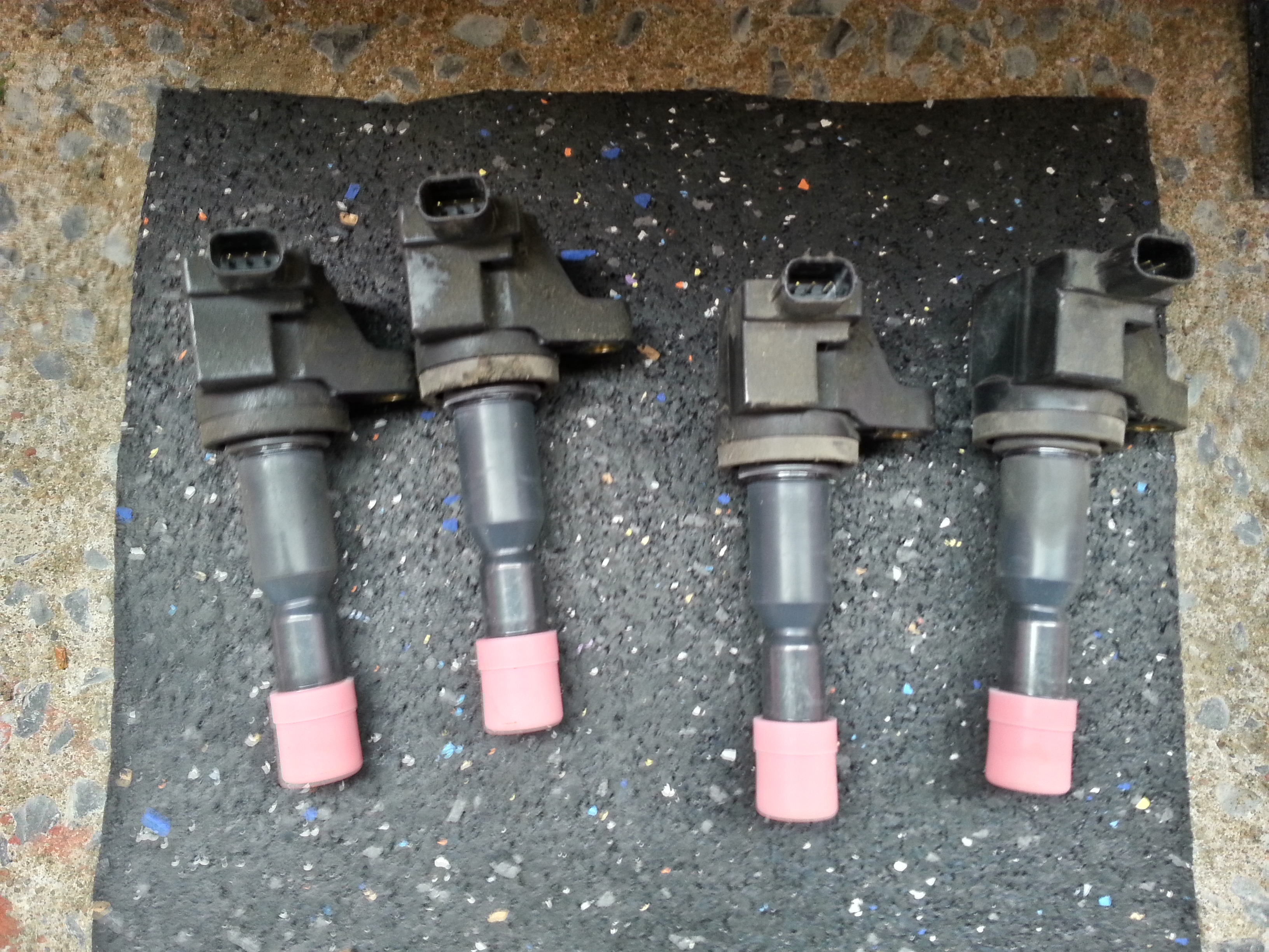

The exterior is dirty, but otherwise, the connectors looked ok. But I used a electric connection cleaner on the coils anyway. You just slowly ( require some force and twisting) pull on the elongated part, and it will come off. There's a coil in there with something that look like a fuse ( no PIC), I cleaned that and the connection inside the black box part as well.
I put a little dielectric grease on the Plug ceramic part ( not on the coil red rubber, because It could get on the connector, you don't want that) and I did not used anti-seize. There was no trace on any on the stock screws and plug and they unscrewed easily anyway.
