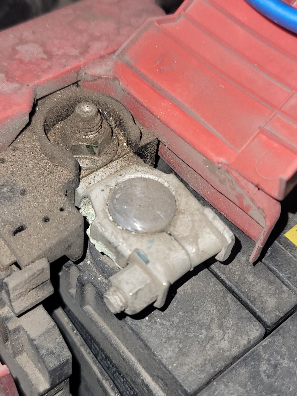

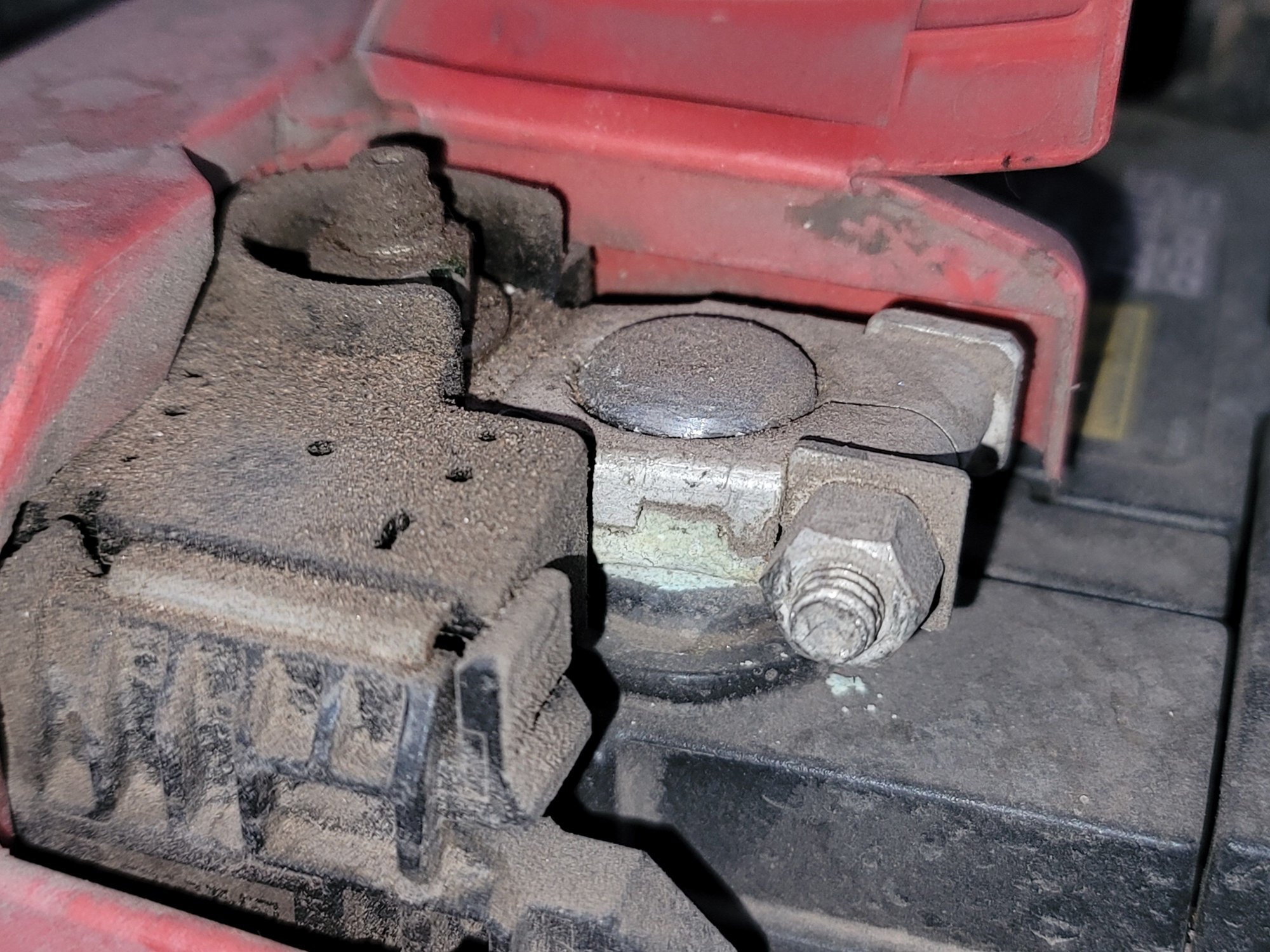

I purchased the battery on 07/2024. It is only a year old but it was also a generic brand from oriellys. Here is the name: Super Start Extreme Standard Flooded Top Post Battery Group Size 151R 340 CCA 55 Minute RC - 151REXT
There is some green gunk on the red terminal. I have a wire brush but I am afraid to use it lol. I will have to take it to an auto place for a free battery check up. See the photo below for battery:

A one-year-old battery shouldn't give you any trouble unless it's been run completely dead many times.
That *is* the kind of corrosion that should be cleaned off, but that doesn't look bad enough to cause problems. There are low-cost ($4-6) brushes designed for battery terminals. One end is designed for cleaning the battery post, the other (in the handle/cover) is the proper size to clean inside the terminal. Applying some dielectric grease after cleaning should help prevent future corrosion. There are sprays designed to protect battery terminals, but they're usually over-priced.
As for the codes, get someone with a scan tool to clear them and see how long it takes them to come back.
