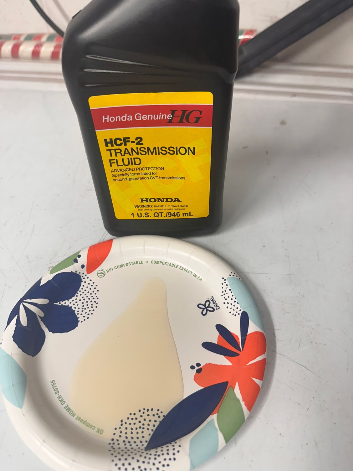

I just did my CVT fluid last week and I can’t re what came out of the bottle…. I have 200ML left over, I might as well go pour it out to confirm.
What came out of the trans was kind of dark. I only have 55k on the car and just bought it last month. Showed as being dealer serviced its entire life with no trans service.
