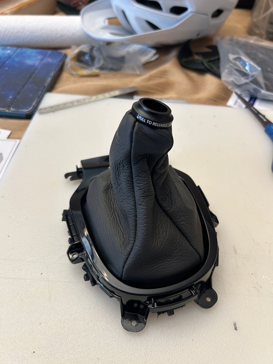

I went the DIY route:
1) Removed center console
2) Remove shift boot bezel and all staples securing the vinyl boot (several plastic tabs had cracks from the staples

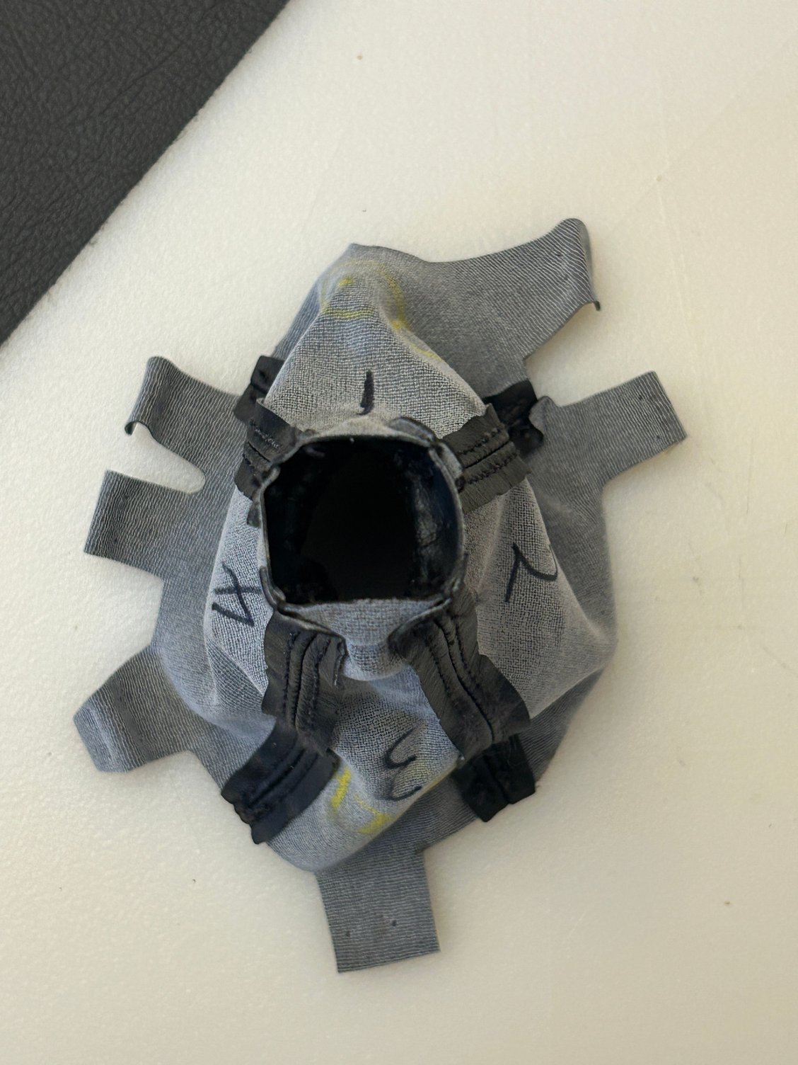

3) Label all 4 pieces, remove boot, then removed stitches from old boot
4) Use a steam iron and wet towel to flatten all 4 pieces of old boot
5) Trace each boot piece onto leather, cut and sew it up
6) Installed the aftermarket aluminum shift boot collar
7) Drill a single hole in each of the plastic tabs that were previously stapled to the old boot
8) Install new leather boot, using an awl to poke holes in the leather tabs and zip tie them to the plastic tabs
9) Reassemble center console and knob
If you get a generic aftermarket boot, just trace out the tabs onto the new boot and cut them so that they’re the same. Re-install and that’s it.
