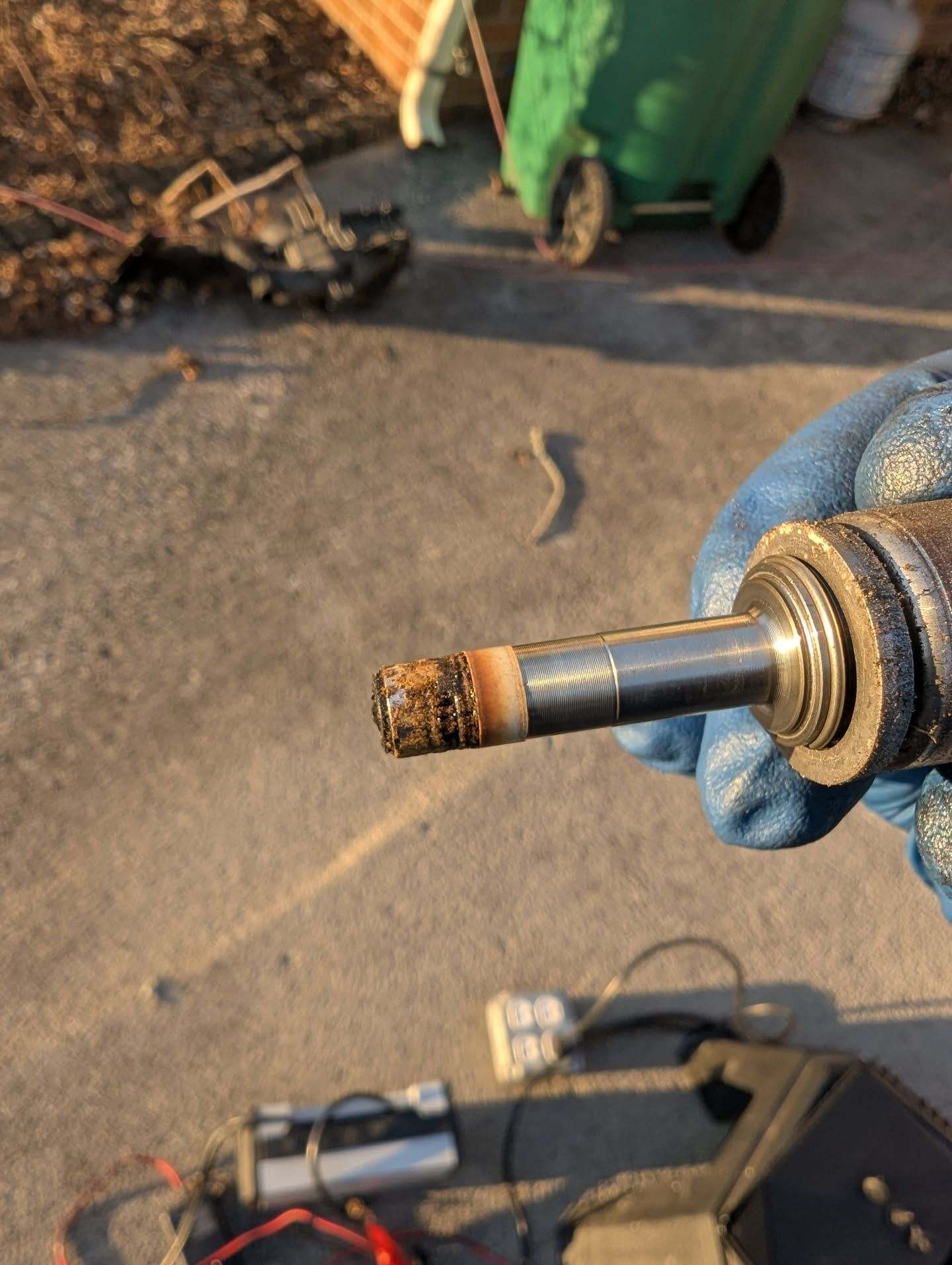

I successfully replaced the injectors on my 2015 Fit today, I wanted to share some info since I was able to buy OEM injectors in a kit and saved over $800. Car has 156k miles.
I ordered kit part number 06160-5R1-000 from here for $273: https://honda.oempartsonline.com/.../honda-injector-kit...
The normal 4 injector set found in the parts diagram is over $1100, p/n 16010-5R1-315 . I couldn't find much information confirming the kit I purchased was compatible. I wanted to share that the kit I purchased is exactly what is required and includes the following:
High pressure fuel line from the high pressure pump to the fuel rail. Honda states this is single use and not reusable - 16012-5R1-3150
Polyethylene glycol- required for fuel line installation
4x injectors, with seals and o-rings preinstalled - 16010-5R1-3151
Seal from throttle body to intake manifold - 17107-5AA-004
In addition I replaced the intake manifold gasket and PCV valve, part numbers Fel-Pro MS97618 and Purolator PV1088 respectively (RockAuto)
The job wasn't particularly hard, remove airbox, intake manifold, foam cover over fuel rail, and then remove the fuel rail and injectors. Reassemble from there. I followed the instructions from page 3-6 of the warranty extension service bulletin found here- https://static.nhtsa.gov/odi/tsbs/20...08198-0001.pdf
So far power and fuel economy seem to have greatly improved. Original symptoms on the car were 4 error lights including TPMS light, traction light, electric power steering light, and check engine light. All of these lights showed up simultaneously with no previous issues. The following codes showed when the car was scanned:

Car has 156k miles, updated original post and added photos of the injectors I removed
