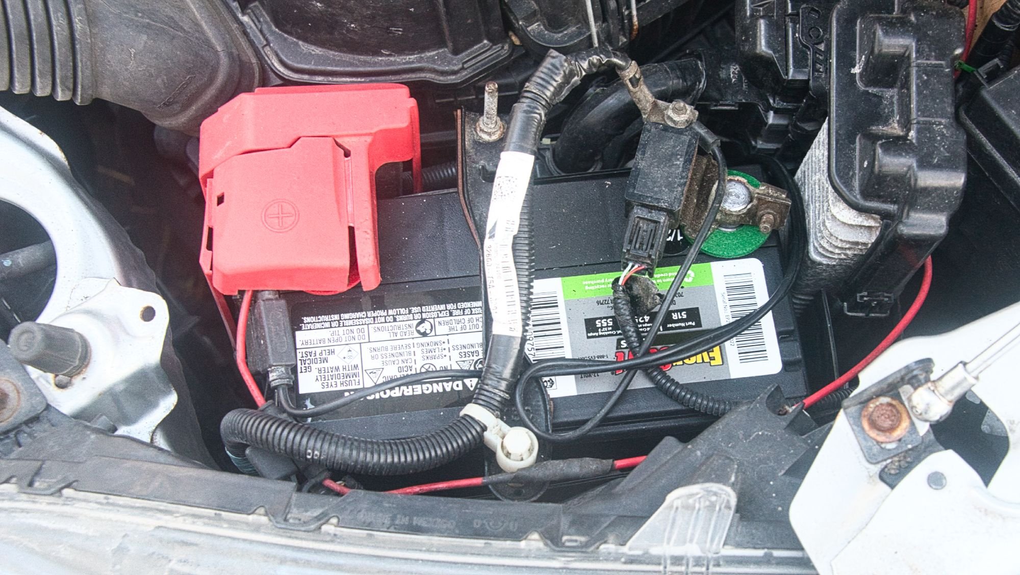

Whoopee! A new, larger, more powerful, cheaper battery.
By getting this larger 51R for my Honda Fit, I have a battery with 425 CCA vs 370 CCA of the standard battery. It also saved me $60. My car has a battery tray that lets the larger battery drop right in, but some Fits have to modify the tray or buy a new one.
The red wire runs to a fuse panel inside the car, and it's controlled by a switch so I can have 12v power when the car isn't running. The black fuse holder and black wire are for a Battery Tender smart charger.
That rusty bolt on the right is for a hydraulic hood support. I can't find one for my son's 2020, though. They don't seem to make them for the Fit anymore.

@SilverEX15 Sounds like a successful outcome. Could you post a pic of the entire engine bay?
Yes, I will. However, that will require me to change out of my pajamas and go out into the snow. 😂
