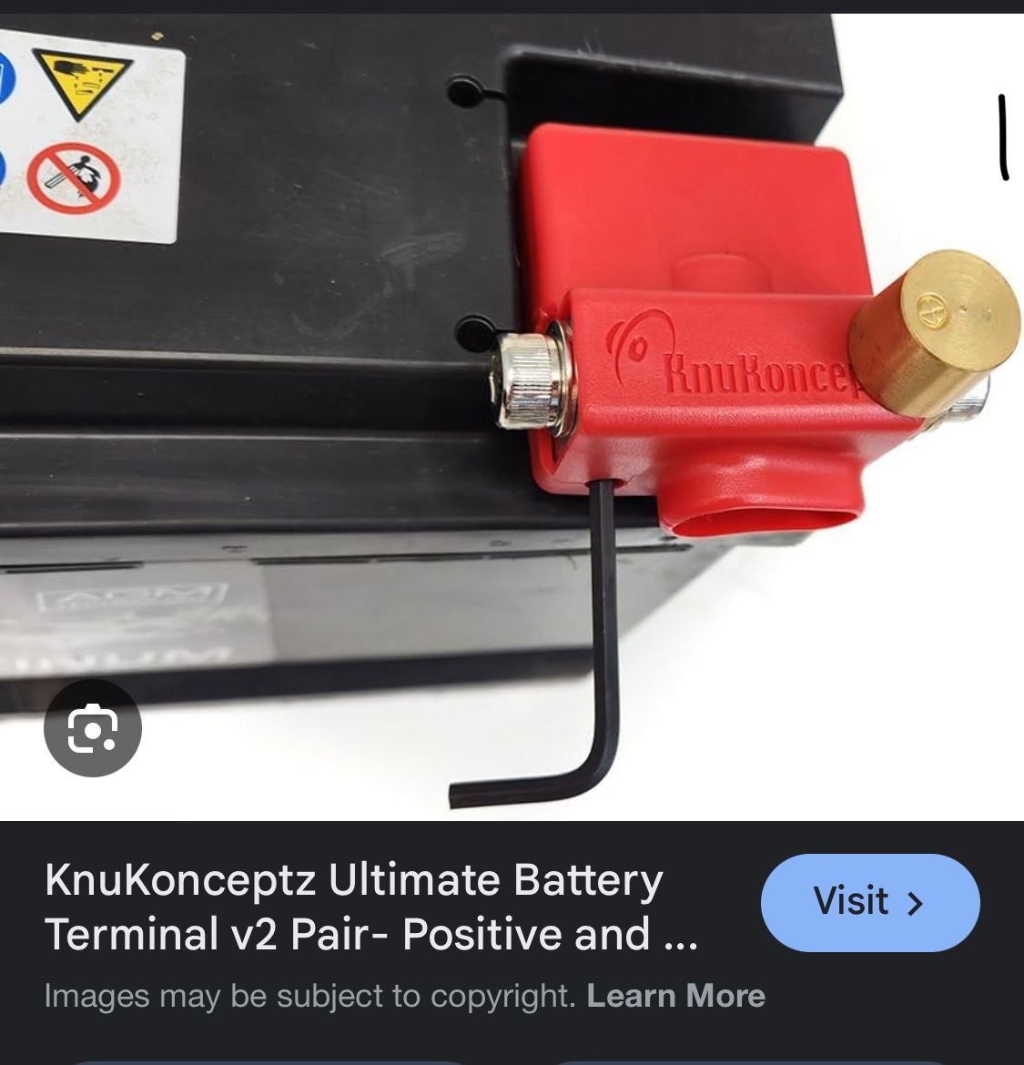

Get one of these Knukonceptz battery terminal jobby-doos and you can keep your positive cable and main fuse. Even with the 26R's stupid raised battery caps.
- Bill
ouu thanks for the suggestion!

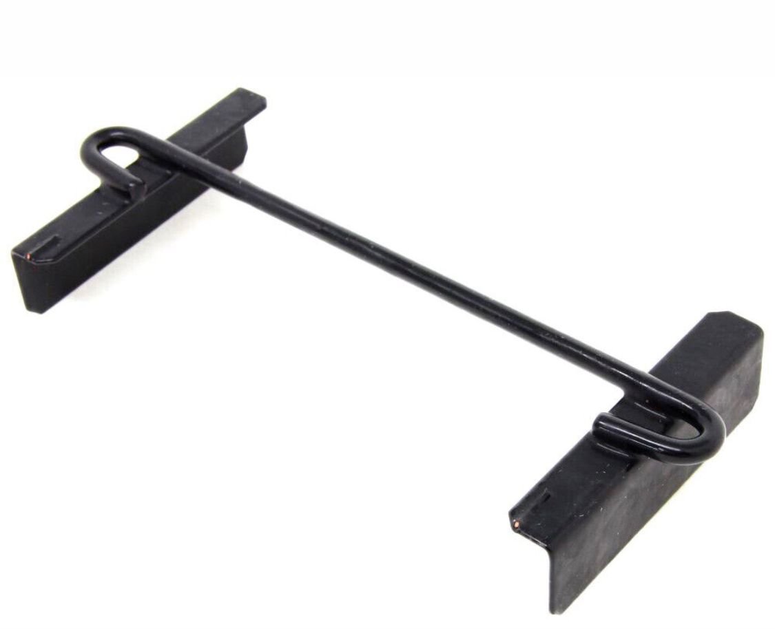

Also a Deka 00236 Universal Battery Hold-Down 6-7/8" Cross Bar Bracket
