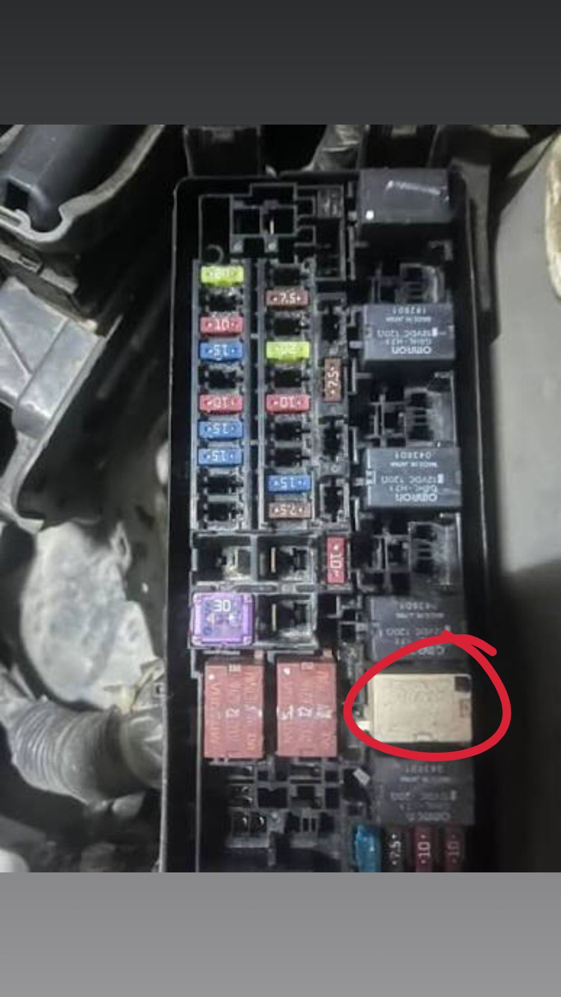

Okay here’s a problem that i’ve been dealing with for few months now. When i go to start my 2016 LX it makes sort of a whining screeching noise from under the hood, i have to turn the ignition back and forth to get it to start and after a few tries it does start. I’ve tracked it down to be coming from the under the hood fuse box and took a stethoscope and found out that it is one of the relays specifically the white denso one. So i assumed the relay failed so i got a replacement not name brand but the same relay, when i installed it the relay the result was the same just a different noise? So then i went out of my way to get the exact same relay and got the same result. I can’t wrap my brain around it so i thought id ask some professionals! Help me! (Also i have attached a photo of the specific relay.)

Maybe the thing the relay is trying to activate is the problem. When power is applied to the relay, it oscillates back and forth, trying to make the device work.

what happens if you completely remove the relay?

If its key start, i would guess the ignition SWITCH..that you seem to need to jiggle, ....is not supplying enough power to make complete contact, only vibrate the relay,that may be a main /fuel relay. Disconnect the battery and move the ignition switch around a whole bunch, including crank position, on, off, etc..... now try, I also sense you either drive very little, or are a courier, but not an average driver (user of car), nothing to do with your driving.

Old Apr 1, 2026 | 12:21 AM
bobski's Avatar
Joined: Nov 2024
Posts: 580
From: Delaware
The without-keyless-access diagram:
The circled relay is the "Starter Cut Relay".

When i completely remove the relay the vehicle doesn’t make the noise (because the relay is the cause) but doesn’t turn over.

The way the relay is wired, the power for its coil and its load contacts come from the same wire. If something up-stream on the green wire is limiting current, turning the key to Start could cause rapid cycling of the relay - an irregular buzzing or whining sound.
Skip down a paragraph if you don't care why it's happening. Turning the key to Start will first energize the relay coil (because it takes very little current to do so), but as soon as the relay's load contacts physically close, the resulting electrical connection to the starter solenoid (which consumes 10s of amps) sucks up all the available current, making the voltage on the green wire drop to near zero. That drop de-energizes the relay coil. The spring inside the relay takes over, pulling the load contacts back to their resting position, breaking the electrical connection to the starter solenoid. With the available current no longer being hogged by the solenoid, voltage on the green wire jumps back up to near battery voltage, and the cycle repeats. The speed of the cycling is limited only by the momentum of the relay contacts, so it can happen 10s or 100s of times a second, depending on the relay design.
The root cause of the problem is a restriction on the power supply for the green wire.
The wire loops through the dash fuse box - probably a convenient way of connecting the harnesses - you could track down the terminals at the fuse box connectors, but I doubt that's the problem.
Next is the ignition switch, which is a wear item. The electrical contacts inside the switch wear down over time until they make poor contact, causing strange behavior. The starter engaging after turning the key multiple times fits right in here. The switch is replaceable separately from the lock - it just unplugs and unscrews from the key cylinder on the steering column.
A partially-blown fuse (Fuse 1-2 in the auxiliary dash fuse box, or Fuse 1 at the positive battery terminal) is possible. Fuses with dashes in their designators are part of a multi-fuse block (bar-shaped order-from-Honda part). IIRC, the battery terminal fuses have screw terminals - a loose screw is possible. Neither of those provide much explanation for the multiple-key-turns observation.
So - check for loose screws at the battery terminal, replace the ignition switch. If you have more time than money, you could try disassembling the switch to clean it, re-lube with dielectric grease.

Im gonna go make sure everything is tight check for loose screws/bolts check the wiring from under the fuse box to the starter if i find any short. You also mentioned potentially a partial blown fuse in the auxiliary. where would i find this fuse on the vehicle i have a test light to test the resistance and all that good stuff. will update momentarily.
