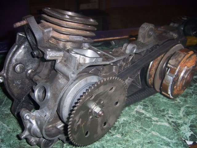

My scooter's cvt is its strong point, at least in terms of ease of operation and I don't miss manual transmission bike. The scooter offers plenty of excitement and fun while riding it without needing to shift manually.
When the belt wears out, however, it becomes narrower and is not able to run as high between the cones as the newer belt, resulting in decreased top speed. The longevity of belts varies dramatically and depends on the driving conditions. The belts on the scooter may last anywhere from 2-3K to 15-20K miles.
I wonder what the belt on CVT Fit is made of.
Automotive CVT transmissions work on the same basic principles as the variator transmissions on scooters, snowmobiles, etc. it consists of a belt running between two adjustable pulleys. The sheaves of the pulleys move apart and together to change the diameter of the pulleys. There are a few differences between a variator and a CVT. The differences are:
1. A CVT belt is metal, not rubber.
2. A CVT is sealed in a housing and runs in a lubricant bath.
3. A CVT has a more sophisticated electronic control system.
The purpose of a transmission is to keep the engine at the optimum RPM for either power or econony. Any stepped transmission is a compromise because the engine varies above and below its optimum RPM. In order to minimize this, engineers add more and more ratios to the transmission. This makes the transmission more complex and, if it is manually shifted, more prone to shifting errors that reduce efficiency. In F1 racing, manual transmissions are actually required so that drivers will have more opportunity to make mistakes!
A CVT, OTOH, has the ability to automatically select any ratio. It can keep the engine at a single, efficient RPM while the vehicle accelerates or cruises. Some people who do not understand this principle interpret this as "droning" or "slipping." Some manufacturers even go to the point of creating fake "steps" in the CVT ratios to help people who are used to older gearboxes adapt.
Obviously there are those who love controlling their own drive ratios just as there used to be some who enjoyed controlling their own spark advance and fuel mixture. I happen to enjoy shifting and the three cars I own are all sticks. I'm also an engineer and recognize when a better idea comes along. For most people that is the CVT.
