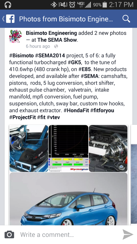

No clue where that reporter got 151hp..
This is wht Bisi posted on FB:

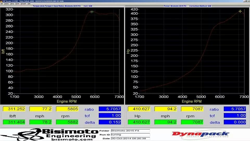

Edit:
They shared the full dyno sheet!!!

410 whp is a ton for this engine. I am sure the internals were massivley upgraded to hold it. If you look at that dyno, as with most huge turbos in small motors, you don't get a lot fo power until a rapid spike pretty high up there in the RPMs. Doesn't seem like a very useable 410whp. I floor mine and it doesn't ever really get up close to redline at all so I'm not sure I'd ever see that power with the CVT.

Ah, finally! Here's the release from Honda with the tech specs provided by each tuner. Honda Vehicles at the 2014 SEMA Show - Honda.com
Looks like that 151hp is a "crank horsepower" figure for Bisi's Spec GK.

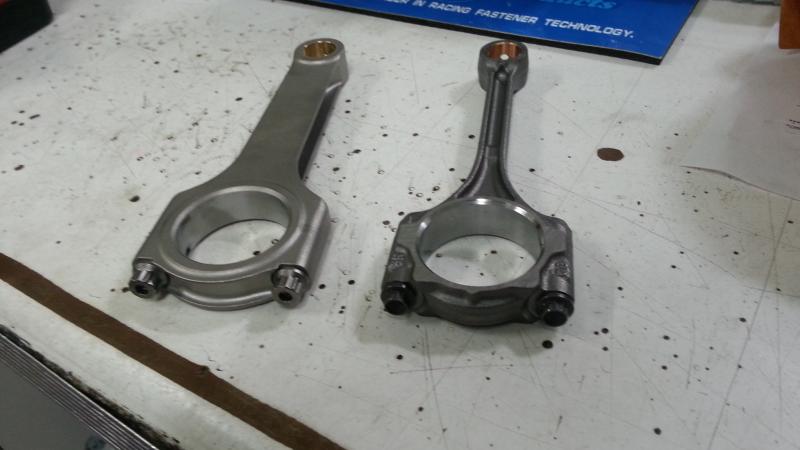

The earthdreams concept from Honda is wonderful: excellent emissions, light weight components, and good fuel economy.
For us power fiends, the lightweight components are not ideal. I perform failure analysis on factory components, and my stress data shows that with the average tuner, no more than 40 to manybe 50whp per cylinder is ideal, with the weak points being the rod bolts and then the upper beam section.
The photo above shows the Bisimoto spec rods used in my SEMA build, vs. the factory connecting rod.

When you say no more than 40-50 per cylinder, do you mean the engine as a whole probably won't be very reliable with just 50Hp more than stock? (sorry im kinda ignorant at this stuff).

No worries. That translates to 180-200whp, without much margin for tuning error: no crazy detonation, over revving, or lean mixtures.

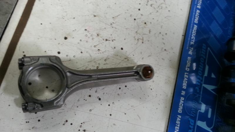

This is another photo that may shed some more light on how puny the factory rods are:
Factory on top of Bisimoto!

Damn those are small, so but it seems with some light horsepower modifications (50+) or so these should suffice?
Do you think (in your professional opinion) they are strong enough for a slightly above stock HP engine?

Yes, and yes.

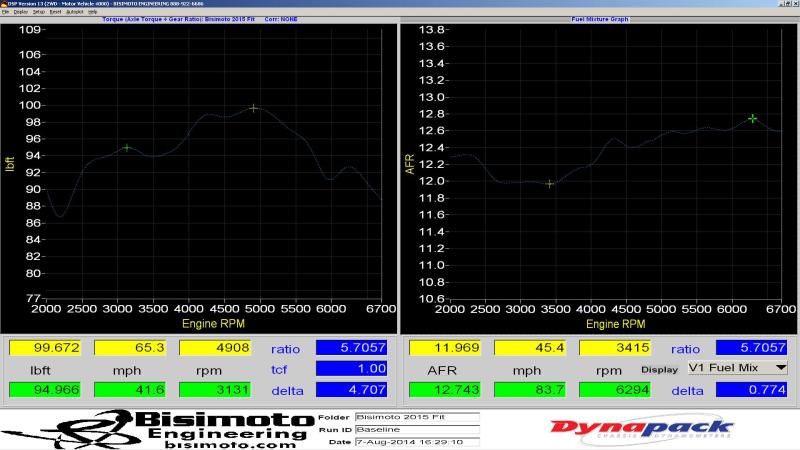

I will provide more clarity, somewhat redundant:
I am a bit confused to your 30whp comment. The factory fit makes 130hp (113whp) to the crank, and I was able to extract 151hp (129whp) with modifications, which did not involve manipulation of the factory ECM. Exhaust mods, indexing of spark plugs, and advanced synthetic lubricants (yes, oil is performance adder) where my changes to the spec Bisimoto Fit.
In addition, it is apples to oranges to compare multi point (port) fuel injection to direct cylinder injection as the requirements for fuel (power and safe lean economy) change dramatically. With DFI, you could run as lean as 14.0:1 in boosted applications, and as lean as 17:1 in cruising for optimal economy...safely, I may add. The "plume" formation in the combustion chamber, aided by the unique DI friendly piston top shape, also lends to this phenomenon.
With that in mind, this is what a factory GK fit depicts:
You could even clearly see the torque depressions in the lower RPM ranges due to relatively "richer" mixtures, and the VTEC crossover up top. The iVTEC also has some pronouced effects.
I hope that helps, and clears up any misconceptions.
