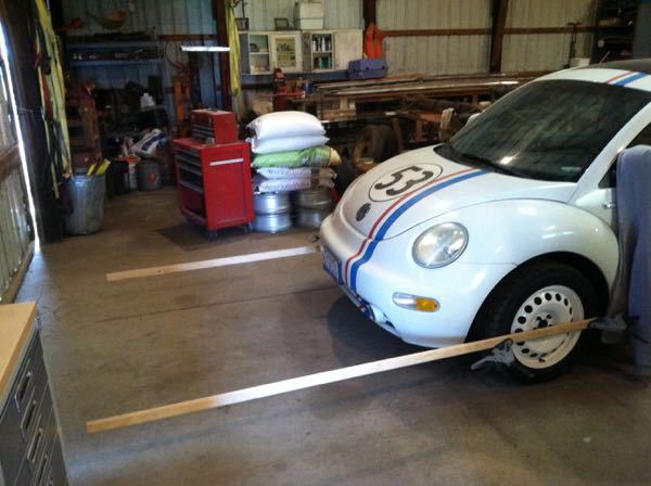

Originally Posted by JN2k108
No toe plates?
I had just rebuilt the whole suspension (200,000 miles had worn it out!), and did a rough toe-in using lathe as shown in the pic so I wouldn't be adversely wearing out my new tires. The toe was actually within spec (barely) when I took it to my local shop for the full alignment.
es

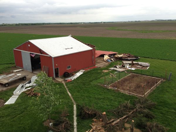

Originally Posted by Vanguard
I am on a farm on the side of a valley, and the wind really picks up during storms

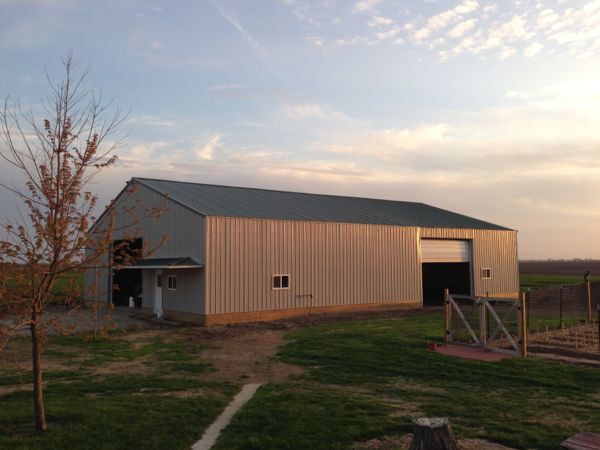

We get a bit of wind here in the Middle West, too:
My shop is in the front part of the shed, and is probably what kept that part from blowing away, as it's structurally tied to the outer wall. The contractor didn't start the rebuild until December of last year, so I had a wind tunnel through the worst of the Winter months. I'm happy with the rebuild, though - took the opportunity to upgrade the doors, etc.
I got my workbench, cabinets and one of the rolling cabinets from Sams. You can order more pieces direct from the manufacturer (higher cost).
And then you can put your tools on them while you're checking your alignment (to bring this somewhat back on topic)!
