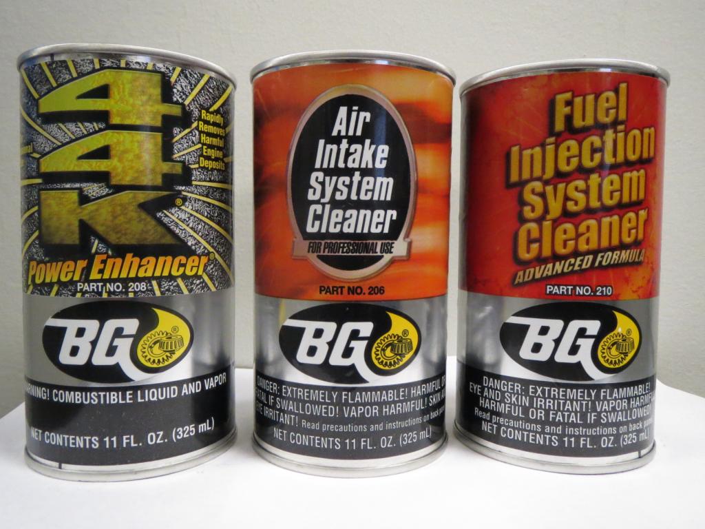

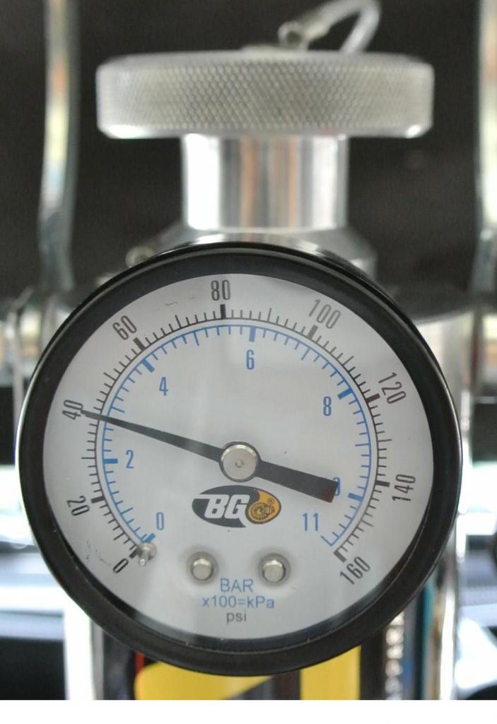

You are one of the very few here, in not the only one, that I see as who understands the DI system and somewhat knows about this problem, and why this is happening on DI gas engine but not on DI diesel.
And this problem is NOT a BS like some are saying. This has been happening on many DI gas engines, especially on Ford's EcoBoost DI engies. All that dirty oily fume is reintroduced back into to the intake system via PCV/EGR because crankcase is always at a positive pressure when engine is running. Thanks for your research about he Earth Dreams' improved EGR/PCV system.
Here is how I do intake cleaning on my other cars.
