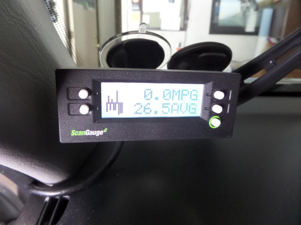

I have my SG set to display:
1. engine temp
2. instant MPG
3. current trip MPG
4. tank MPG
Those are just the 4 gauges I display on my unit. I then scroll through the other info as needed (e.g. gallons used, gallons remaining, max RPM for the trip or for the day, etc)
My SG is mounted front and center on my steering column and does not block anything on the Fit's instrument panel. There is no doubt in my mind that without the immediate feedback I get from the SG, my MPGs would suffer quite a bit.

I had to go without for a few weeks in my last car- I mailed the UG out to get its software upgraded so I could hit the ground running with the Fit. I lost a bit, but the Gauge had alreay taught me enough about the car that I did almost as well as with it.
Is Tank MPG same as Avg MPG?
If not, can you post a photo of your SG screen showing the above 4 parameters?
I scrolled through my SG a while ago but don't remember seeing those. Maybe I missied them...
Thanks!
