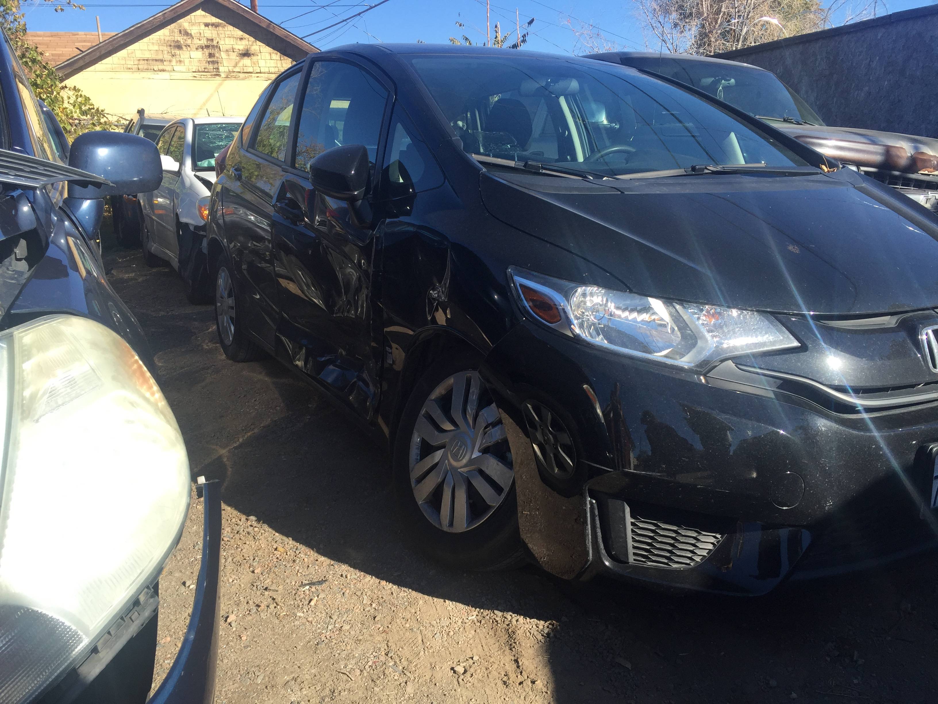

photo album of just after the collision: Imgur: The most awesome images on the Internet

mad camber yo!
