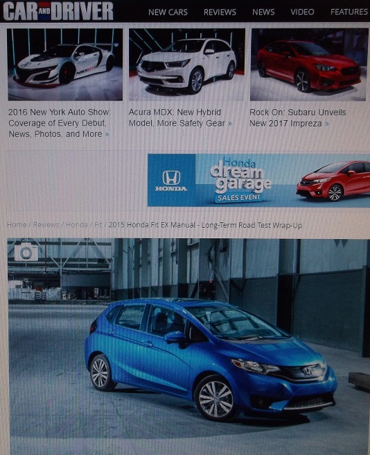

Found this at CARandDRIVER about having warped brake rotors resurfaced under warranty at 32,500 miles during their Long Term test drive of a 2015 EX manual , 2015 Honda Fit EX Manual ? Long-Term Test Wrap-Up ? Car and Driver . Click pics to enlarge .

Old Mar 28, 2016 | 04:58 PM
  #46
2015FIT's Avatar
Joined: Jan 2015
Posts: 178
From: Houston
Thanks for the link. I certainly hope that the warping issue is not widespread, and certainly hope that it doesn't occur to me.

Welcome . They probably did it under warranty since it was CARandDRIVER . Any other person ," it's normal thanks to nature , pay up " .
