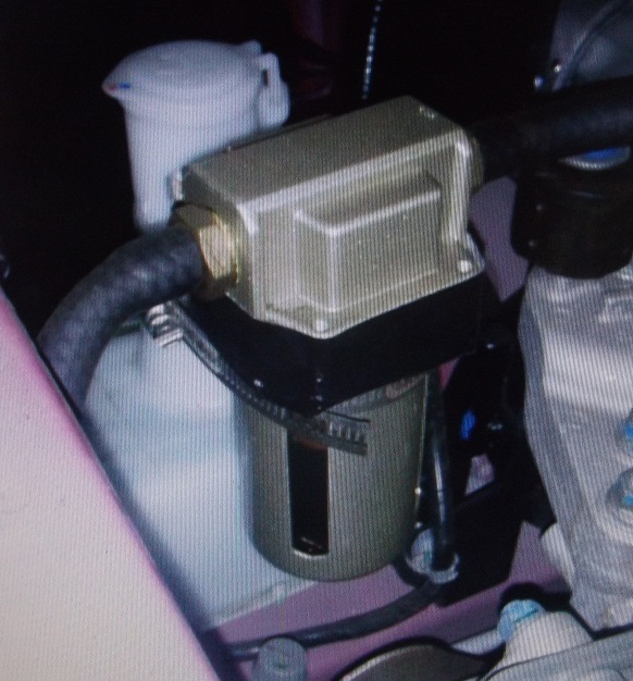

Vanguard , this was a topic on GOSS' GARAGE about a month ago . Talks of using a catch can . Says not to high rev . This is also being discussed here , 6,650 Mile Oil Catch Can Results. - MirageForum.com .

Pictures of catch can installed in a 2014 Mirage .

Catch can for blowby? It would take a heck of a lot of oil blown by to create significant buildup on the intake valves. Enough that oil consumption would be really high. Certainly not a situation you see with a new engine!
