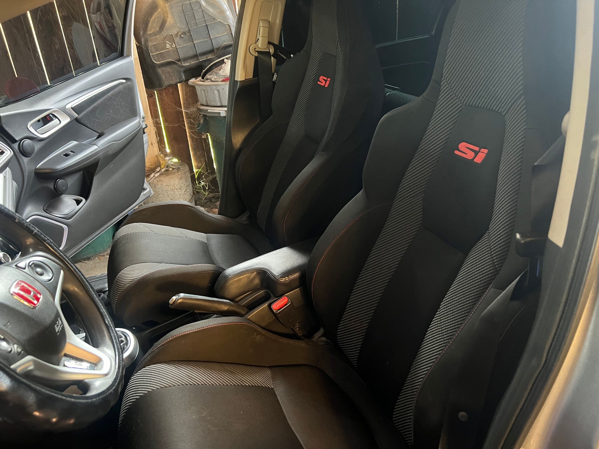

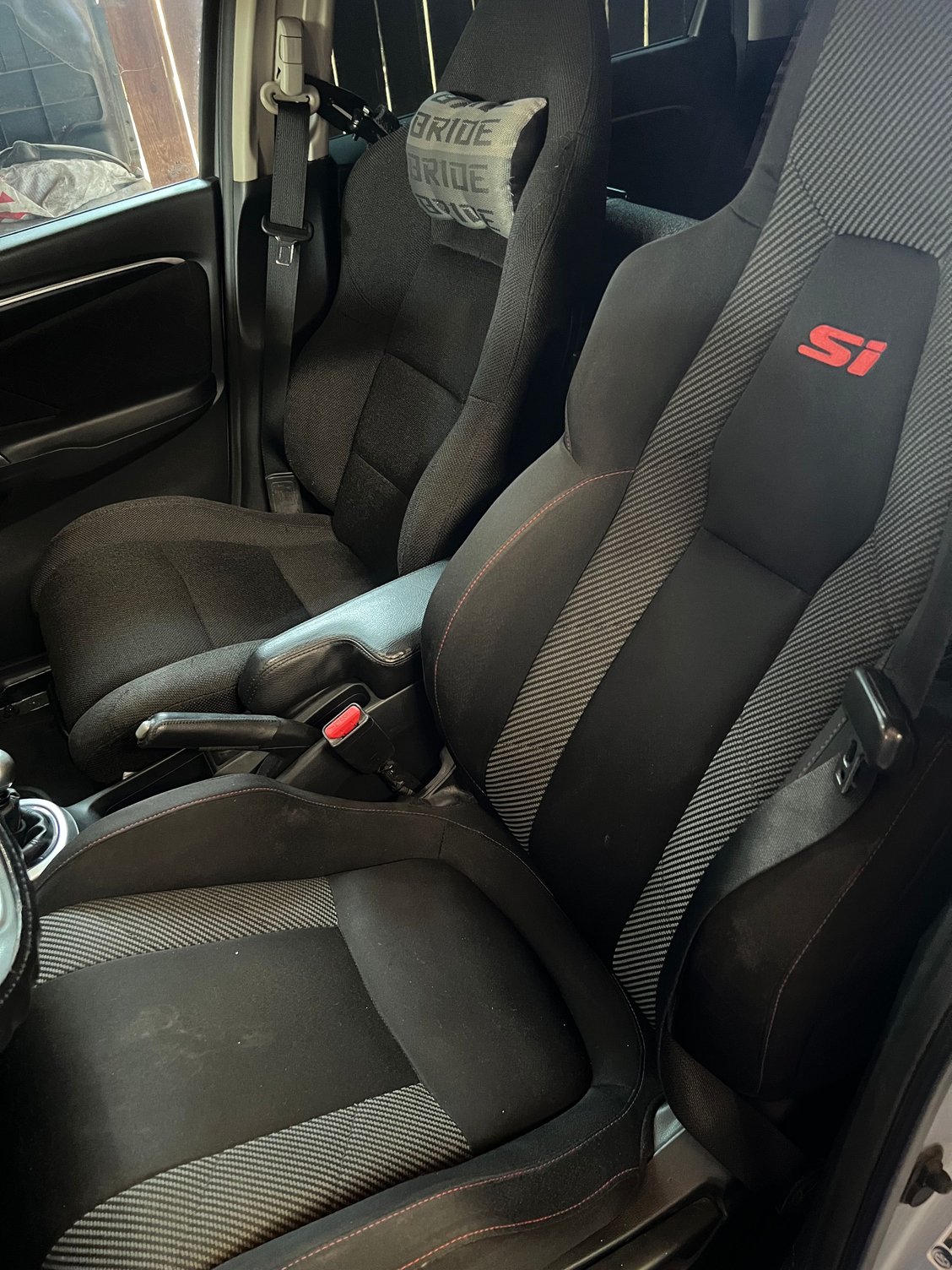

Gk5 the 2018 civic si fit with modifications you have to cut rail bolting mont point and bolt that right up to a aftermarket rail you just have to make sure the wait sensor from the fit are there air is a direct fit seatbelt direct fit everything should be plug a play

@Elpapas do the air bags plug in without throwing a an airbag warning light? I also have a GK5 and the same set of Civic Si seats as you, but procrastinated putting them in so far. Is there a weight sensor on the drivers side or only the passenger's side? Any extra info you could share on the install would be super appreciated .
