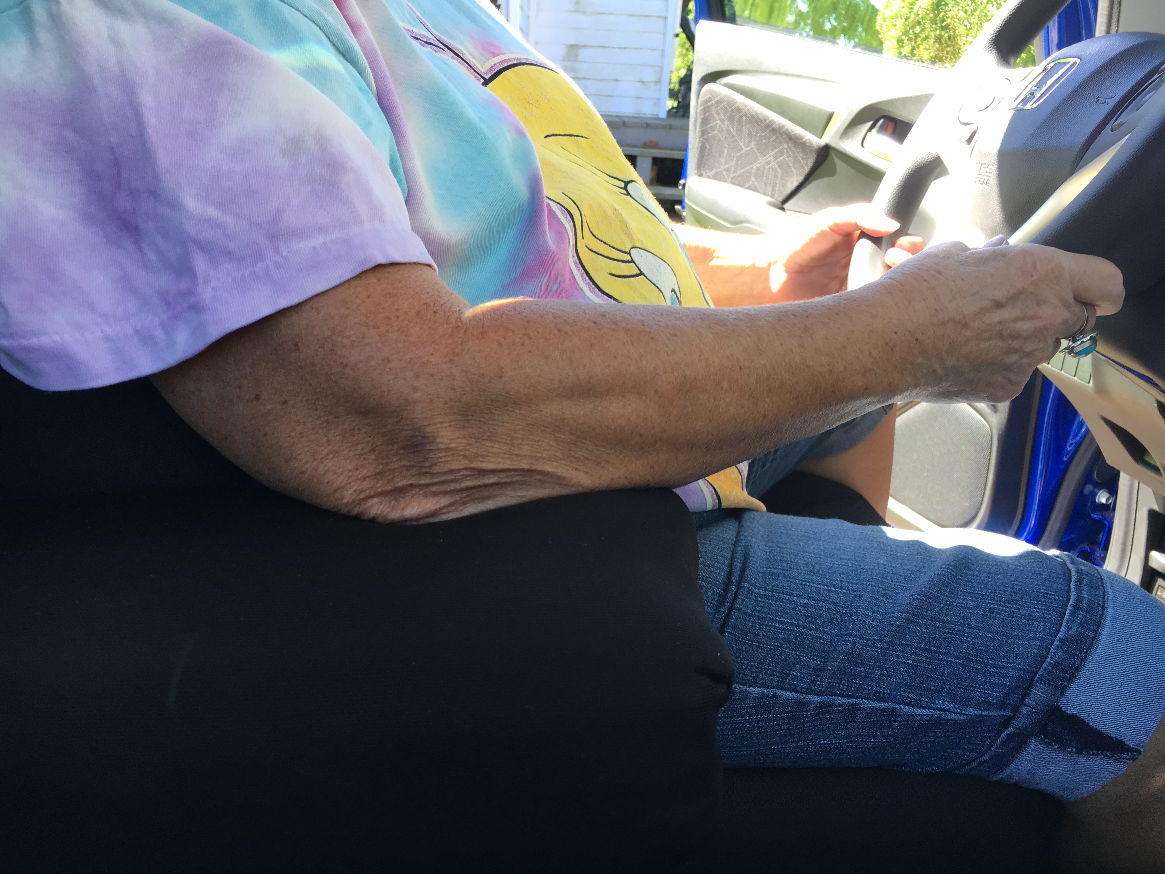

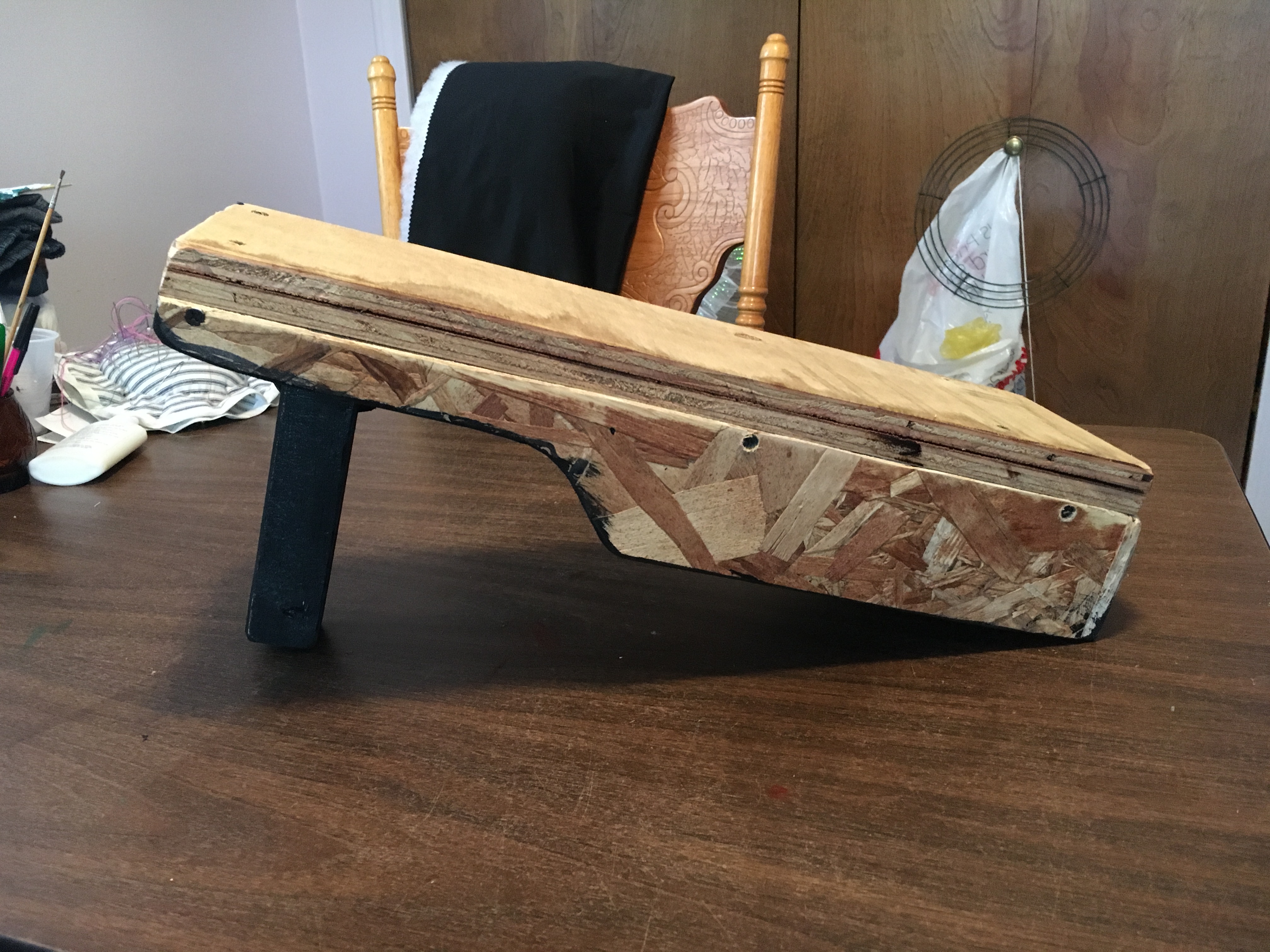

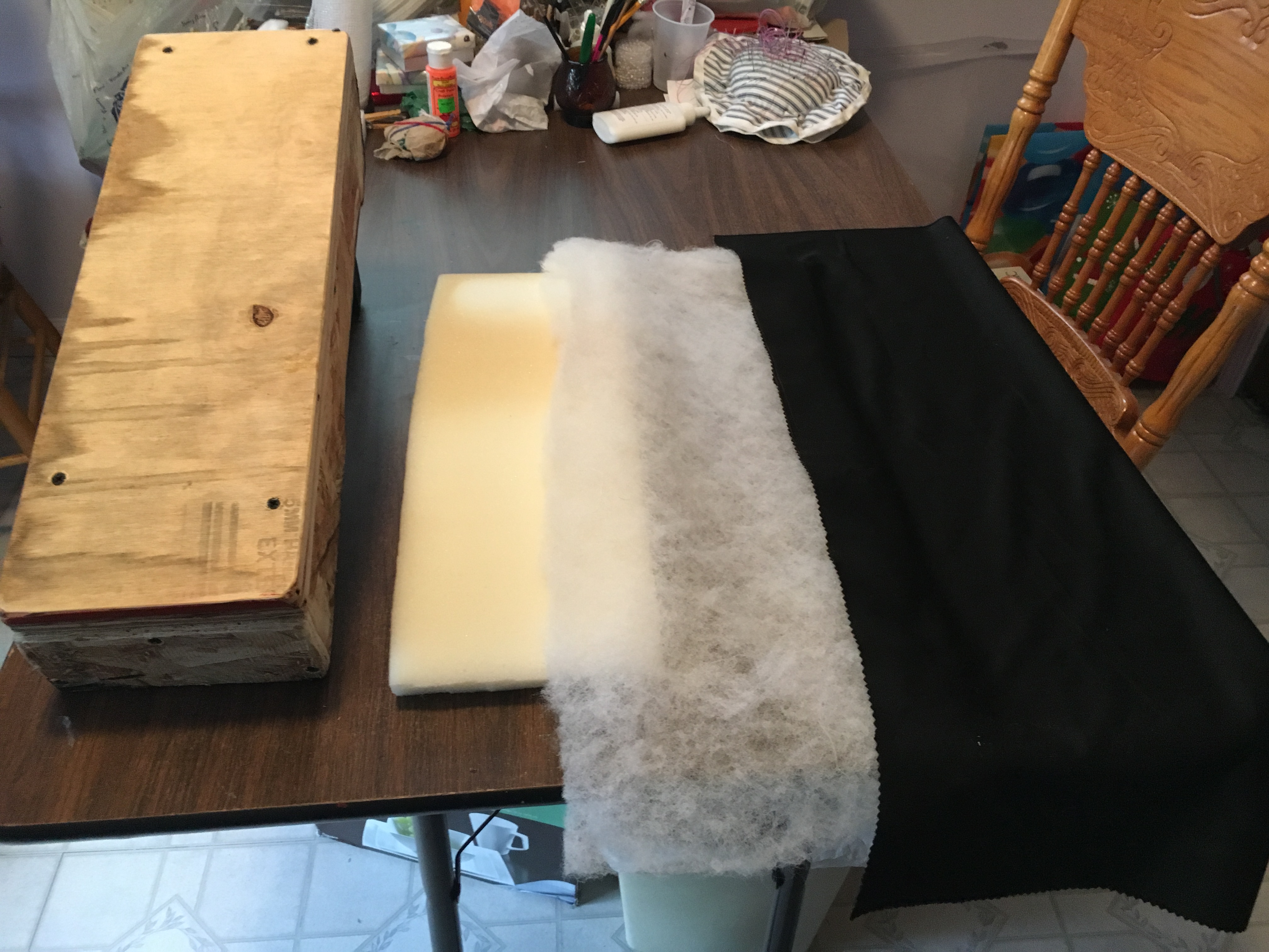

Attached are pictures. It is easily removable - just sits on top of existing arm rest with pillar resting in little square pocket where the seat heat switches would be if it was an EX-L. I thought we would only use it on long trips but is so comfortable we may leave it in full time. Plenty of room for the shift lever. It makes using the parking brake a little awkward but is doable (we don't use it much anyway - we are on flat land)

It is made from 1/2" OSB plus the 2x2 pillar. The top is 3 boards stacked to get the height I wanted (the middle one is hollowed out to save weight). The length of the pillar allows the front to be higher than the back to provide clearance for the parking brake. It is basically a box that fits snuggly over the existing armrest with side cutouts to clear the cords coming from the connections in the console compartment. It is covered with foam, polyester fill and black cloth stapled to the underside edges of the "box" so no staples are rubbing against the existing arm rest. There are 2 staples in the front edge and 3 in the back that are visible but I painted them black so they really don't show much.

I'm 5'8" and my wife is 5'2". If you don't swing your arm over to the rest it is not in the way. For long drives the arm goes on the rest and the hand at the 5 o'clock position on the wheel.
