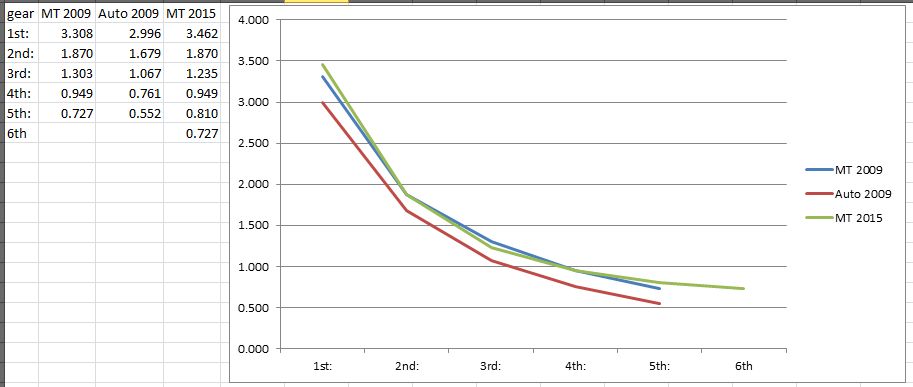

Just putting this gear ratio discussion in perspective with a graph. Really, hardly any difference between GE and GK for manual transmission.

Yes, Honda made a mistake in the MT gearing ratios as has been brought up a number of times in this forum. Unfortunately, even if they are aware of the issue I would assume there is no money (or desire) available to change this - the suits are not going to touch the engine/transmission mid term unless there is a serious safety/reliability issue which this isn't. The GK is pretty much locked in as until the next major redesign when everything is on the table. That's several years away.

My wife drove our (new to us) 2009 GE 5sp MT (manual trans) back from work over the mountains yesterday and commented that she needed a gear between 4th and 5th for the hill. I chuckled and said the latest generation GK has that 'inserted' gear. She said for that hill, our GK CVT did much better.
So, it seems that for the GK MT owners, that extra gear (5th) can come in handy even if you have to skip it during normal flat ground around town driving.
Just FYI for those trying to decide on the GK MT vs CVT debate. Either is a good choice in my opinion.
