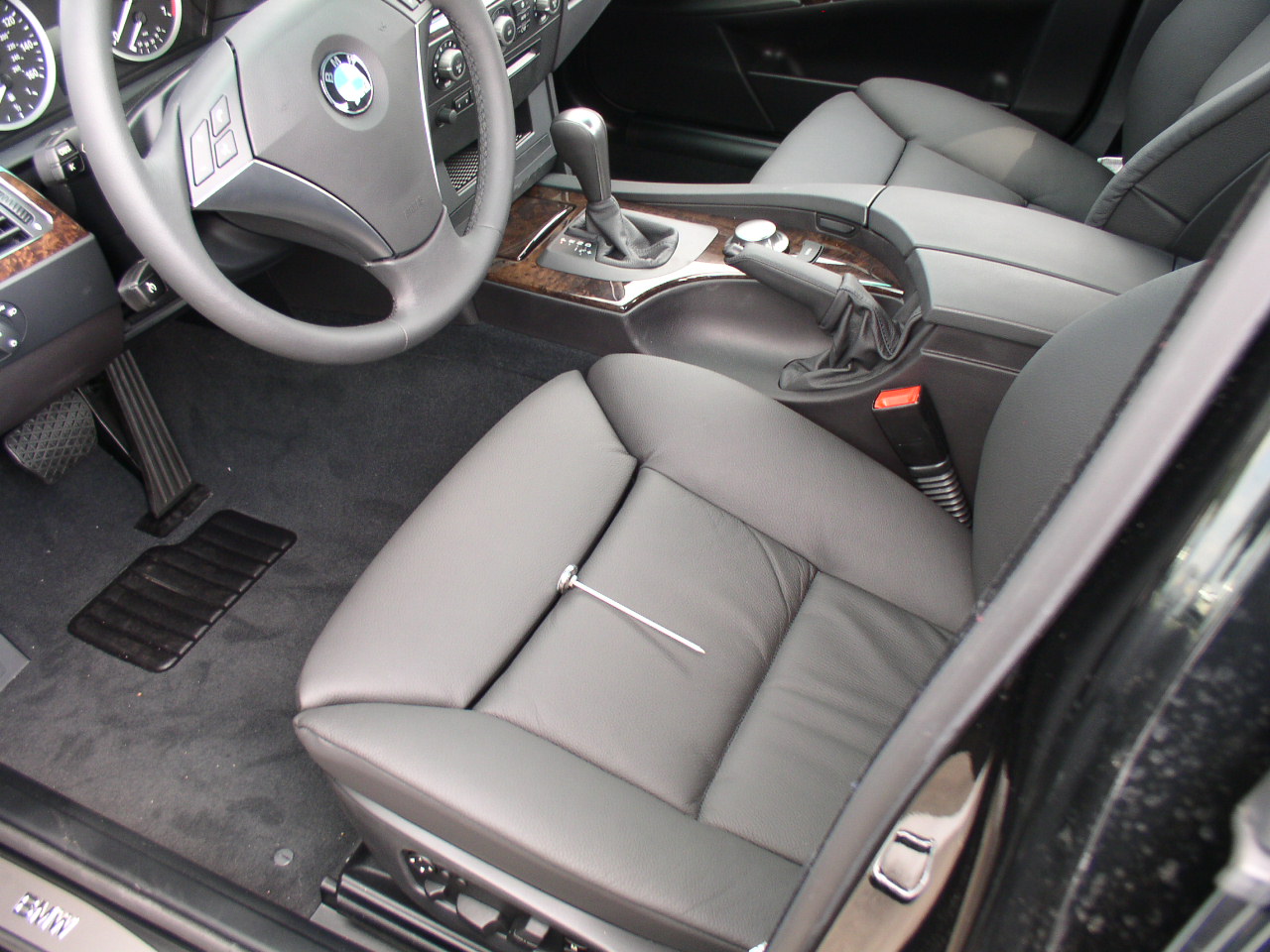

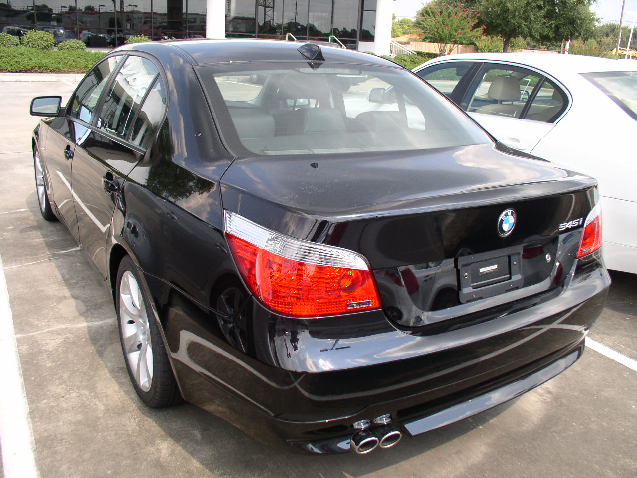

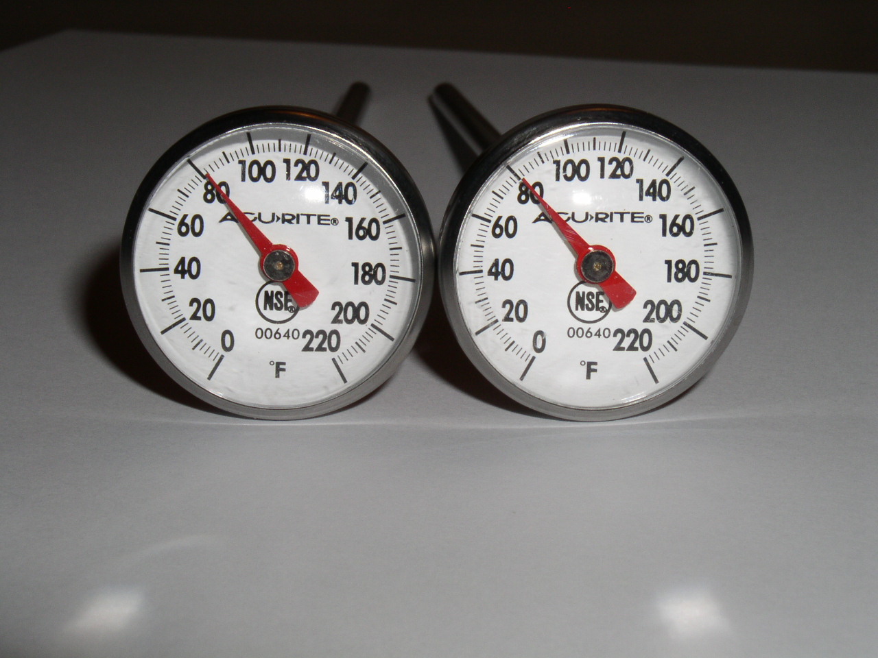

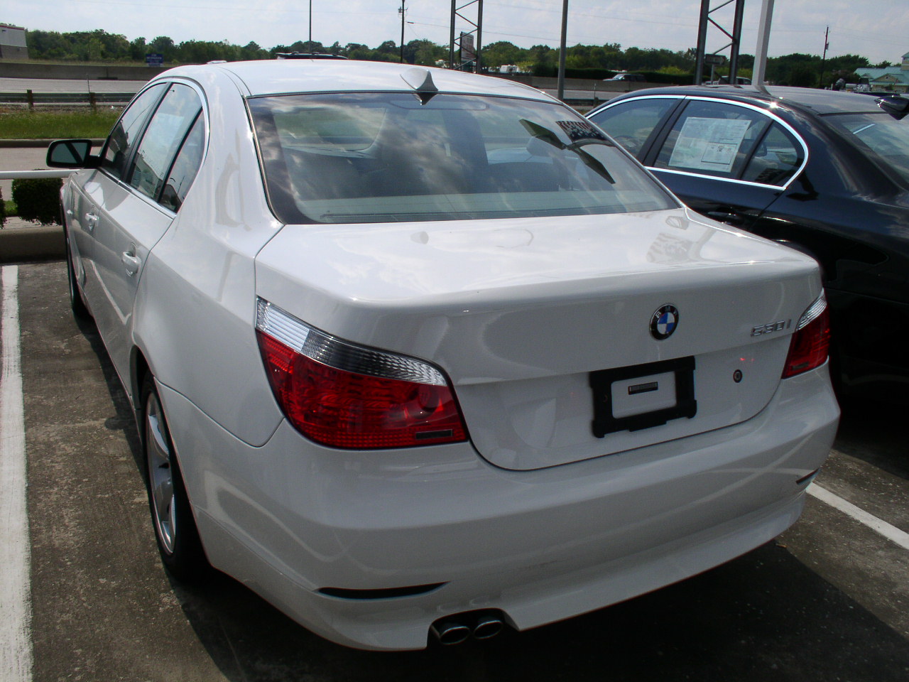

Maybe a little off topic, in 2004, I did an experiment at the local BMW dealer, not rigorous, but it shows a point the temperature inside a white and a black BMW. Most of the heat comes through the windows and some comes through the roof. Yes, in theory the white car should be slightly cooler because the white paint reflect solar radiation better than black paint. Both absorb and emit about the same amount of heat.
Here is what I did:
Houston had been relatively cool this summer, so I waited until today, Labor Day, to conduct my experiment. When I arrived at Advantage BMW in Clear Lake, the OBC of my 330i read 96 deg F. The time was 3:15 pm. I convinced a salesman to allow me to conduct my experiment. He introduced an E60 white 530i with tan leather seats, and an E60 black 545i with gray leather seat. I placed a thermometer on each driver’s seat and waited for about 15 minutes. The thermometers were not in direct sun light as you can see. After 15 minutes, with the salesman there he read the temperatures with me. he was surprised that both thermometers showed 136 deg F. From this simple experiment I concluded that this black car is not hotter than the white car when the ambient temperature was 96 deg F on a sunny Houston day. I am also convinced that the temperature inside of the car is caused mostly by infrared heating just like the inside of your oven where everything turns to the same temperature given time.

Your experiment is interesting. I've found other experiments counter to your results:
I want to say "Mythbusters" did an episode on it and also confirmed the white car was cooler.

Right off the bat, the outside temperature was 95 deg and the white car showed 115 deg. The white car should definitely be higher be than 115 deg in a 95 deg sunny day. I am sure their test is less rigorous than mine. I do not discount that the white car reflect more than the black. I have indicated that in my experiment too. But, most of the heat is coming through the windows. Did autotrader test allowed both car to be at the same angle to the sun? and did one car shaded the other after 2 hours? Did the thermometer read the same, and had the same accuracy? I checked mine and they did not indicate their two thermometers were trust worthy. We don't know that. In my test, the two BMWs were already baking in the sun for more than 2 hours. So, the assumption is that the interiors have reached steady state. Did autotrader baked the cars for longer than 2 hours, or did they pull up after it was air conditioned? I agree the white car should be cooler simply because the white reflects more radiation. How much? Depends on the absorption-emissivity ratio of the types of paint and the shiny clearcoat.

I doubt there was much shading judging from the shadows on the video.
Here's a video from Houston and a BMW dealership that did a similar test with findings that a white BMW was cooler than a dark colored one:
There are a lot of variables to consider. Even the construction of the car can make a difference. I think the point is that theoretically, the white vehicle should be cooler than a dark one if all things are equal.
