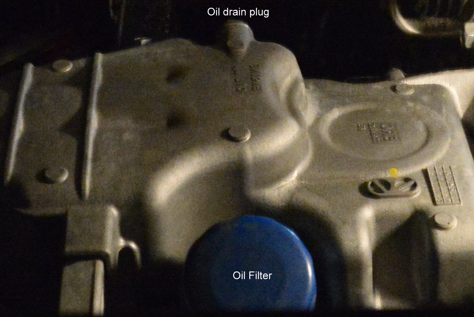

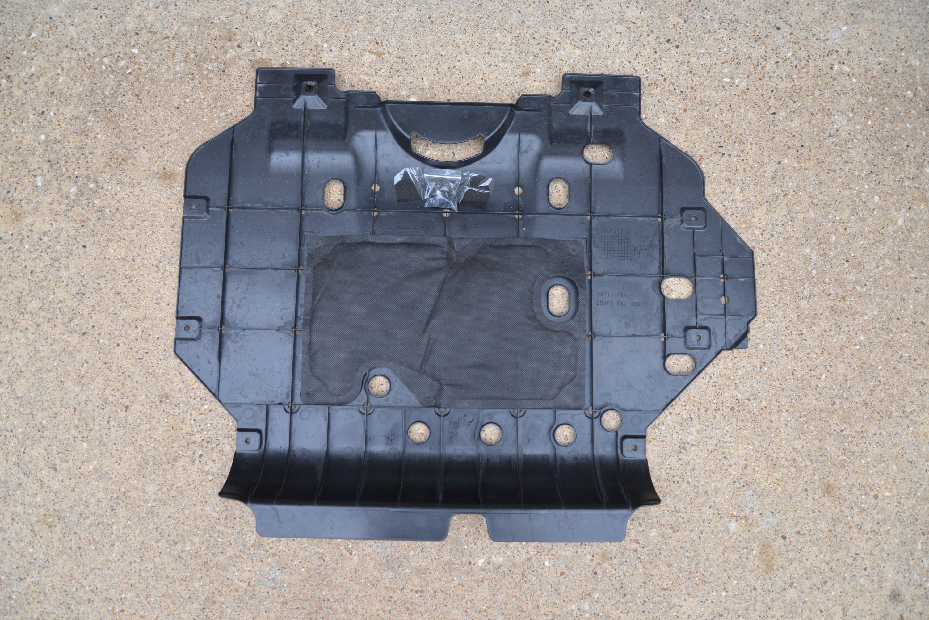

The solution to the under cover is not reinstalling it after the first oil change. You will soon get over the shock of leaving this useless part off permanently. Now, I can reach the oil filter (pic shows mirror image) and plug from the front of the car without having to lift the front end for the next oil change. As in my BMW (9 qts), I can probably change the oil (3.3 qt) and filter in 15 minutes or less. The longest part of the process is to allow time to drain the oil. Another recommendation is to line your oil drain pan with a 15 gallon plastic trash bag. When you recover all the old oil tie a knot at the top of the bag and take oil along with the drain pan that was used for support to the oil recover station. Pinch or cut a hole at the bottom of the bag and let the old oil drain into the recovery drum. Now, your drain pan is clean without residual oil. That is nice not having to clean up. You paid the price with the 15 gallon plastic bag.
I fill old 5-qt oil containers with the drain oil and bring them to recycling.
