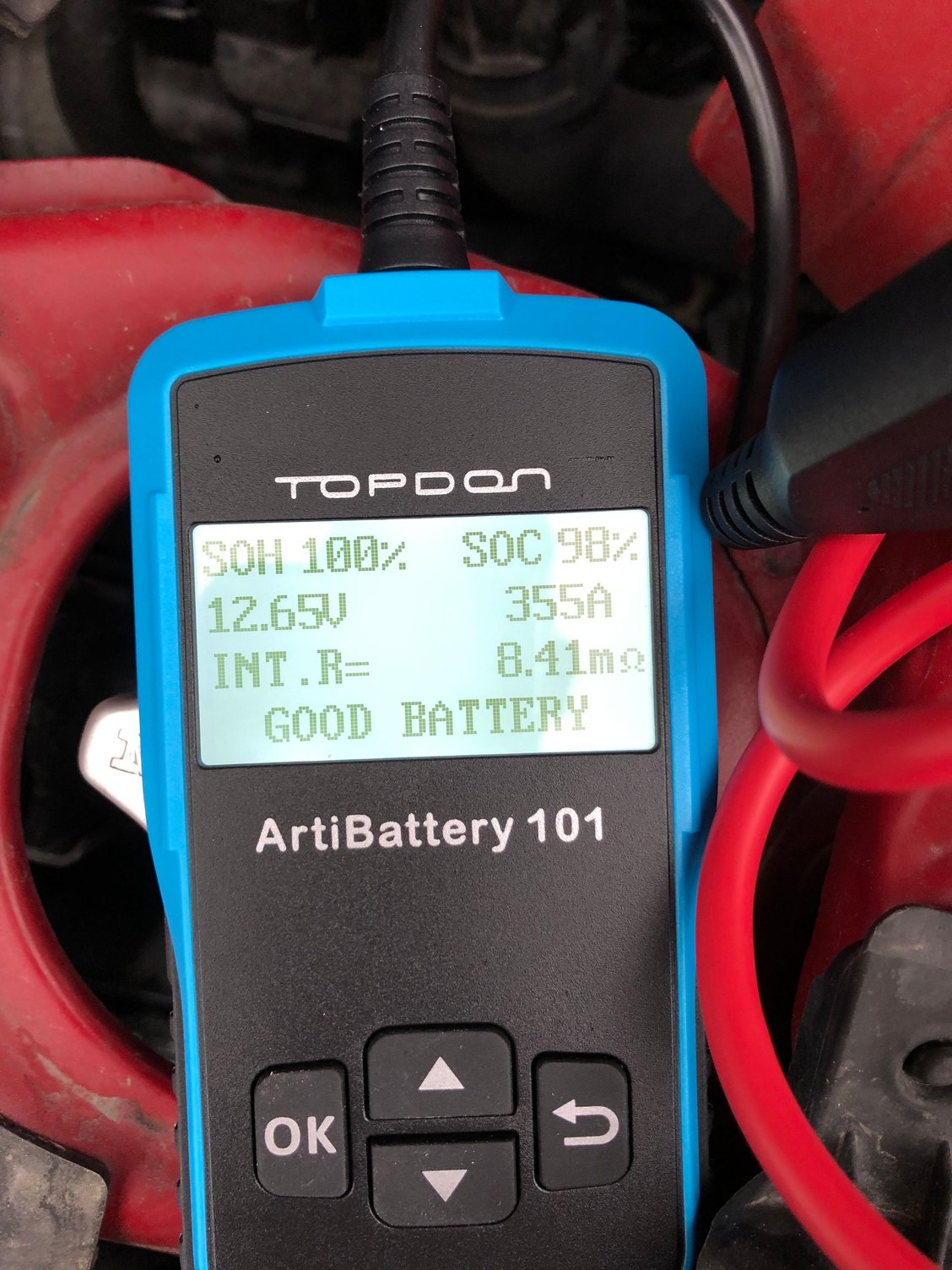

Old Mar 3, 2021 | 04:33 PM
  #92
HondaMan708's Avatar
Joined: Mar 2021
Posts: 1
From: New Jersey
I woke today after cold weather and God help me weeks of snow to find my Fit would not start (yes it was started during these snowy pandemic weeks). Well its from November 2015 and sits outside so yes its time for a new battery. The 151R battery small with a large price mostly around $169. The 51R larger and $79 with more Cold start amps etc. Read people writing here on "Fit Freak" on about enough room etc. Well it 'Fit" like a glove! Happy to have a bigger battery and capacity. Thanks for sharing the information.
Checkout the size difference
Old Mar 3, 2021 | 05:27 PM
  #93
Press Fit's Avatar
Joined: Jul 2015
Posts: 514
From: cascadia
Thanks for the photo and price difference. I put a "51R" label on my battery so I will be sure to remember which battery to substitute when my battery dies.
