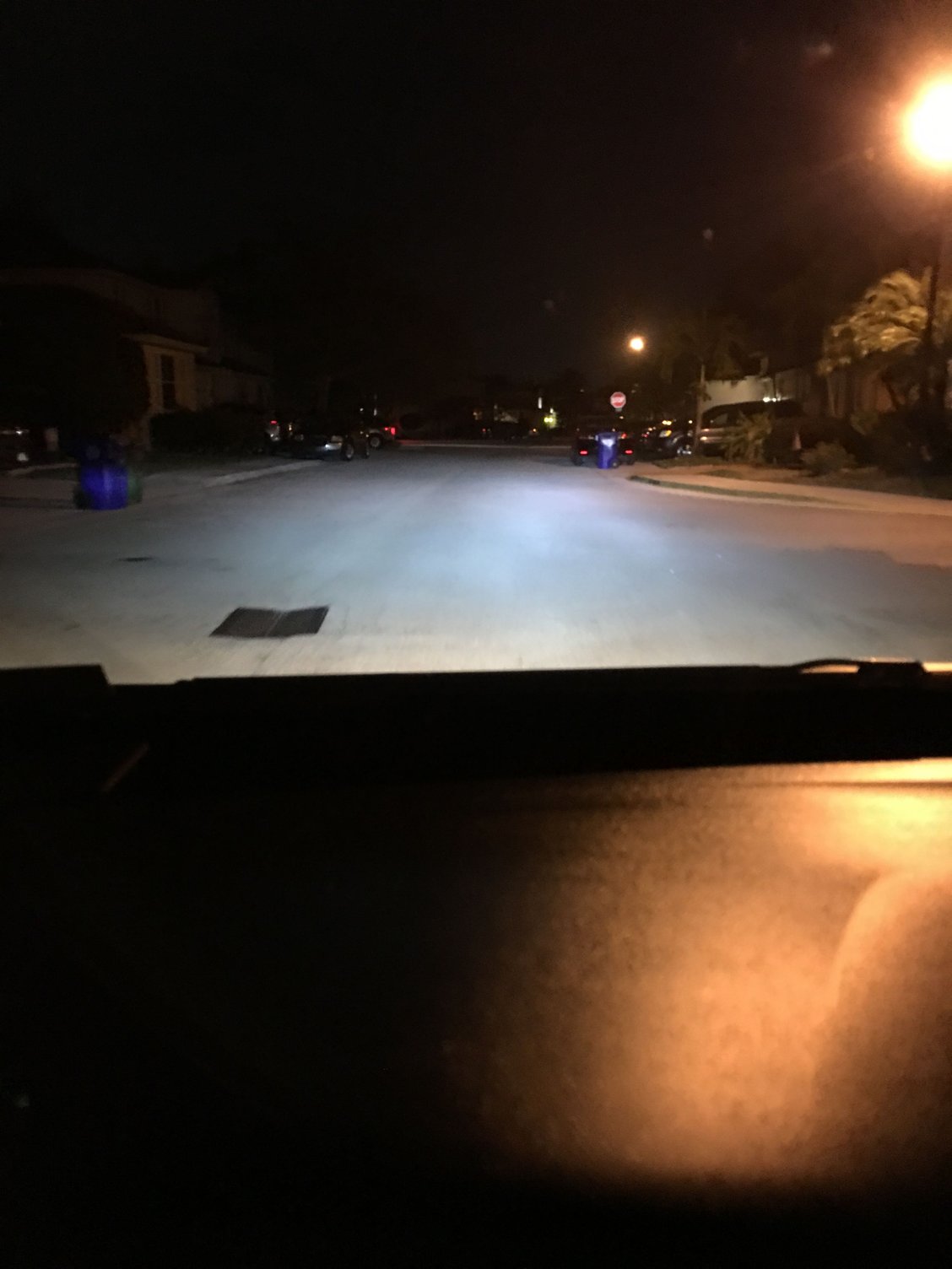

I was convinced the LED that I bought for $90 would work. The light was bright white, but the main projection of the light was too close in front of the car for comfort. If I raise the housing, I would blind everyone on the road. I returned them and got my money back in full. Be careful, not all H4 LED light are the same. Mine had two LEDs on what looked like a circuit board. Onr on top and one on the bottom of the board. Those two chips suppose to simulate the H4 halogen lamp. They do not. I suggest you google and read up on plug and play LED before buying them. I went back to my SYLVANIA 9003/H4 SilverStar Ultra Halogen Headlight Bulb. They were replacement of the low power OEM bulbs.
#54
Did the bulbs have a fixed orientation on the base, or did you try to rotate them on the base to see if that made any difference?
#55
First I installed them incorrectly, the chips were orientated sideways. I was able to rotate the bulb to position the chips up and down. There were no instructions that came with the bulbs. I had to communicate with them by email several times to get things figured out. Even with the correct orientation, the Honda Fit lamp housing did not provide the light projection like the OEM halogen. The bright white light was all over the place. The main aim was too close in front of the road. I sent them several photos of the projection. Even though their policy was a 20% restock, they did not charge me for returning them, but I had to pay $6 to ship them back to Irvine, CA. Like I said, not all H4 LED are created equal. LED bulb is trying to simulate the same projection as halogen bulb. The Fit housing was designed for uniform lighting from halogen bulb. My suggestion is, the more chips that are in the LED bulb, the better it simulates the light coming from a halogen bulb. That is why you see many LED chips in tail lights. Some mfg use organic LED (OLED) that looks like plasma, continuous lighting. OLED is more expensive than LED. The Fit uses LED tail lights, not OLED. You will see both LED and OLED in the more expensive cars.
#57
Sorry, I was so frustrated I dumped them. My suggestion, if you do go with LED, the more chips in the bulb the better it simulates the coil filament in a halogen in projecting light in the Fit's housing. Two chips just won't do it, at least I wasn't satisfied.
