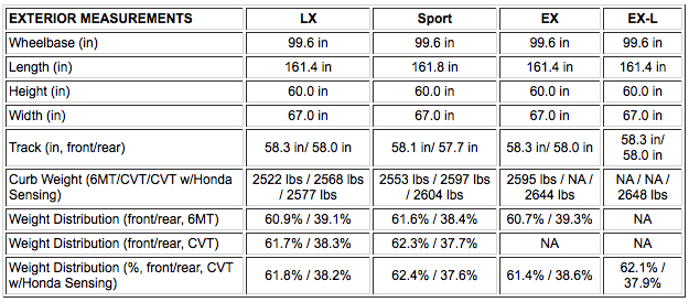

Funny, I was just comparing the specs of my girlfriend's 2018 Fit to my 2008 Civic Coupe. What you're asking about is the "track", the wheelbase is the distance between the front and rear wheels. Yes, there's a difference. The rear track is 0.3" narrower than the front on all models except the Sport. The difference on the Sport is 0.4". Interestingly, both the front and rear track on the Sport is narrower than the other models. Here's a chart:

It's common for front wheels to have a wider 'track' than the rears these days. (Actually, for the past 30 years)
That said, .3" is hardly noticeable!
Go with what 2Rismo2 said in post 3...
