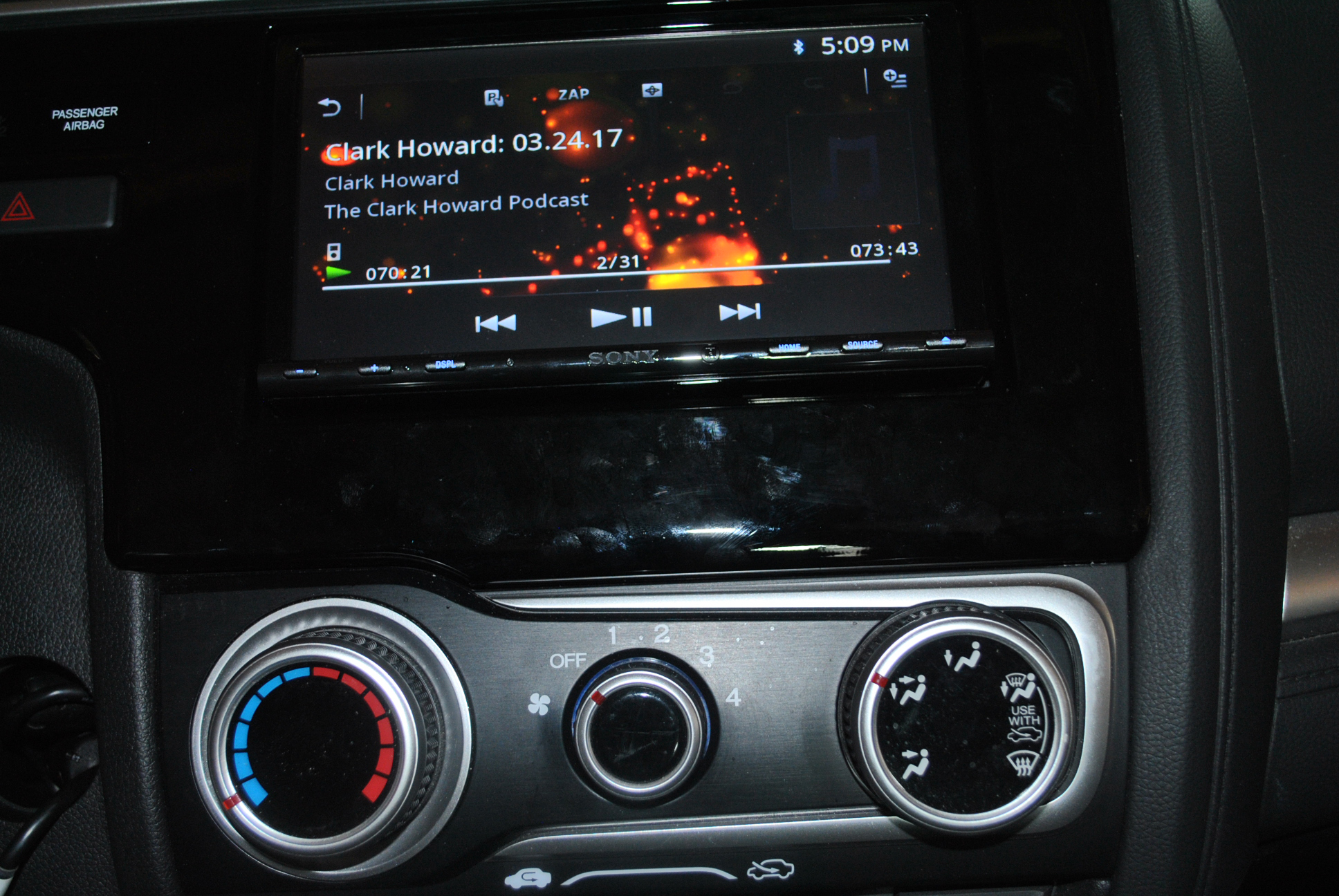

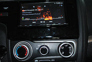

I replaced the stock head unit on my '16 LX with a Sony XAV-712HD aftermarket. Sorry for the crappy night pic, it's the only one I have at the moment. Dash kit was the Metra 99-7883HG:
https://www.qualitymobilevideo.com/99-7883hg.html
I looked into the Axxess adapter for the steering wheel controls and the backup camera. Apparently it wasn't compatible with the Sony. I would have liked to retain the steering wheel controls, but it's not a biggie to operate from the unit or the remote instead.
Didn't have Lanewatch in the first place. Really don't miss the backup camera much. Only thing I found handy about it is backing into tight spaces. Otherwise, just turning my head like I always used to seems to do the trick.
The Sony is so far ahead of the stock head unit as far as sound quality, depth of features, etc., that it's an easy trade-off for me. I upgraded all four speakers first - Hybrid Audio Imagine front, Mirus rear - then the head unit. Each upgrade was a noticeable improvement. The stock head unit just doesn't cut the mustard from a sound quality standpoint.
