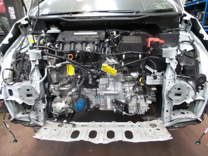

First of all I want to apologize because I accidentally had my question put in the wrong group of questions. My question is Where is “Chack bolt for the level of CVT oil at Honda Fit 2011” but I have asked my question where group for Honda fit of 2015 are.
That is why I want to ask the forum moderator if that question can be placed in the right place
Anyway my Honda Fit looks like this
Ik heb nog fotos van gear box from my Honda Fit model you can see that you nowhere can find middle “check plug” bij mijn Honda Fit I mean I can not find
I hope someone can help me ---- Honda Fit 2011 CVT
Thanks in advance
